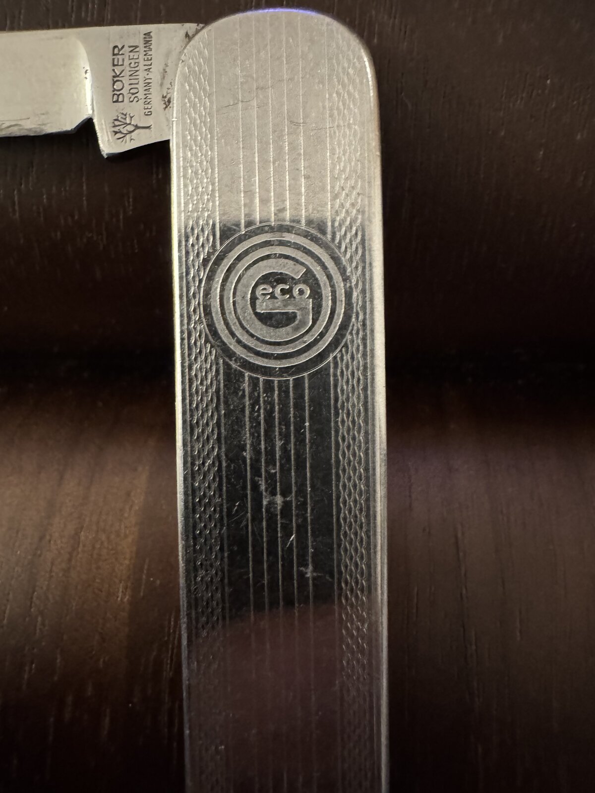

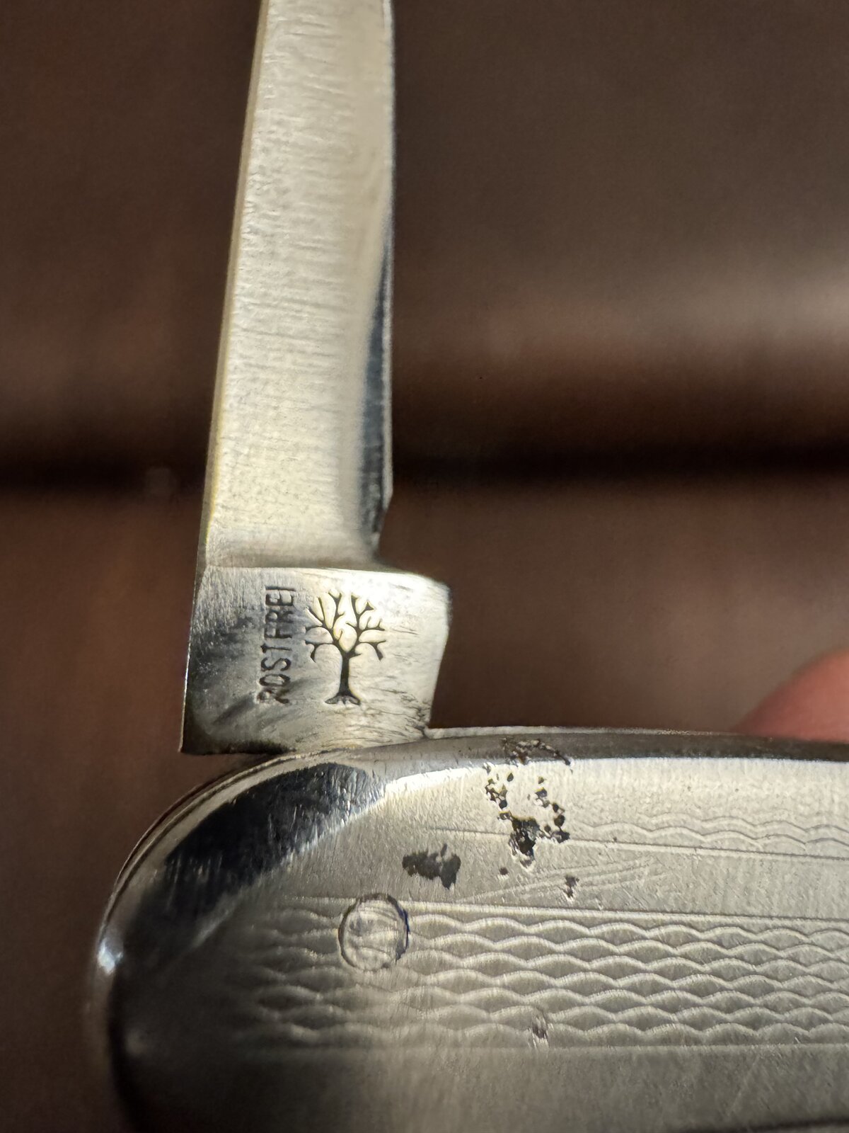

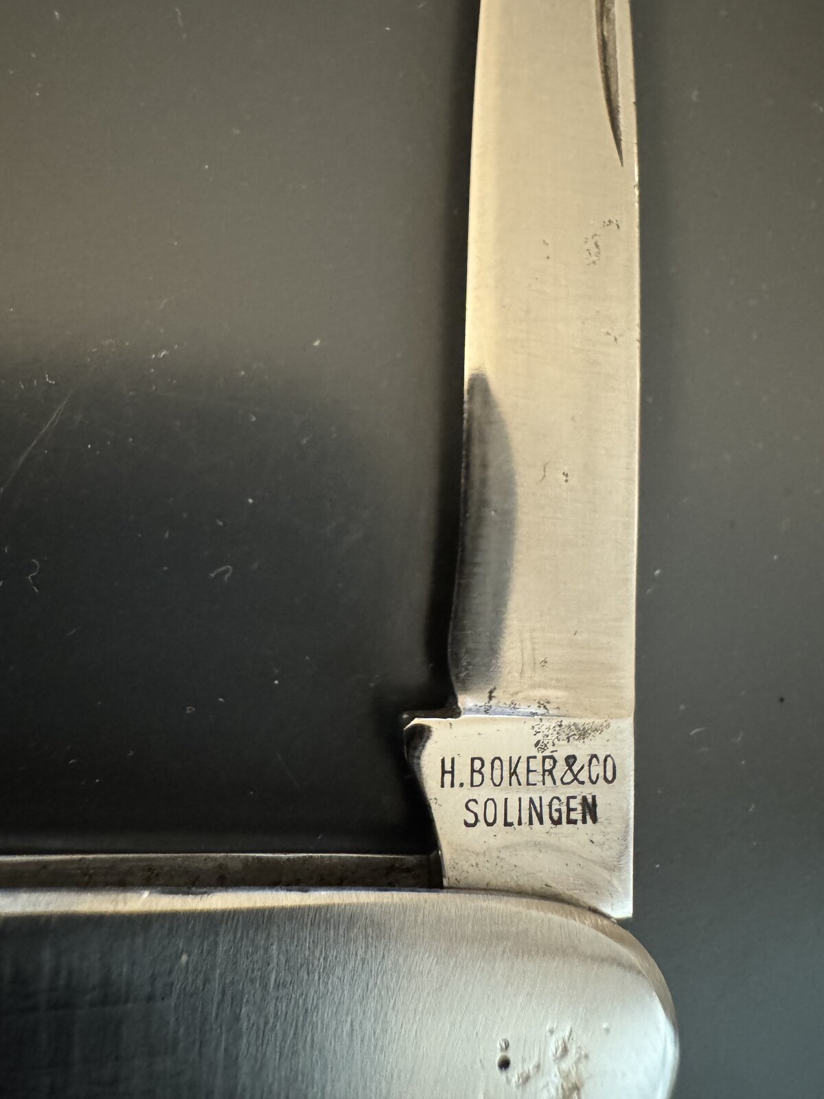

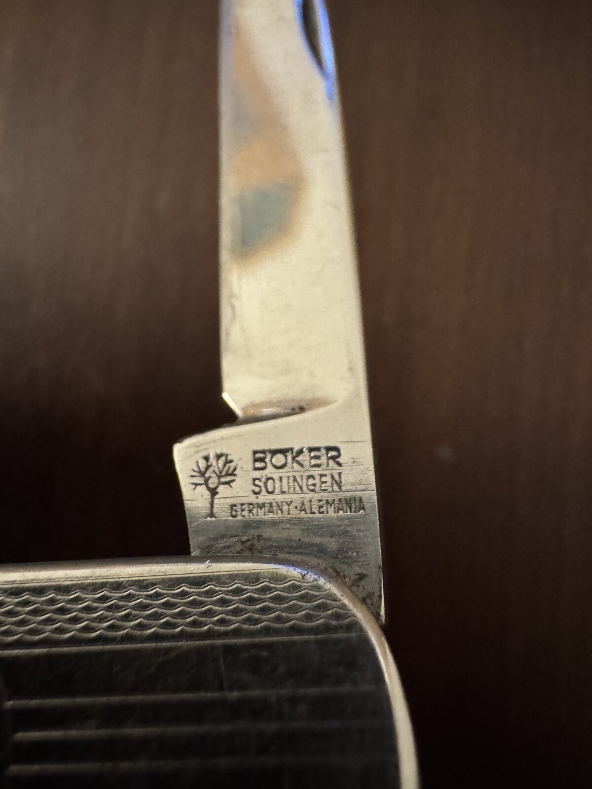

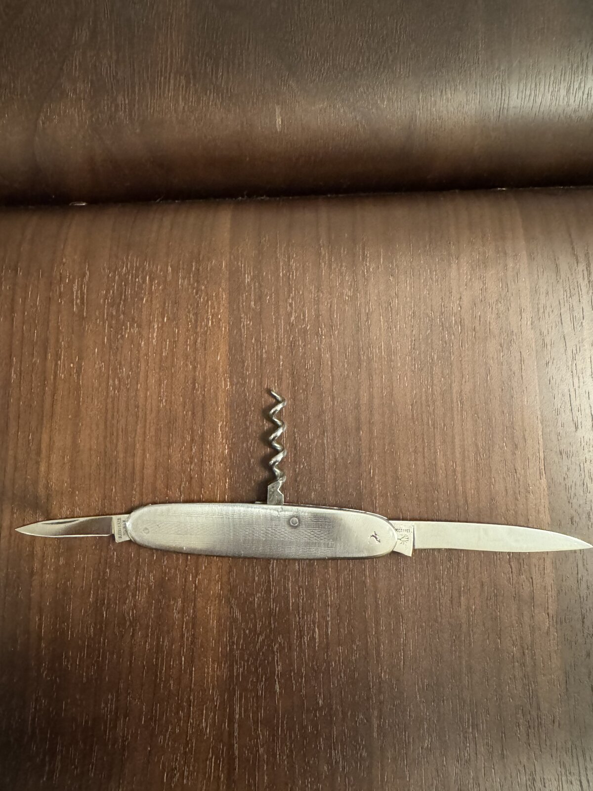

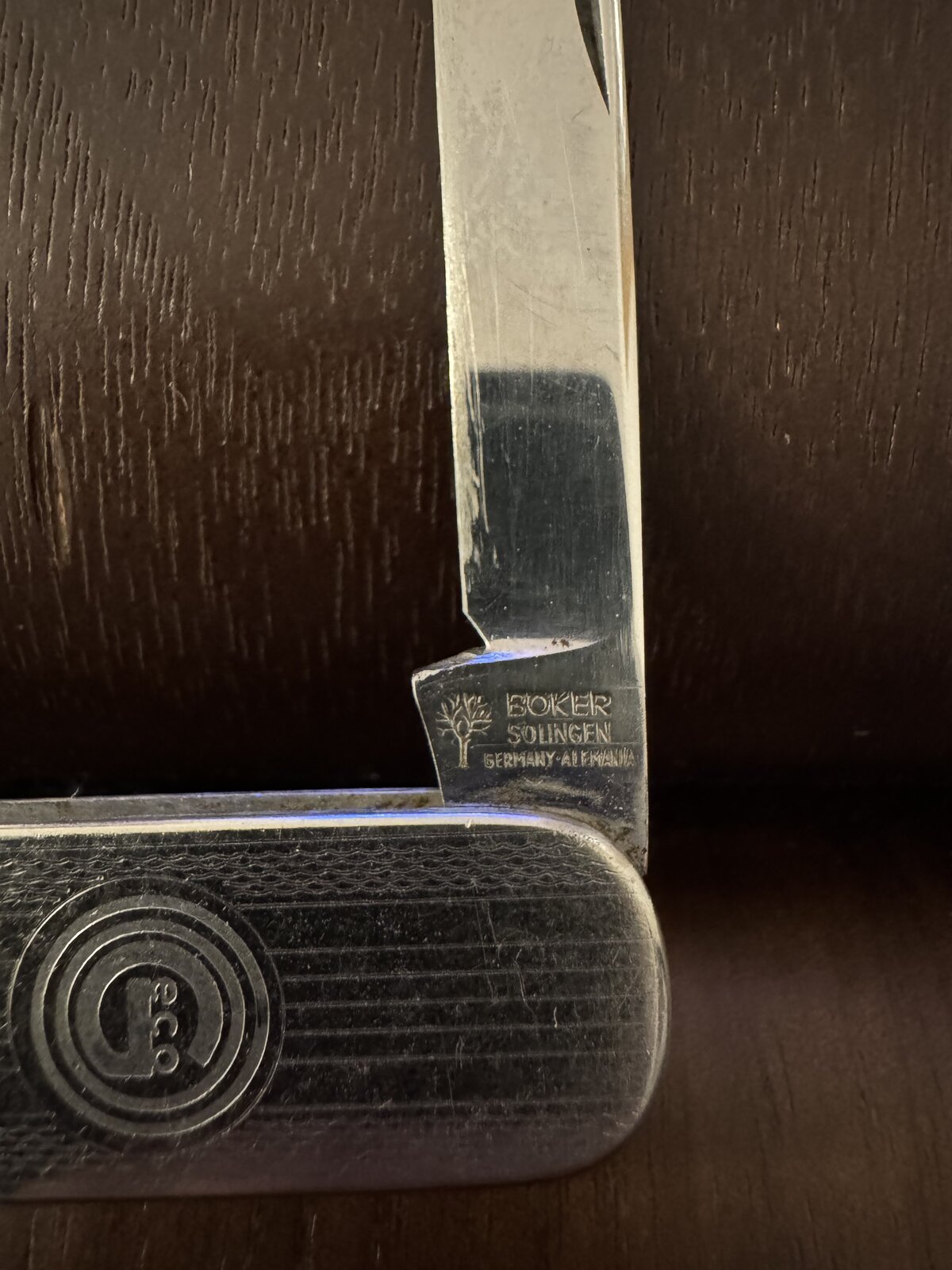

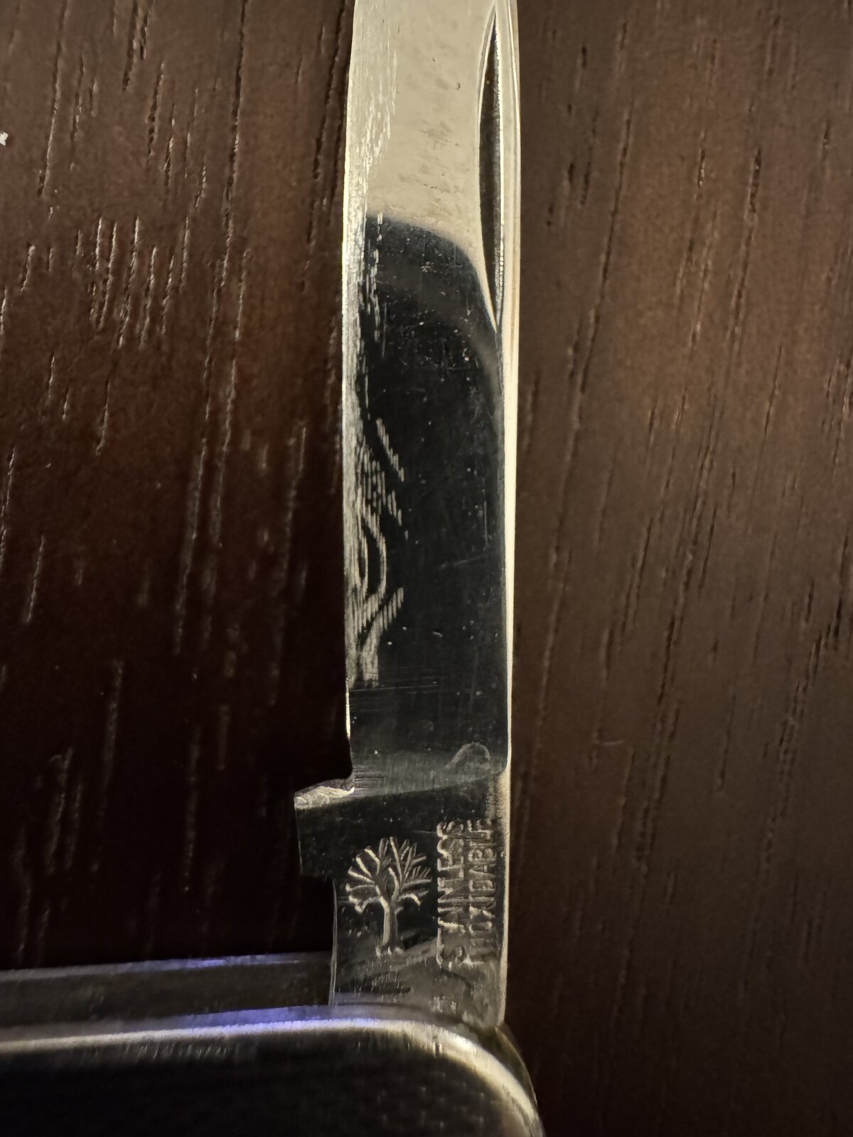

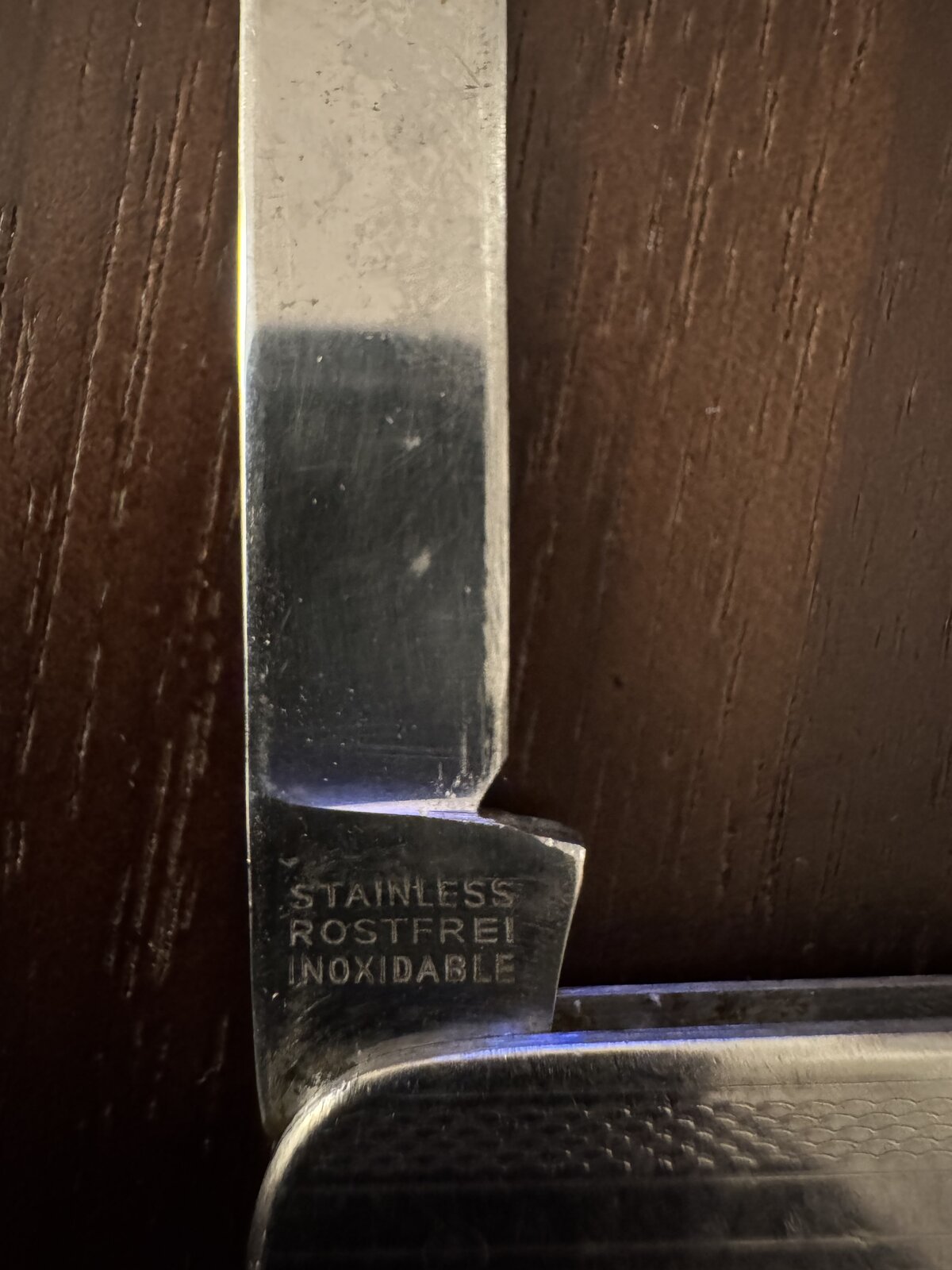

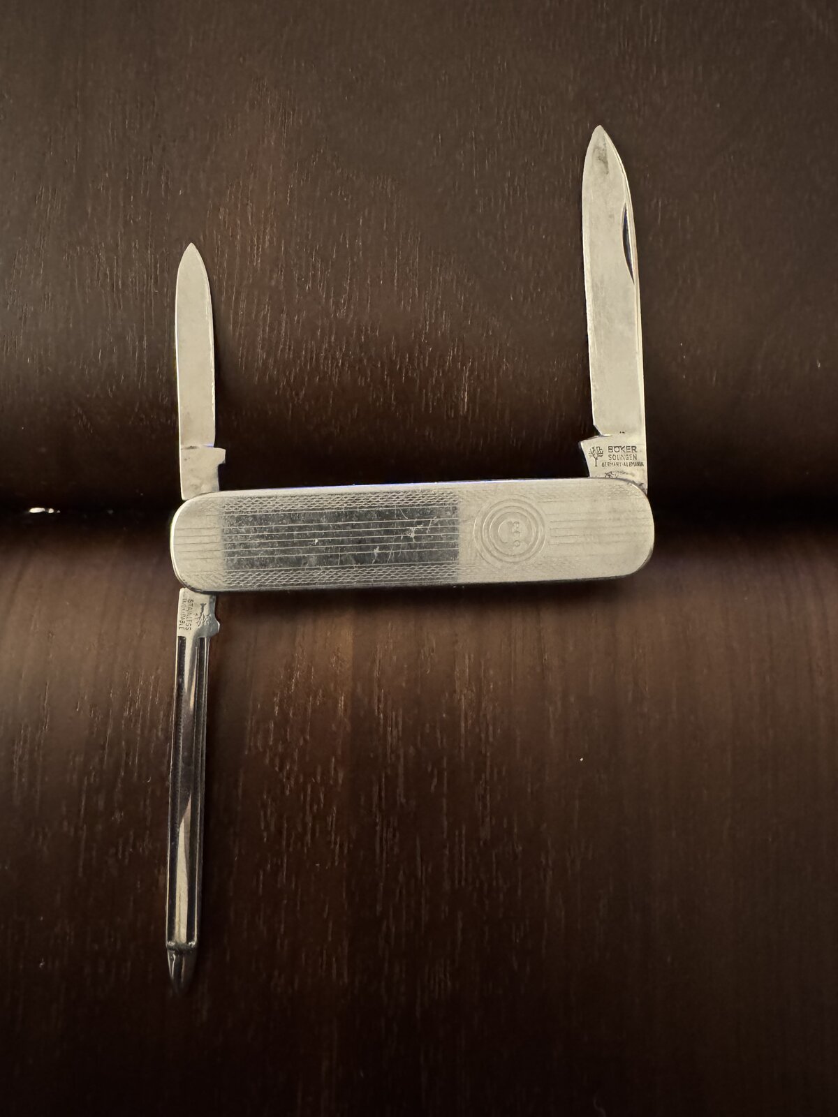

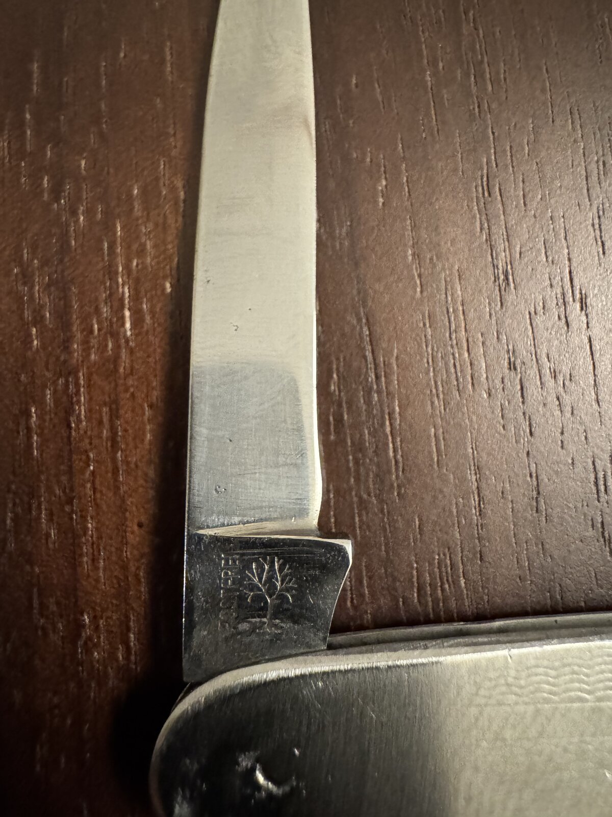

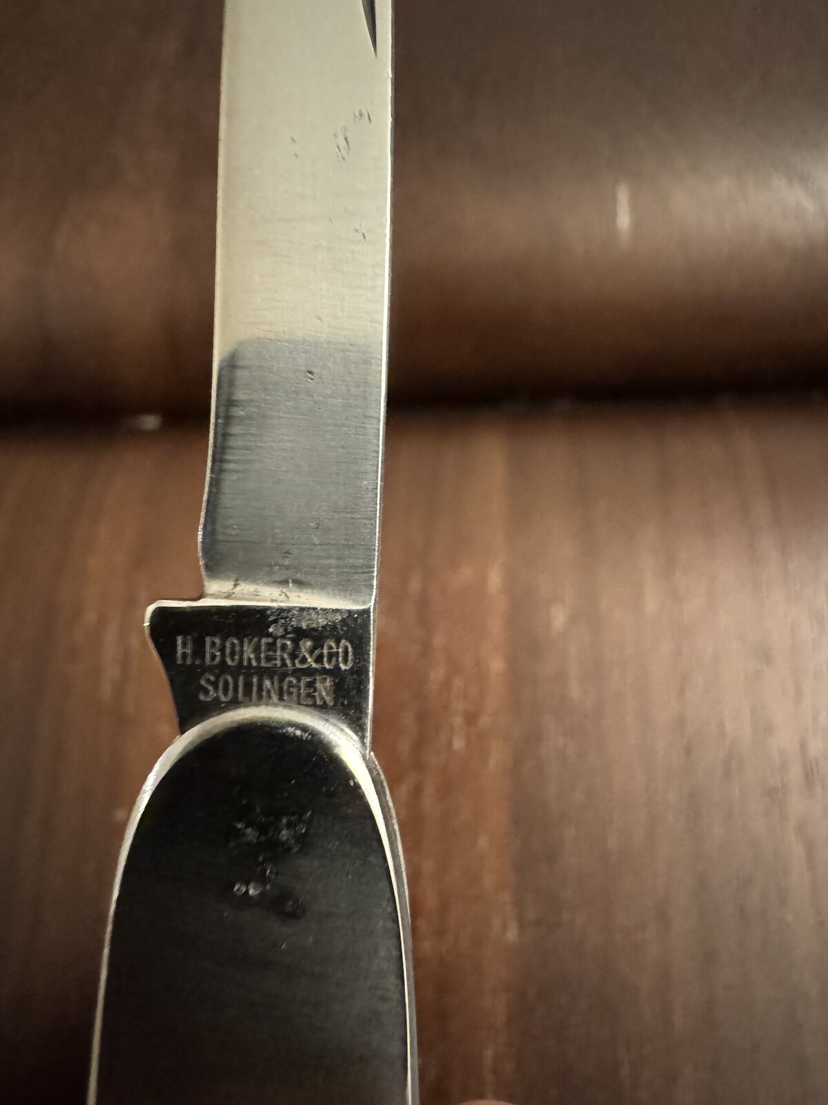

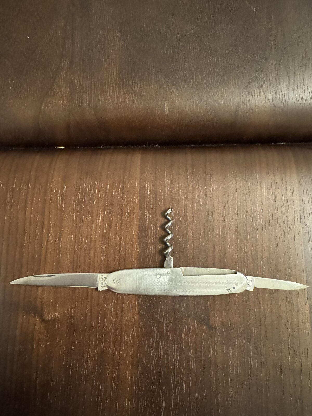

Hi guys. I present to you two steel knives from Boker. Please pay attention to the hallmarks and the brand name, they are written differently. Also on one of them it is written Germany in Spanish Allemania. I can assume that it is an export version for Latin America. I am confused about the hallmarks. According to the information from the official website, one of them was made 1900-1924, and the other 1924-1935. But this is nonsense, because stainless steel has not been invented yet. I'm waiting for your feedback. Sorry for poor quality. Thanx.
Boker (Bro1)
H. Boker & Co (Bro2)

I guess both are dating from the 60s, where those kind of promotion knives were very common. In german called „Herrenmesser“ / Gentleman knives. The stamp which includes „Alemania“ had primarily been used up to the 60s. And was not restricted to exports only. As evidence the mark on the handle is advertisement for GECO ammunition, for more ask Google.

Thanks for the feedback, guys. But look what I found. Boker tang stamps If you follow this table, it turns out that Vet1 was made in 1950-1960, and Vet2 was made in 1920-1930. And yes, stainless steel was already invented. By the way, Vet2 has great steel, it's damn sharp. It stung me when I was taking a photo of it. That's why the photo is not very good quality. I was afraid to stain the carpet 😆
Abu, thank you for Geco, I will definitely check it out. I'll broaden my horizons.

Dear Mr. Сut, thank you for your deep and fundamental answer. After it I conclude that Abu and I were right about the period of production of the knife with the Heinrich Boker (Vet2) mark being 1920-1930. Right?
