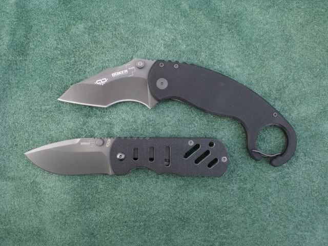

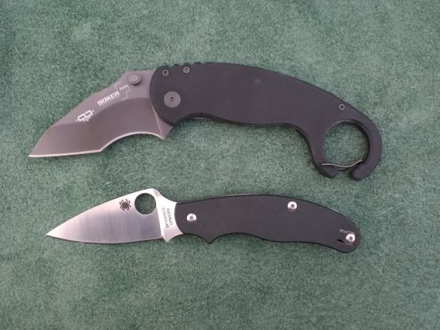

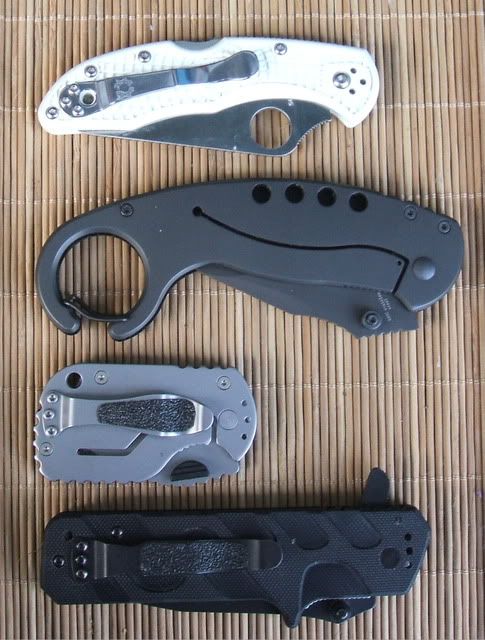

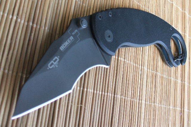

The first surprise when it arrived was the size, it's definitely more Manix than UKPK sized as you can see from the photos (apologies for the finger marks and fluff, but the photos were taken in a bit of a rush)

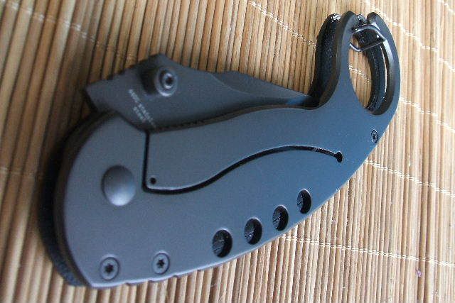

Those who are familiar Chad's medium sized folders (Trance, Hyper or M-Type) will immediately see the similarities in the kerambit - the frame lock, the blade & frame coating of the "titanium" models, the G10 scales, the 440C blade steel and the dual thumbstuds.

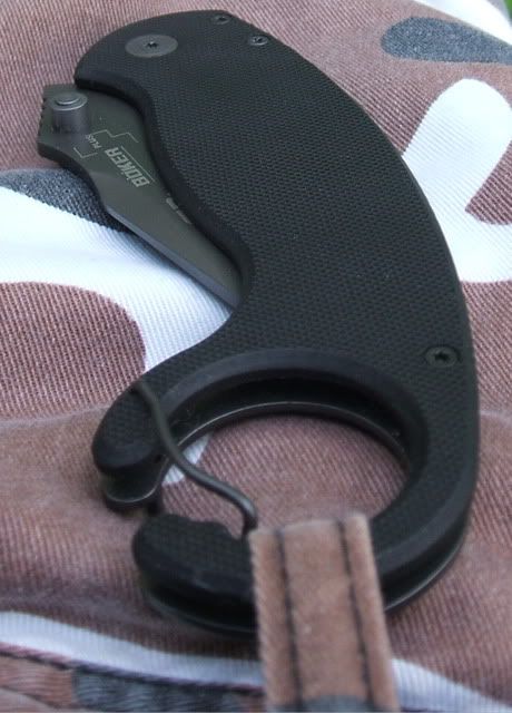

The first obvious feature of the kerambit is the finger ring in the grip which is surprisingly comfortable in a normal grip with the little finger in the hole and the thumb on the striations on the top of the grip / back of the blade. It also works well with the knife "upside down" with the index finger in the hole and the blade at the bottom of the hand.
The carabiner in the ring means that the knife can be carried (where legal etc.) clipped to a belt loop - for me it works best with the G10 side to the body o that the knife can be scooped-up and unclipped as the hand comes up from the side. Note that there is no pocket clip.

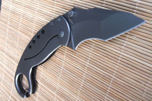

The second striking feature is the blade shape which makes me think that either Batman or a Klingon should be carrying it! However it proves surprisingly effective in normal everyday use - the straight edge is in just the right place and angle (compared to the hand) for neat cutting and slicing, whilst that pronounced recurve is great for cutting through anything freestanding vertically plant stalks, string etc.

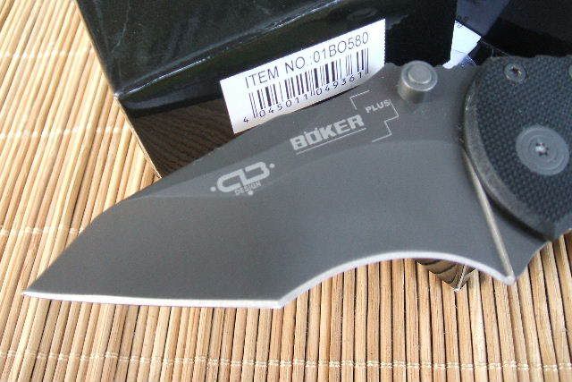

The blade is 440c and was sharp, but not hair-poppingly so out of the box, but a very short time on a Sharpmaker soon changed that.

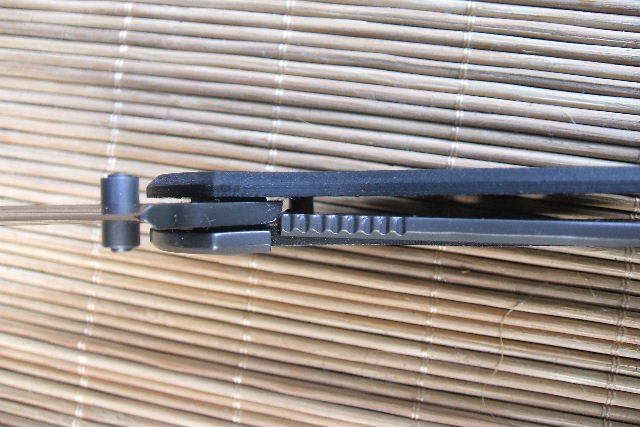

Interestingly in the box was a (very) small allen key to allow the removal of the thumbstuds and an explanatory leaflet which says:
"Not sure regarding one hand openers with a locking mechanism?
Purchase and ownership are still absolutely legal! Carrying of a one hand opener with a locking mechanism is limited in some countries, but there are exceptions making it legal, as well. We deliver the key for flexible and problem-free carrying of your folding knife"
Obviously Spyderco aren't the only knife manufacturer keeping an eye on the changing knife laws worldwide.
Whilst on the subject of the thumbstuds I have to say that with my medium sized hands I can barely open the blade all the way if I have my pinkie finger through the ring - it's just too far of a stretch for my thumb, but with a changed grip with my fingers bunched between the ring and blade then it is possible. This must be the first knife that I've owned on which I think that an Emerson Wave shaped opening feature would be a great idea!
So, to sum-up, this is a well thought-out design that I found surprisingly useful for the bits of everyday cutting that I do around the house, although perhaps just a bit too big for me. If this sort of thing floats your boat then it's good quality bit of kit at a reasonable (cheap?) price. -Stephen "

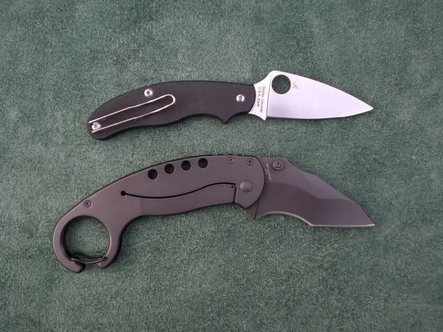

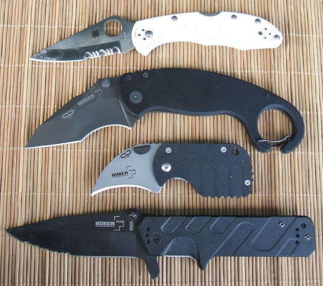

HYPER size comp with Kerambit:

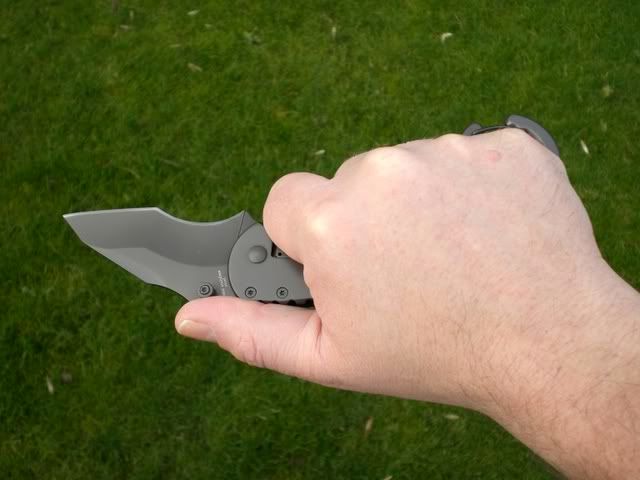

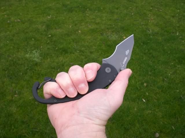

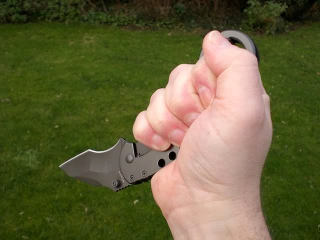

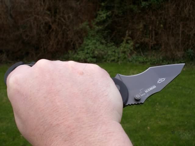

And then some in hand shots he provided:
Stephen63 again emphasized, "The angle of the point is brilliant, when holding it the "normal" way with the pinkie through the ring the point is a natural extension of the thumb..."
