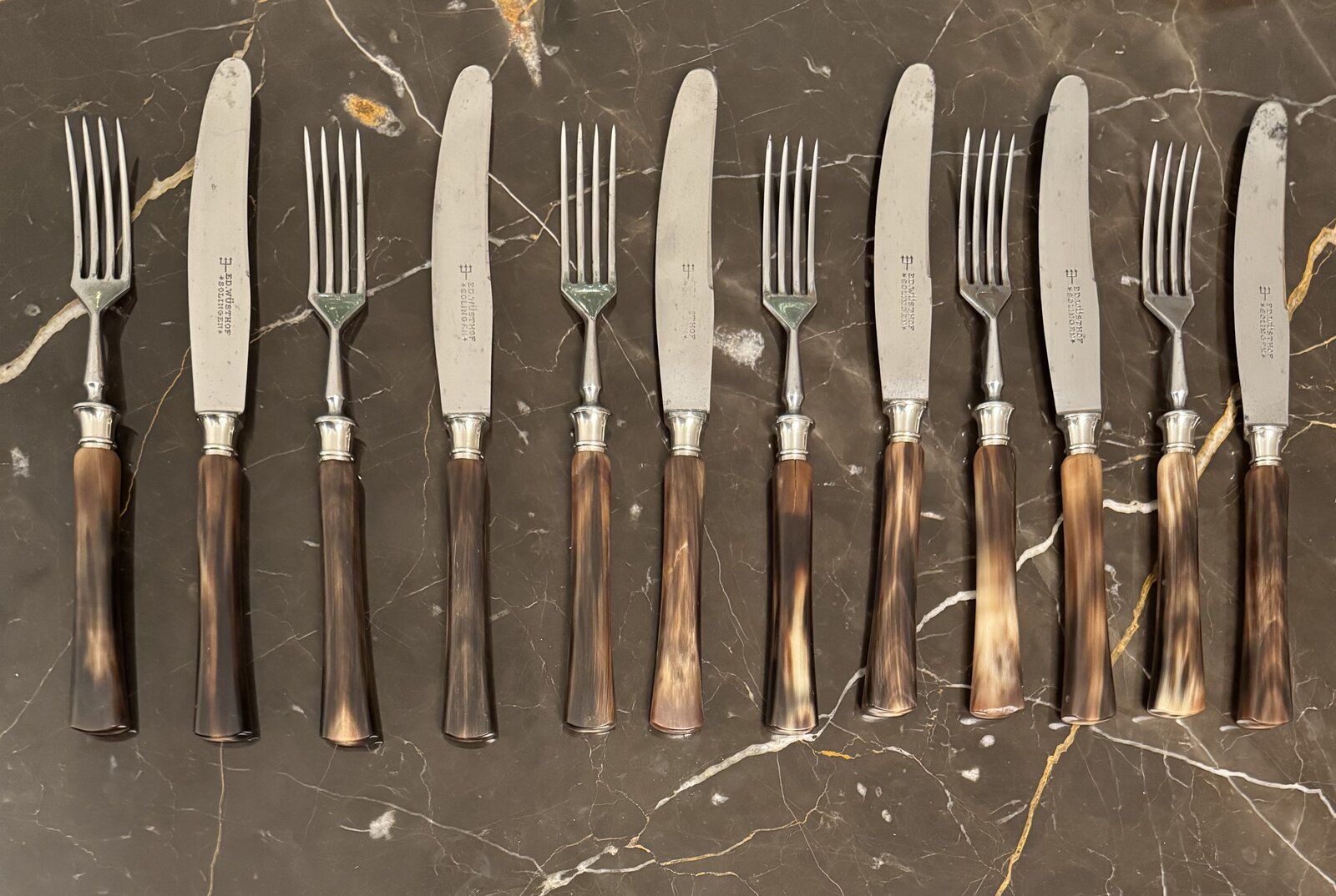

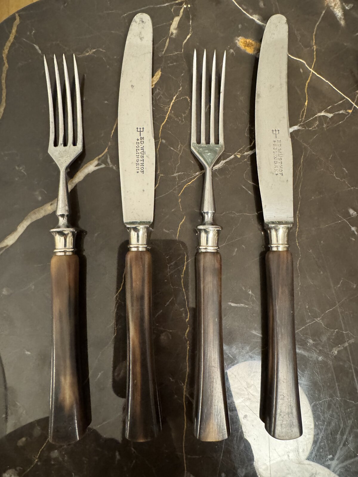

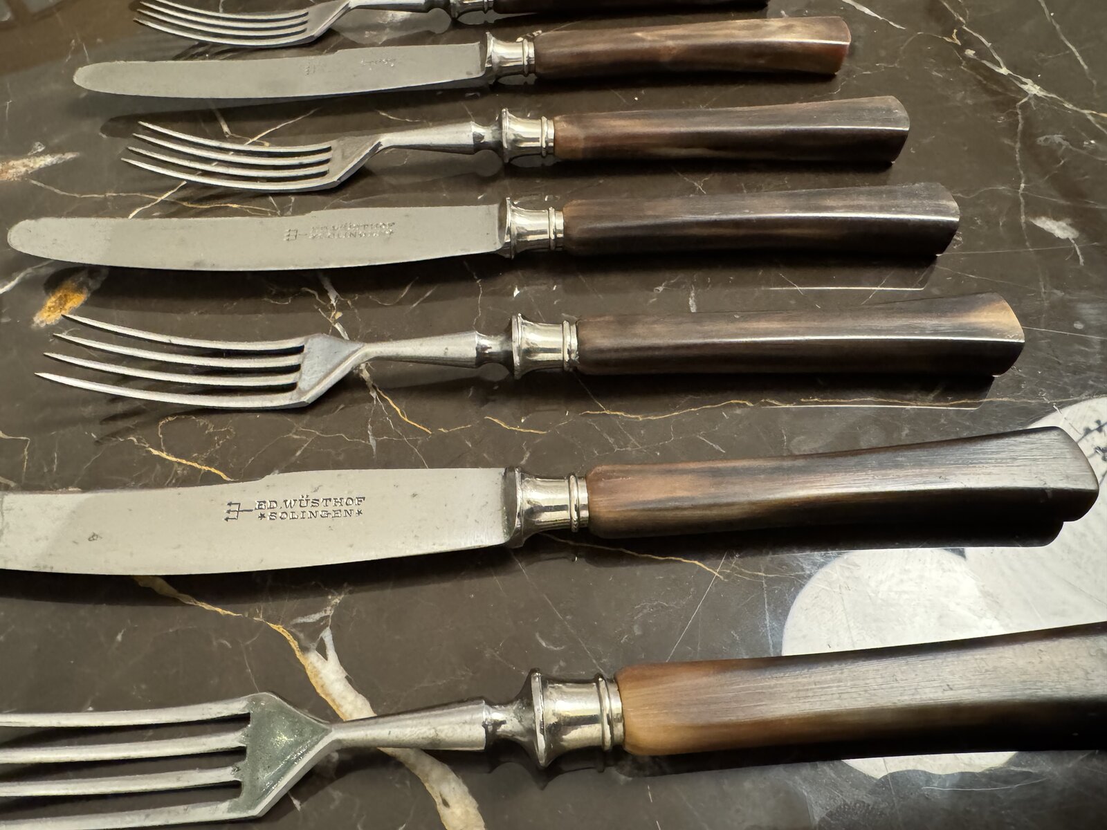

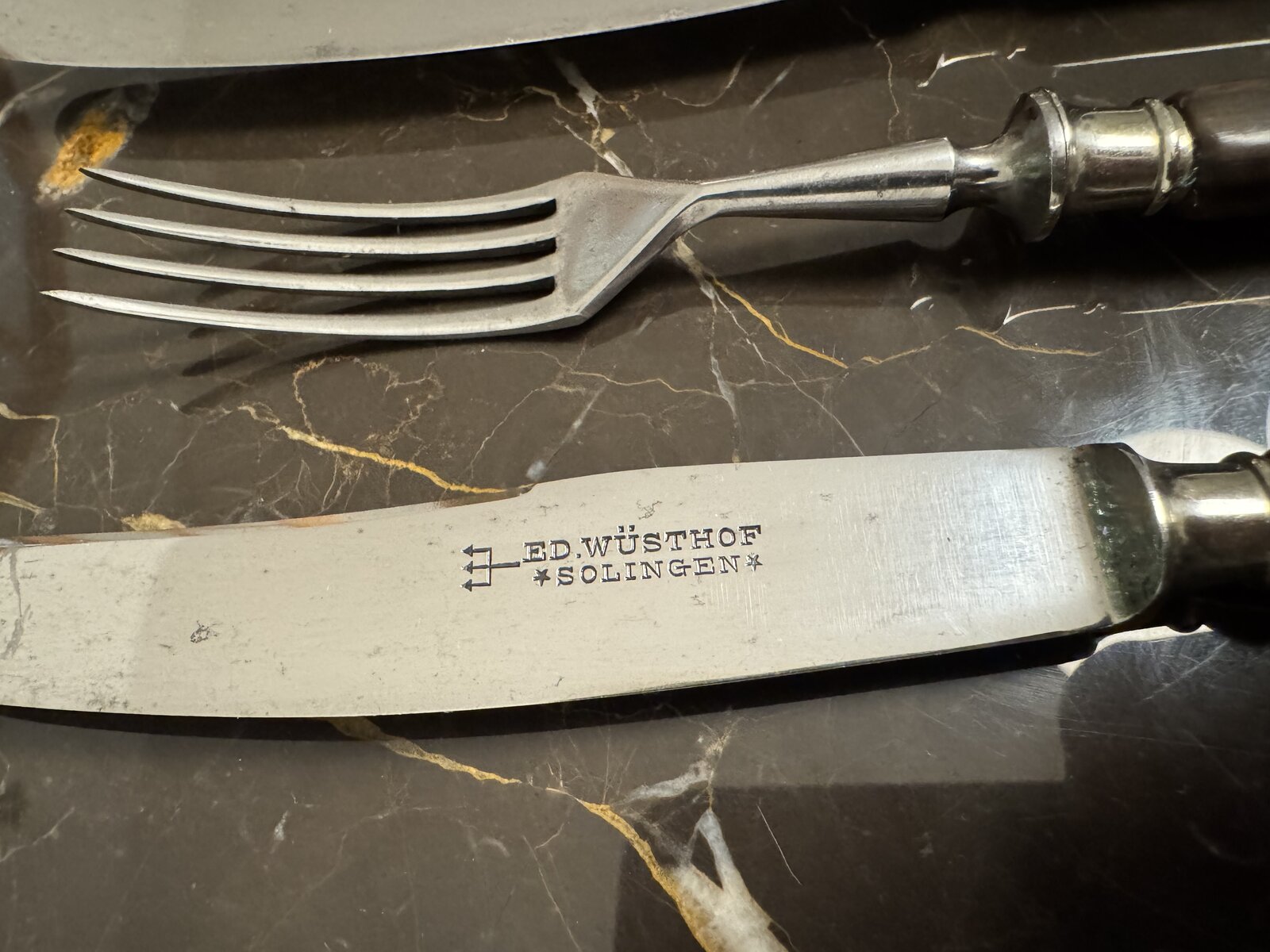

Hello everyone,
my name is Arie and this is my first post in this section.
I have a few questions for you. I recently bought an antique cutlery set made by Ed Wüsthof. Judging by the fact that the set is made of carbon steel, I can conclude that it was made before 1920, that is, before stainless steel was invented. The handles are made of natural horn. Quite a beautiful dessert set. I got into an awkward situation because of it 😅 We had guests and my wife cooked dinner. I insisted that she set the table with these cutlery. The guests started eating, and from their faces, I realized something was wrong with the food. When I tried the food myself, I realized what was wrong. The food reacted with the carbon steel and acquired a disgusting metallic taste 🤢 My guests were well-mannered people and tried to pretend that everything was fine and the food was very tasty so as not to offend the lady of the house. I saw their faces when they ate terrible food and tried to pretend they really liked it 😂 I ordered replacement cutlery and everything returned to normal. My wife was furious 😤 After this incident, I realized what a great discovery stainless steel was. I can imagine how our ancestors suffered. Firstly, carbon steel ruins the taste of food, and secondly, cutlery needs to be cleaned and polished after each contact with food, as it becomes stained and patinaed. My question is, is there any product for carbon steel that prevents it from ruining the taste of food and becoming stained? Otherwise, my purchase is useless. This beautiful antique set will never be used again, and it will simply gather dust in a drawer. Thx

Das problem ist nicht neu und ist grade bei säurehaltigen Lebensmiteln gegeben. Carbonstahl bildet Patina, das ist normal, dadurch wird der Metallgeschmack etwas weniger. Ich habe selber täglich ein Herder Buckels Messer in verwendeung, das ist schon ganz schwarz. Wenn Du hier im Forum nachschaust, ist das verhalten bei allen carbonstahlmessern normal. ICh gehe davon aus, daß Speisen mit hohem säuregehalt serviert wurden. Ein mittel, um den metallgeschmack zu verhindern, ist mir nicht bekannt, nur vorher polieren und nicht in die Spülmaschine geben. Die Messer können sehr scharf geschliffen werden und mit einem wetzstahl scharf gehalten werden.
Jegliche beschichtung müste Lebensmittelecht sein.
Der einzige mir bekannte sinnvolle Weg, die Geschmacksveränderungen zu vermeiden, ist eine stabile Patina auf dem Stahl. Die kommt mit Zeit und viel Benutzung von allein oder kann durch eine Vorpatinierung mit verschiedenen Mitteln beschleunigt werden. Damit ist aber auch unvermeidlich eine Verfärbung des Stahl in Richtung grau und ein mehr oder weniger fleckiges Aussehen verbunden. Blanke Klingen ohne Geschmacksbeeinträchtigungen zu haben wird nicht gehen.

und vielen Dank für euer Feedback. Eure Ratschläge sind mir sehr wichtig. Ich bin zu dem Schluss gekommen, dass ich, wenn ich dieses Set benutzen möchte, die Optik etwas vernachlässigen und es nicht mehr nach jedem Gebrauch polieren muss, bis es vollständig von einer schützenden Patina überzogen ist. Wenn ich es jedes Mal poliere, ist ein unangenehmer metallischer Geschmack unvermeidlich. Der Kontakt mit Lebensmitteln führt zu einer Reaktion im Stahl. Das schöne Aussehen des Bestecks eignet sich also nur für Fotos oder die Aufbewahrung in einer Schublade.
