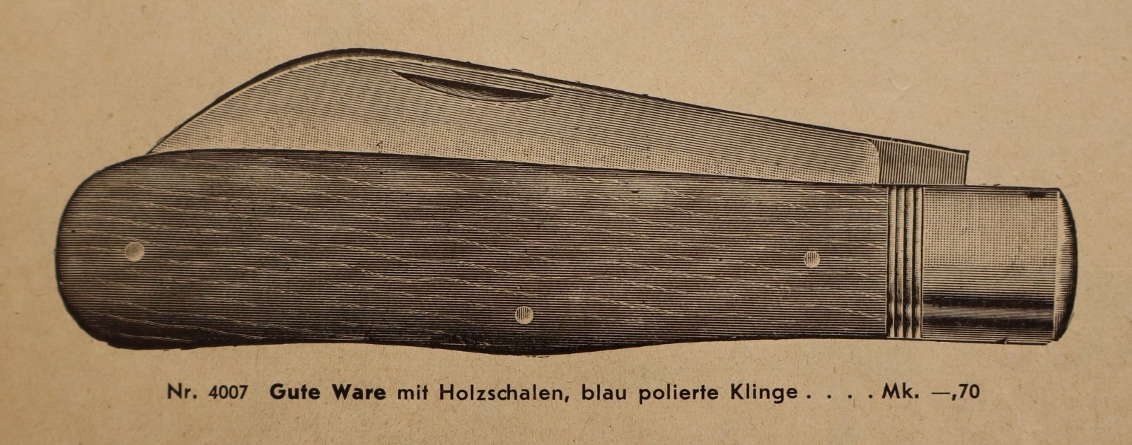

While I don't see the exact model to your knife, this single blade folder from a C.W. Engels catalog dated to 1940 appears very close to the knife shown.
I would suspect your knife dates from the 1930s to 1940s era.
