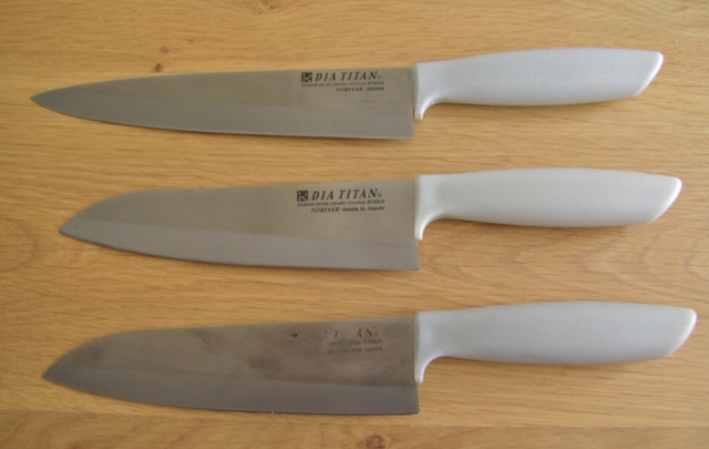

Just before my hodliday i received the package, and in it were several Diamond Titanium knives (as well as some ceramic cutlery items, but this thread is solely about the Diamond Titanium models)

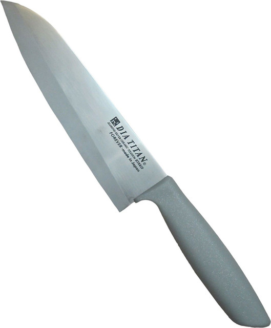

These pics i've taken from the internet:

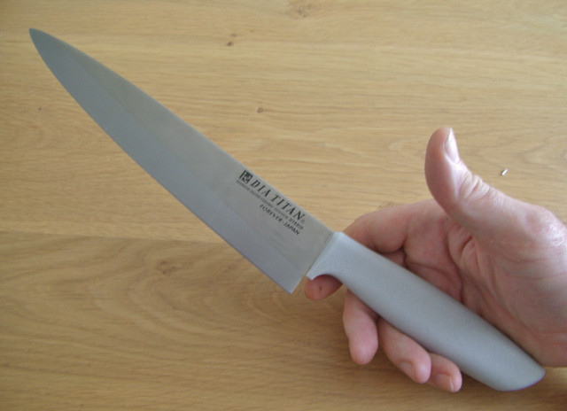

These are the Diamond Titanium knives i received, minus one Chef knife which i already sent through to one of the admins of British knife forum Edgematters.uk, to use as he thinks best.
Soon one of the remaining new models is going to be used for a while by a professional sous-Chef in a busy restaurant kitchen, and his report will be written down later on in this thread.
One santoku is already in use in our own kitchen & i use it for sharpening practice.
The text on the blade is already fading due to handling, but to me that doesn't matter.

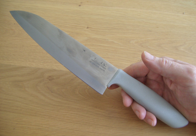

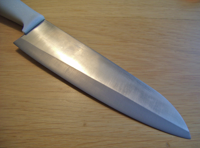

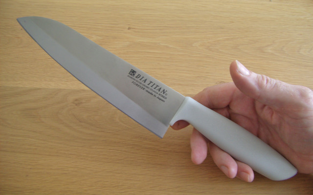

The still new & unused Santoku model:
Specs:
Overall length: 32,1 cm (12.64 inch)
Blade length: 18,7 cm (7.36 inch)
Blade thickness: 1,51 mm
Blade material: titanium alloy (48 HRC) with diamond particles, ceramic particles, and silver.
Handle material: Plastic
Weight: 84 grams

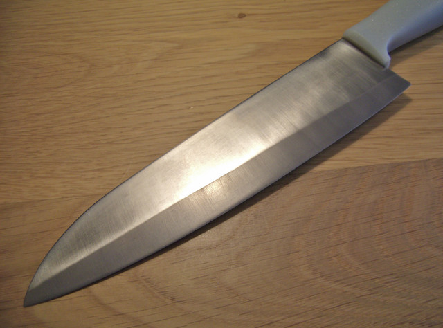

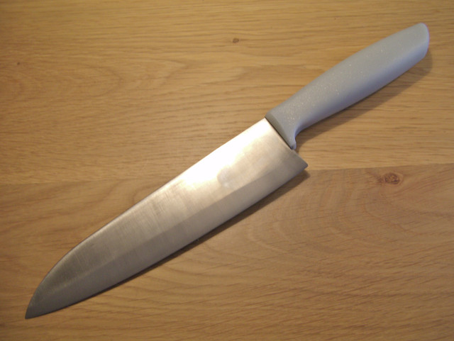

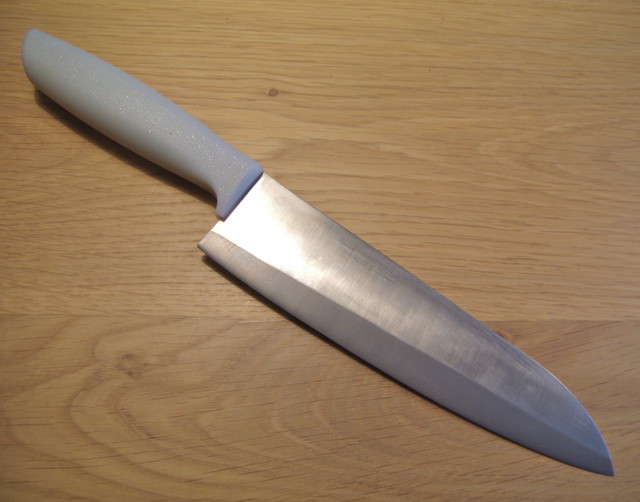

The still new & unused Chef knife:
Specs:
Overall length: 35,0 cm (13.78 inch)
Blade length: 21,5 cm (8.46 inch)
Blade thickness: 1,78 mm
Weight: 94 grams

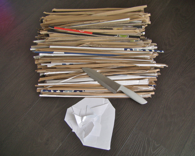

All the work turned out pretty useless in the end: after using the knife just one time on a good wooden cutting board to cut up all the ingredients for a big pasta salad (various onions, bell peppers, garlic & broccoli) the apex sustained damage in some places (seen through the loupe), and i think i saw both microchipping & rolling (not sure)
My guess is that just like it's Cera-Titan counterpart the Dia-Titan alloy & high sharpness polished edges don't go together well, and it probably does better and longer with a less refined edge.
Removing the damage and resharpening to factory sharpness however was quite easily done with a DMT Diafold Fine/Red, and afterwards i did a little cardboard cutting test.

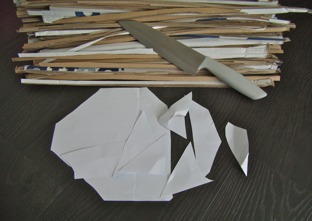

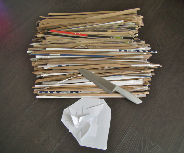

With the new & less refined edge the knife sliced a measured 100 meters or 328 feet of double walled cardboard plus 70 meters or 229 feet of single walled cardboard without tearing, and at that point i ran out of cardboard.
Afterwards when seen through my loupe the edge showed no damage other than a very narrow line of light over it's entire length, and i'm convinced it could have sliced a whole lot more cardboard.
The edge is also still sharp enough to slice copypaper.

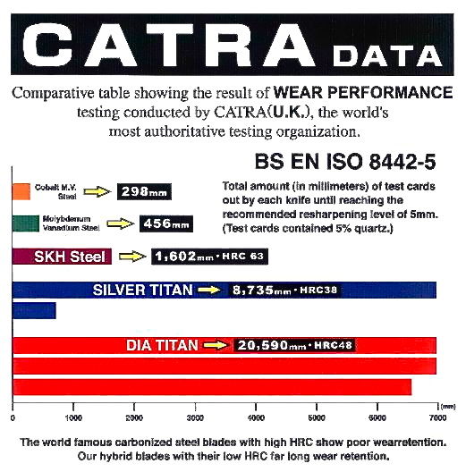

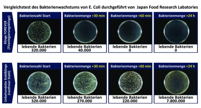

Besides being 100 % rust proof and the edges having a very high wear resistance the blade material also has active anti-bacterial properties due to silver particles in the alloys of both the Diamond Titanium & the Cera Titanium line.
Japan Food Research Laboratories did a test where E-Coli bacteria were put on different blade materials, and then microscopic pictures were taken at various time intervals to see what happened.
I found the pic below on a German website.
The first row shows a Forever titanium blade, and the second row shows a stainless steel one.

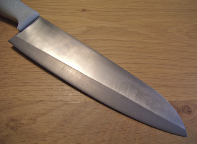

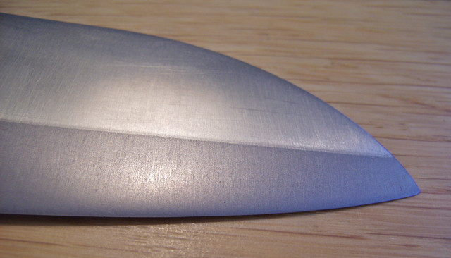

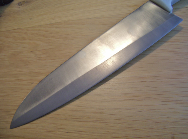

Now at the moment i'm experimenting with regrinding the blade as the factory grind was a bit too thick for my taste, plus i wanted to see if it was at all possible.
The factory edge measured somewhere between 25 and 30 degrees inclusive, with a thickness behind the edge of 0,54 mm.
Now the blade is a very shallow convex with something that resembles a zero edge, and the new apex fits in the 20 degrees inclusive slot of my Tormek WM 200 Angle Master.
Besides the fact that the knife now cuts in an entire different league the edge so far seems to hold up in both my kitchen use as well as in cutting quite a bit of cardboard without it folding over or chipping.

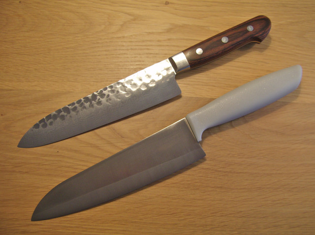

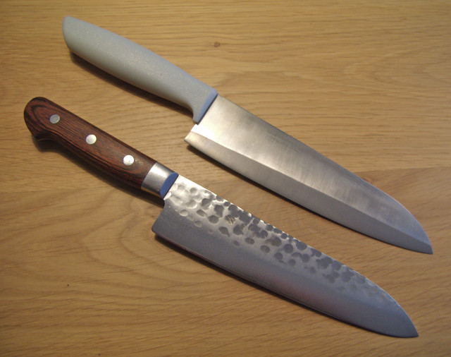

These first two pics show Patrick's own Sakai Takayuki santoku in cladded VG10 steel together with the reground diamond titanium santoku.
Patricks knife has already been resharpened again in the pics since he needed it back asap, as it is his main workhorse (bought new over 5 years ago)
I've sharpened this knife many times already and find the VG10 very well heat treated, imo comparable to Tojiro's.

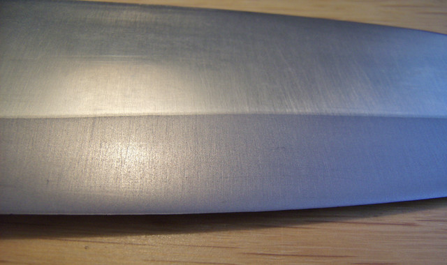

All pics show the Diamond Titanium knife just as i received it from Patrick, only cleaned with a soft toothbrush and some mild detergent, but not resharpened yet.
The Diamond Titanium knife does indeed still cut better than Patrick's Sakai Takayuki, but that is mostly because of the thinner blade coupled with the thinner edge angle (20 degrees inclusive versus 25 degrees inclusive)
Where the used edge on the Sakai Takayuki was nearly worn smooth, the used edge on the diamond titanium blade has become coarser and it's apex has widened.
The remaining sharpness is such that with a little effort it will still slice a piece of copy paper, but it snags a bit here and there on a few microchips (these are visible in the pics).
Patrick's santoku could not slice the same copy paper, no matter how i tried.

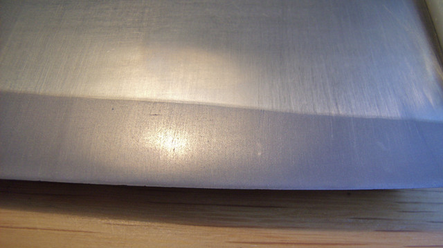

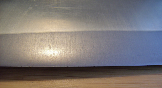

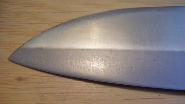

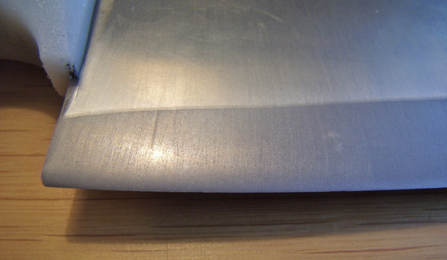

When seen through my Victorinox loupe using daylight the entire apex of the diamond titanium knife looks a bit rough, and this has the effect of micro or even nano serrations.
Thickness behind the current edge (measured about a millimeter behind the actual apex) hovers between 0.25 and 0.3 mm.

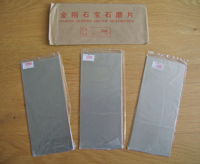

I chose to resharpen the edge freehand using a few cheap Chinese diamond plates that i got from E-Bay for under 10 Euro's (about 12 US dollars) including shipping costs from China to the Netherlands.
Grit 1200 / 2000 / 3000, each one measuring 17 cm x 7.5 cm x 0.99 mm
I found that using just the 3000 grit diamond plate would have taken too long to get the microchips out, so i exchanged it for the 2000 grit plate for the majority of the work and then refined the edge with the 3000 grit plate.
Total sharpening time was about half an hour to 40 minutes, but i took my time, used light strokes, and washed the plates in between with some detergent & an old soft toothbrush.
So far i haven't noticed that sharpening the blade edge leading using just these 2 fine diamond plates produces any kind of burr (or it's just too small to notice it), like it did when i reground the blade on 240 and 400 grit SiC wet & dry and WD40 as a lubricant.
The new edge can slice-shave the hair on the back of my hand fairly well, and the edge angle has increased from 20 degrees inclusive to between 22.5 and 25 degrees inclusive with a small, but visible bevel.
The knife will now be put away until Patrick drops by again.

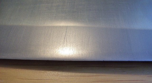

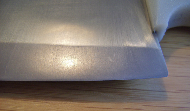

NB: the edge of the Diamond Titanium knife made visible scratches on both the grit 2000 and the grit 3000 diamond plates during sharpening.
These scratches are very superficial, but they are definitely there to stay.
