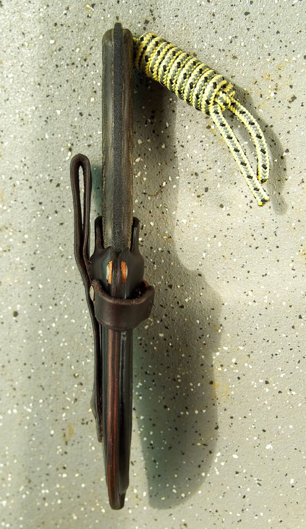

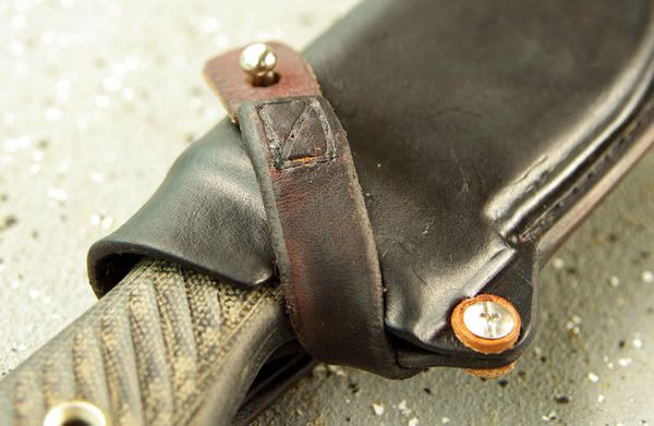

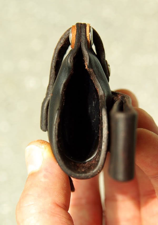

Extra Heavy Duty Kydex en Leather for Swamprat Howling Rat LM
Mein Deutsch is nicht so gut, deswegen in English.. Danke für ihre verständnis..

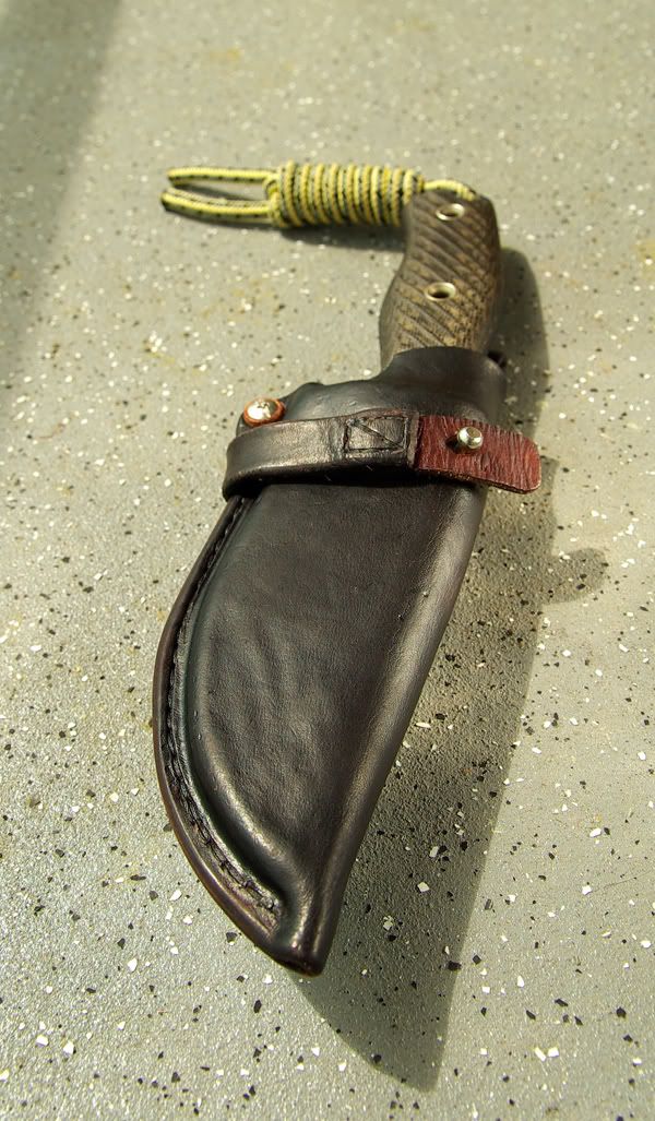

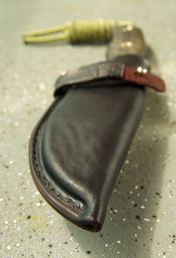

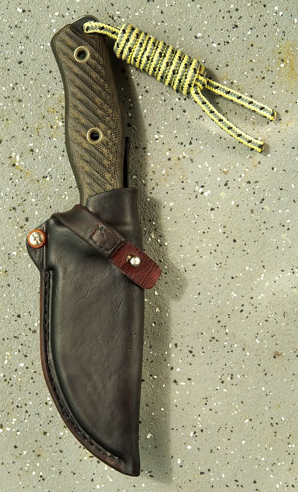

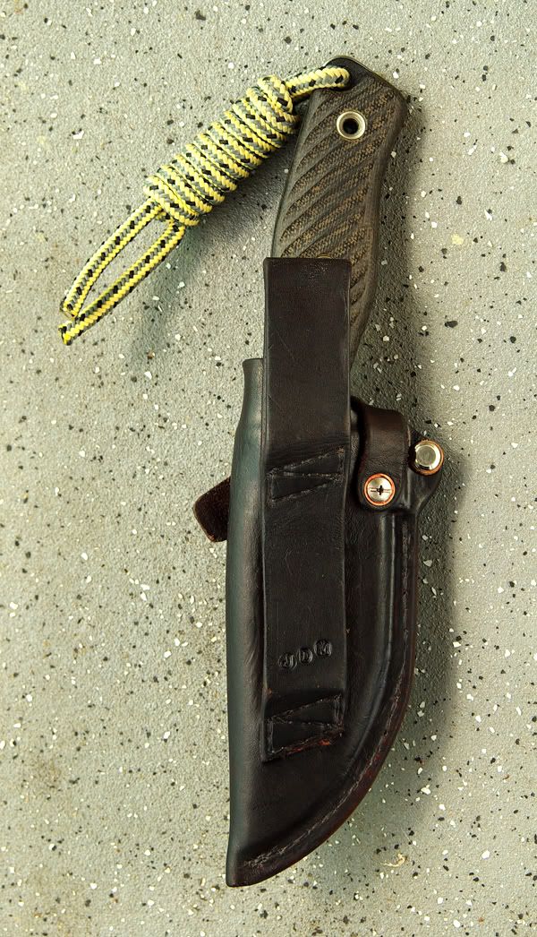

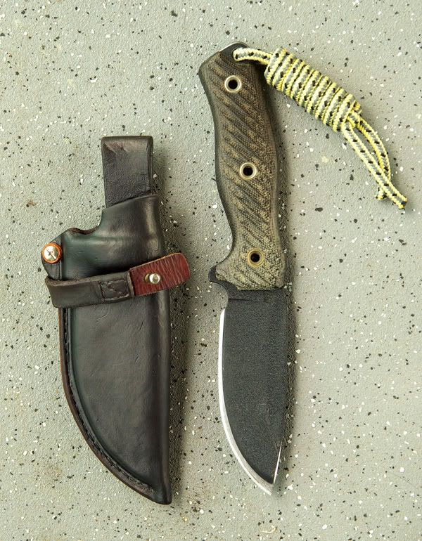

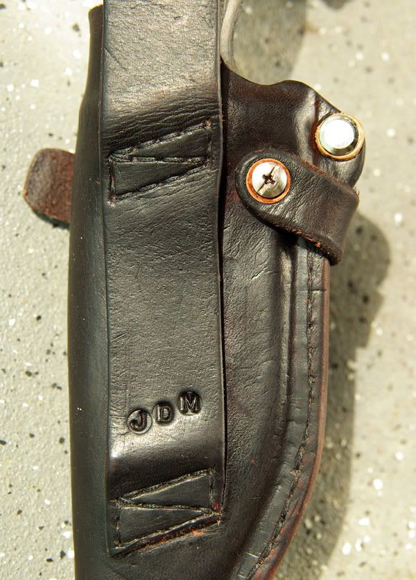

My mission was to improve some stuff that I was not 100% happy about on my Ratweiler Sheath ( http://www.bladeforums.com/forums/showthread.php?t=553532). And to see if I was capable of doing that kind of sheath again.
Improvements:
• Retentionstrap has got a hole of very tough lappleather, which is more resistant to wearing out, and will last longer.
• Retentionstrap is easier to attach to the riflebutton.
• Screws are inserted during wetmolding, so the screws are sunken into the leather and there´s no space between leather and kydex.
For the rest it is the same as the Ratweiler sheath.. It’s very comfortable to use..
Hope you enjoy the pics..
Have a nice Day!!
martin
