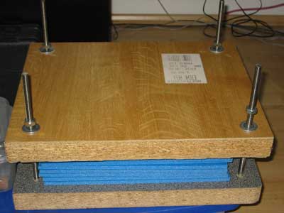

El
Gunting Speedholster & Speed-clamp @ Pressure-board
My "press" is very simple. 2 boards with 4 layers of foam glued to each of them. I also stand on it, but i guess 75 kg sometimes is not enough.
Works better when my cousin (120 kg) is standing on it... :D
Another one and still too slow and uncomfortable.
I am looking for a kind of old bookpress or gonna build something around an old jack.

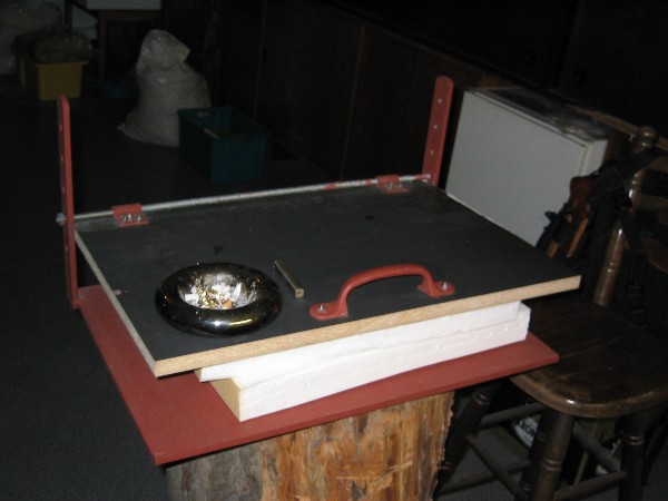

hi,
this is my selfmade heavy duty kydex press :D
gruß
Arne
