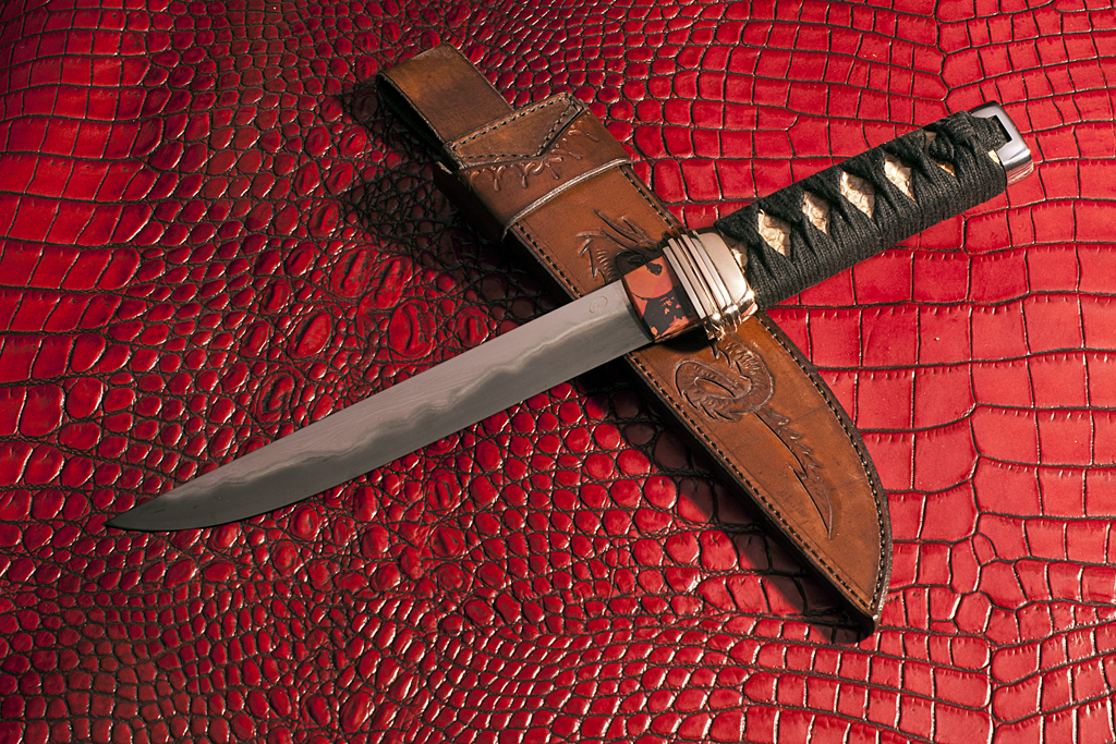

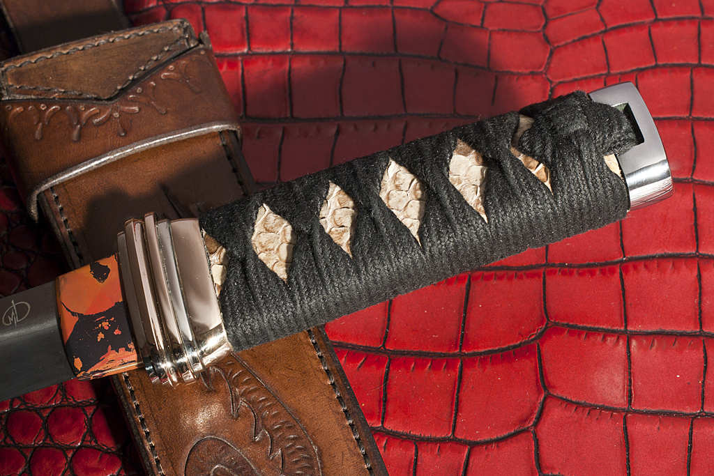

Hi,
this is one of my knives for Sindelfingen show.
I hope you like it
Thanks
Denis

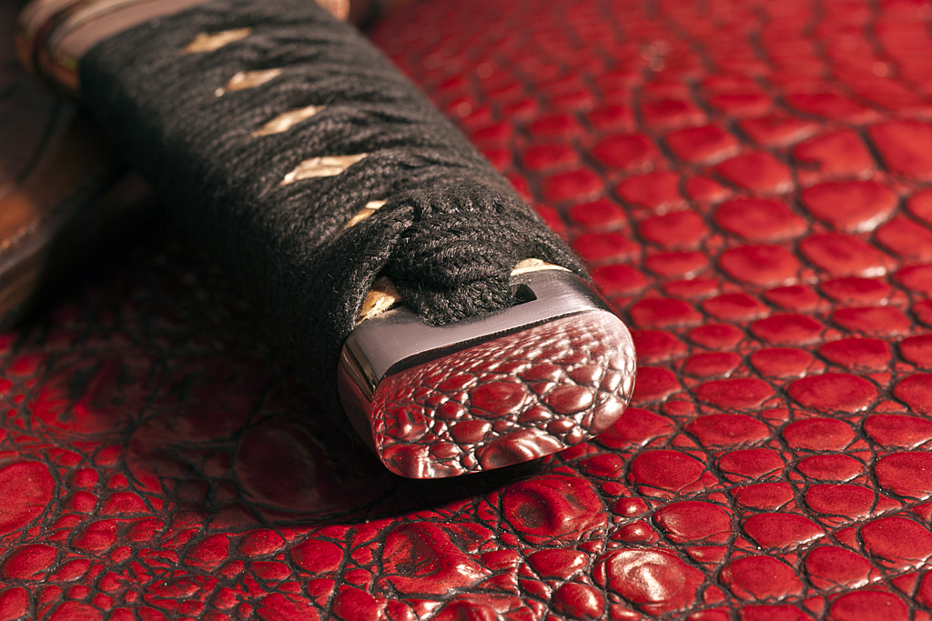

Steel sanmai, (O2 and 416 external).
Copper abaki, brass tzuka and nikel seppa. Butt cap 416. Handle snake skin.

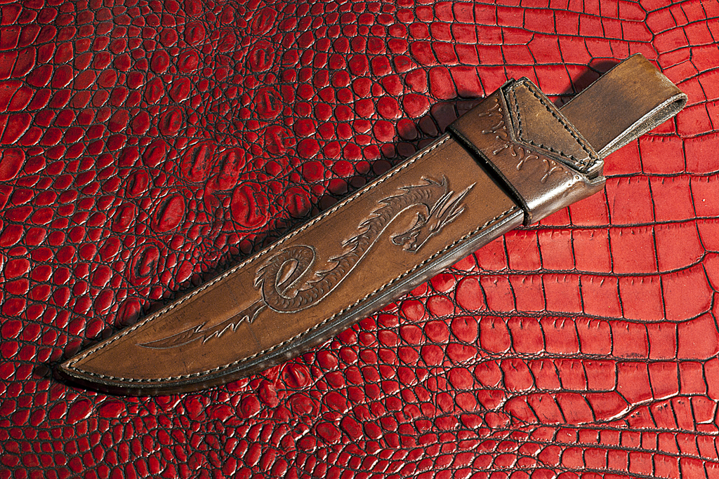

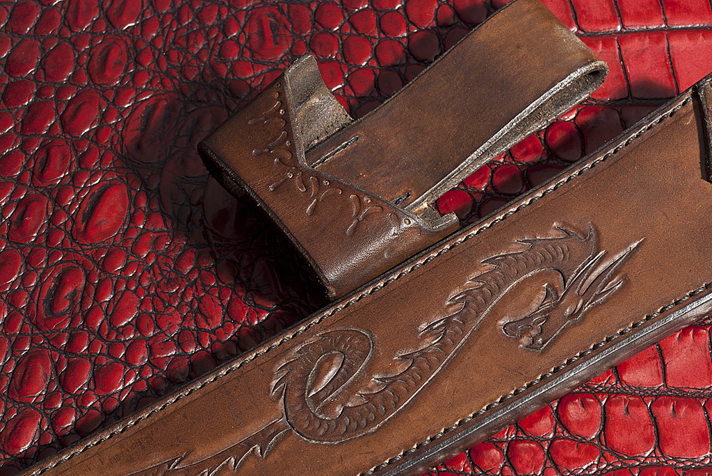

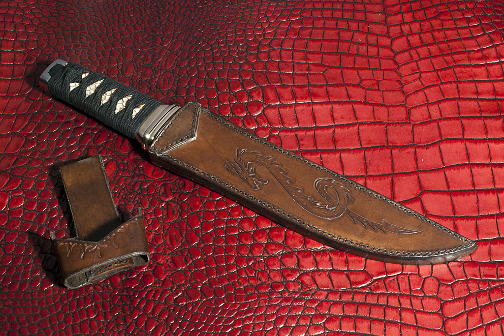

Sheath for left and right by Kiara

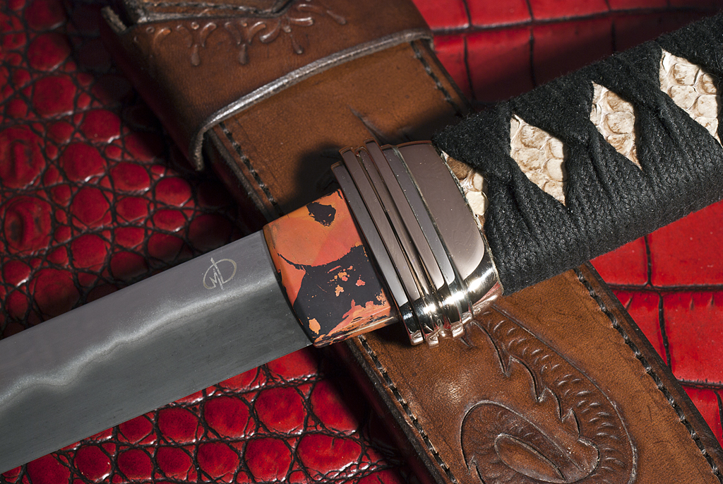

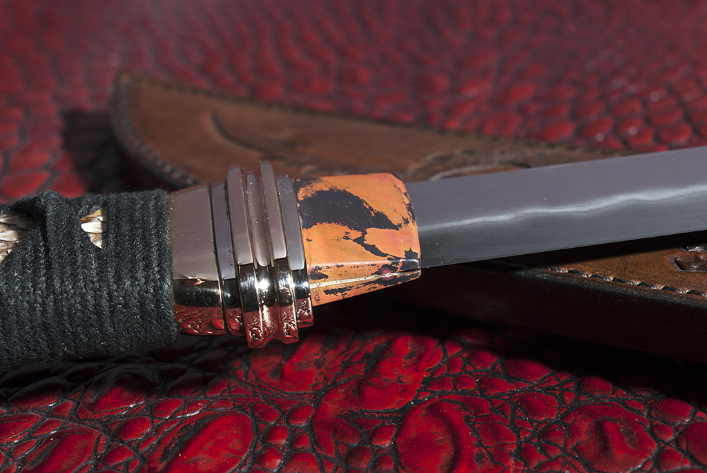

Awesome! :super: The blade is a real beauty and I like the sheath with the detachable belt loop. I'm not the biggest fan of high-polished fittings but it looks pretty decent on this tanto. How did you do the two-tone finish on the habaki?
Nice workmanship, but to much of all.
Über Geschmack lässt sich nicht streiten
WoSo
Thanks.

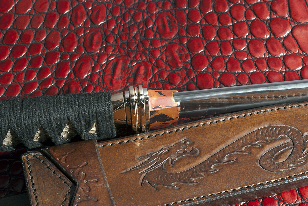

For habaki: after I polish and habaki is shining, I put in forge until the habaki is red, then immediately i quenching in cool water
This is result
