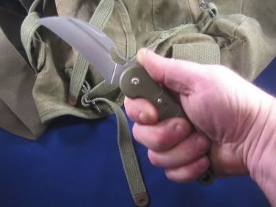

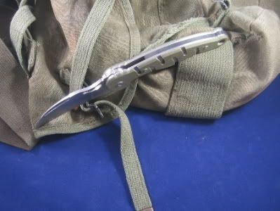

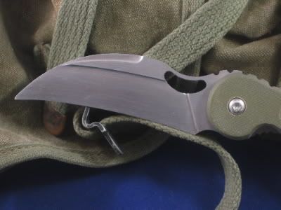

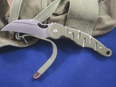

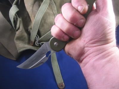

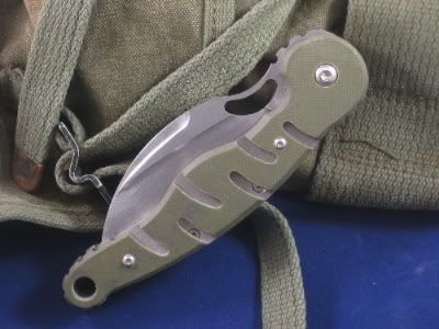

My name is Rick Haney,I'm a custom knifemaker from Chattanooga,Tn..I would like to share my work on this forum,I'm a new member,trying to learn some german while having some fun here.:DThis design is the Nighthawk,I wanted a cool hawkbill folder design.I still need to finish clip.

This is a phantastic and refreshing :)) knife-design! Tell us something about the materials you have used, the blade and the grips. And tell us something about the size of grip and blade.
What about dealers in Europe to buy that fine stuff? Or do you have a Homepage where we can buy with paypal etc.?
You're doing a good job, but we need more informations so far!

The specs are:
3.50" Hand sculpted ATS-34 blade Tumble finish
.095 Ti liners
Ranger green G-10 scales w/ patterned grooves
8.50" OAL
5.0" closed
Still need to finish ti clip
