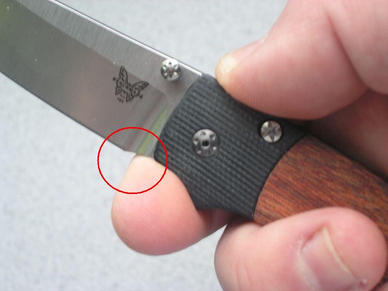

The Nak-Lok. What should I say? In theory a very nice mechanism, and the first day I was very satisfied. As I told you, I used the knife (because of size) only as gentleman folder, so no very hard use. Cutting of paper, opening of parcels, cutting of some flowers. Afterwards closing the knife using the lock - fine. But then I left the knife opened on the table and my girlfriend closed it and by watching her I was very surprised. I tried a spinehack test or lets better al it a spinepress test and the lock released!! So you can close the knife without pressing the button!! That’s a big minus :-( May be it's because of the prototype version of the knife - I hope so! This must get better!
Points: 3 of 10

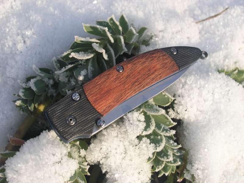

hi, here a few impressions of the shoki:
a gentlemans knife, mot only in size but also in its apparition. it has nice looks and the combination wood/CF result in an either classical appereance or a nice modern look.:super::super:
the blade came quite sharp an performed well (i just had easy tasks like opening boxes, cutting apple or a sausage for a snack and also some cardboard cutting). it held the edge really good.

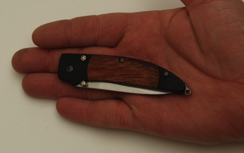

At first: Thank you very much for letting me try this knive. It the first experience with Benchmade knives outside of forum member meetings.
I will keep this text quite short and only want to mention some important issues:
1.) It's a very nice knive with materials I really like. The size, even if smaller than I thought, fit's most situations you will experience in everyday usage. But it's still small enough to be carried as an EDC with no big problems.
As it can be seen we got a prototype for this passaround. This may also explain some of its problems.
2.) Problems....yeah.... The biggest one was already mentioned. THE LOCK that doesnt lock! Some slipjoint knives are "locked" better than this one. Please Benchmade, spend some more work on this issue. The principle itself is good and easy to use
3.) concerning the optics. I like it. Materials, form, surfaces. No point to really complain about. The only thing. The backspacer with it's structuring doesn't match the simple and clear lines of the knive itself.

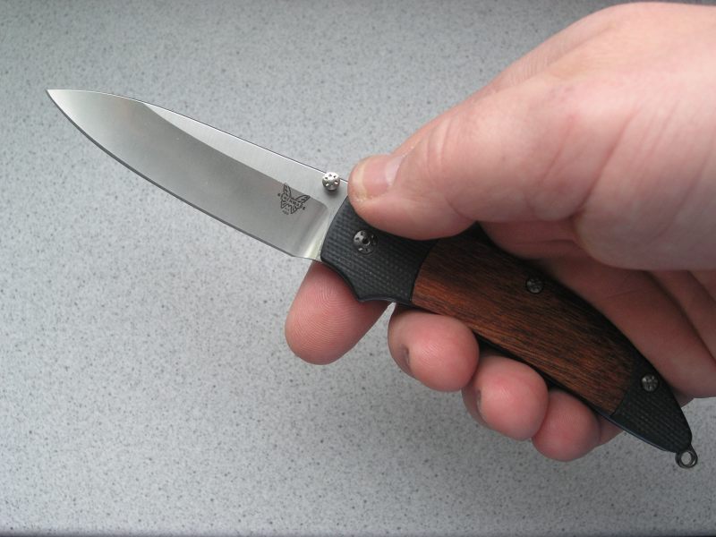

4.) the handling is quite good for a small and thin knive like this. For users with bigger hands than mine the handle would be to small. For me the size is perfect. Only the small loop at the end of the handle seems to be missplaced and (for me) of no use. I would prefer the knive without.
5.) As said before the cutting properties are very good for an everyday knive. I only used it for light "work" and it mastered every challenge. I really like the rounded back of the blade. It makes usage really comfortable.
6.) I only found very slight misstakes in alingment of the handle parts and in surface grinding. But I think they are related to the (maybe) handworked prototype.
Over all:
A very nice knife for EDC/EDU. A size that fits nearly all possible types of usage. Nice materials and well crafted. I hope the small cons will be gone in production

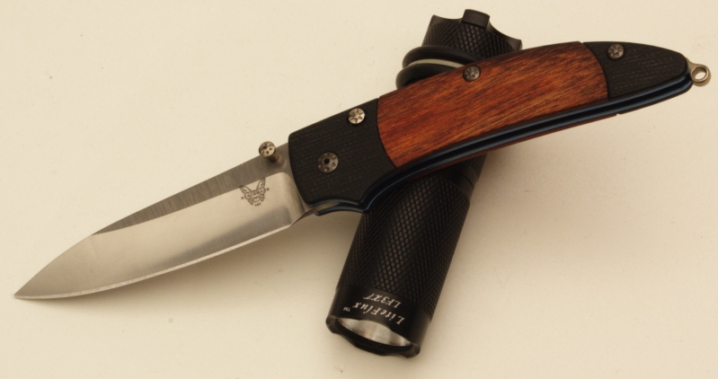

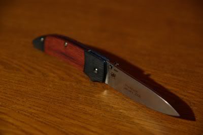

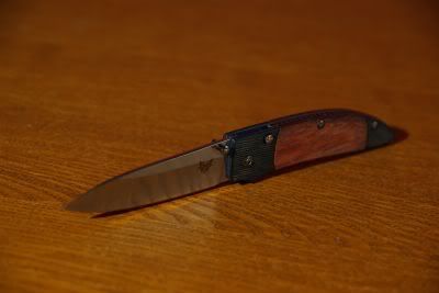

Here are my impressions of the BM Shoki:
My first thoughts have been: hope it don't get lost...the shoki is a cute, lightweight knife.
The handle with the wood/cf-scales on blue ti-liner looks realy good.

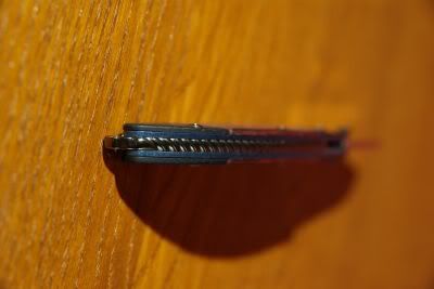

The fileworks on the backspacer is wellmade, but it is a little bit design-overload.

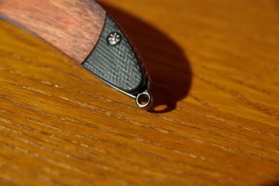

What I didn't liked was the external lanyardhole.
S30V is a very good choice for the blade, which was realy sharp. The thumbstud could be a little bit smaler.
The handling was good even for such a small knife. But with the lock I couldn't get familiar. Not only that is doesn't realy works on this proto, but mostly I use linerlocks or backlocks, perhaps it needs some more time for experience with the kind of lock...

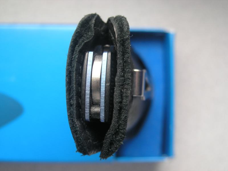

Carrying a folder in a sheath cliped in my pocket was new to me. The sheath takes too much space for that little cutie, here I would prefer the knife with a clip or put the shoki directly in the pocket.
The Shoki is a cute knife with some minor (design-)issuses (for me).
I hope, the badly-working lock is a problem only on this proto....
Thanx to Benchmade and Toby.

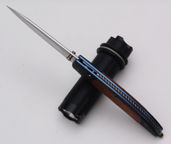

Hi there,
although the 480 is nicely designed and with a new locking mechanism (i´ve never seen it before) I sent it to virus3 after just 2 days. As a 710 carrier, this 480 Shoki is too fragile and there is no way this knife will make it in my EDC rotation.
But however, my pros and cons:
pro:
very nice details, like the spacer
benchmade quality
very nice material and colour mix.
very nice blade movement
con:
too fragile
thin blade
the extra steath (actually a good idea if you put the 480 in a bag or bigger purse but in jeans.. it´s not gonna fly)
overall just a little too small (maybe times 1,5)
Thanks for participation.
Axel

Der Griff hat gut in meine Hand gepasst, er war allerdings etwas zu kurz wenn man den Zeigefinger nicht in Gefahr bringen wollte (siehe Bild).

In der mitgelieferten Scheide mit Clip, lies sich das Messer gut in der vorderen Hosentasche tragen. Leider wies die Scheide schon sehr deutliche Tragespuren auf (siehe Bild). Auch hier müsste nachgebessert werden.

Like “Neweinstein” I’m not a Fan of the Loop at the End of the Handle, maybe I’d cut it off if the Shoki was mine.

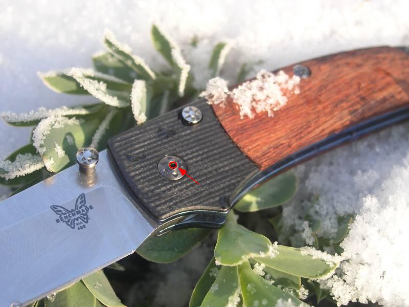

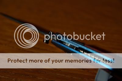

Ich möchte diesen Thread ebenfalls noch einmal hochholen, weil mir am Shoki noch eine Sache aufgefallen ist...
Der NAK-Lock hält zwar die Klinge gut, allerdings hat man Konstruktionsbedingt ein vertikales Spiel der Klinge, d.h. sie lässt sich ein Stück abwärts bewegen, obwohl es sich nicht um die Prototypenproduktion handelt.
Die Klinge ist arretiert und der Lock gibt ein wenig nach, so dass ca. 2-3mm Bewegung in der Klinge bei Durck auf den Klingenrücken möglich ist...es bleibt trotzdem nur ein feiner und schöner G-Folder für feine Arbeiten :)
LG, Jörg
Ich habe zwar nicht beim Passaround mitgemacht, will aber auch meine Erfahrung mit dem guten Stück kundtun.
Auch bei meinem Exemplar hält der Lock fest und klappt nicht ein und ich gebe Jörg recht, dass die Klinge ein vertikales Spiel bei entsprechendem Druck aufweist, aber 2-3mm halte ich doch für übertrieben. Man merkt das Spiel zwar aber von diesen Maßen ist meins weit entfernt. Vielleicht sind das aber auch Fertigungstoleranzen ;)
Trotz dieser Sache bleibt es ein schöner Gentleman-Folder.
Beste Grüße,
Andreas
