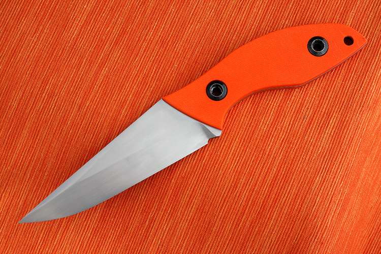

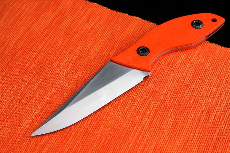

W wojtas13 Mitglied Messages 104 Jun 25, 2011 #1 3mm D2. Dimentions: Handle: 110mm, blade: 120 mm, overall: 230 mm. Inspired by knives by Emerson. By wojzaw13 at 2011-06-25 By wojzaw13 at 2011-06-25 By wojzaw13 at 2011-06-25

pitter Forumsbetreiber Staff member Messages 14,571 Jun 25, 2011 #2 Nice! Fresh, clear design, no blingbling. And I like the hollow rivets much more that ordinary screws - looks good. What about sheaths? Pitter

maidn Mitglied Messages 389 Jun 25, 2011 #3 Very Nice! What do you use to finish the steel? Greetings
W wojtas13 Mitglied Messages 104 Jun 25, 2011 #4 maidn said: Very Nice! What do you use to finish the steel? Greetings Click to expand... I finish grinding with 400 grit belt. Than handrub with sanding papers up to 600 - 1200 grit depending on desired finish. EDIT: I stick sandpaper to a micarta block with doublesided tape. It helps to me to keep sharp edges.

Flaming-Moe Mitglied Messages 2,591 Jun 26, 2011 #5 Yep, nice design, very clean. Did you use "Kettenblattschrauben" for the handle? I don't know the english name, but the screws look like the one used on bicycles. Am i right?

W wojtas13 Mitglied Messages 104 Jun 26, 2011 #6 Flaming-Moe said: Yep, nice design, very clean. Did you use "Kettenblattschrauben" for the handle? I don't know the english name, but the screws look like the one used on bicycles. Am i right? Click to expand... Yes, You are right. But these are hard to get very strong ones.

D.Frentzel Mitglied Messages 939 Jun 27, 2011 #7 Hello, i find it is a great line and a extreme edge. The Orange Grip are a good choice to make the knive not so :teuflisch. Regards Dirk
