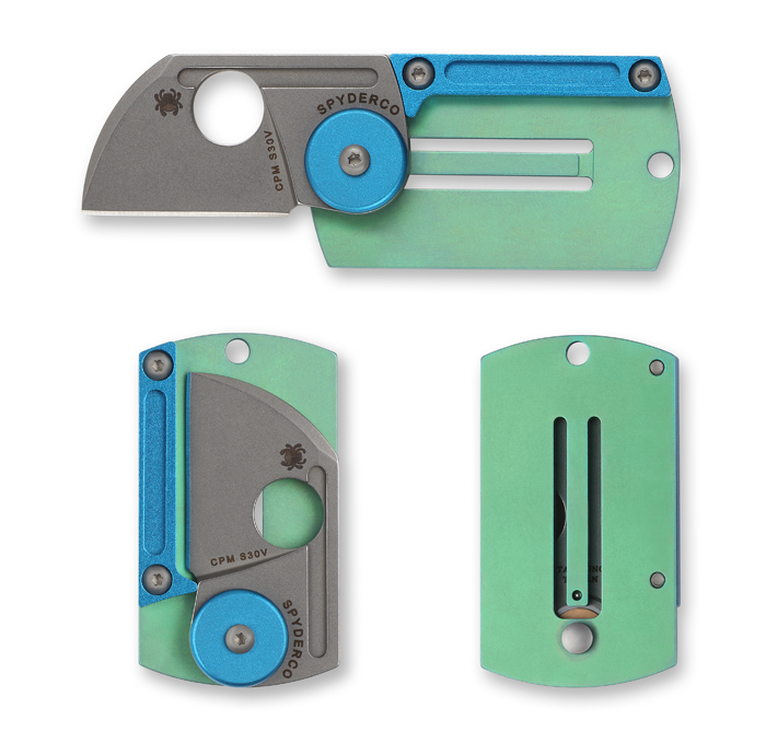

The Dog Tag Folder is a unique departure from Spyderco’s typical folding knife construction methods. Its single-sided handle is fabricated from solid titanium and accurately replicates the size and shape of a military dog tag. The center of the handle scale is machined to create an integral spring bar that houses a steel ball bearing for the blade’s detent mechanism. At the top of the handle is a titanium back strap that defines the blade’s limits of travel in both the open and closed positions and provides protection from the edge when the knife is closed.
The “business end” of the Dog Tag is a sheepfoot-style blade made from premium CPM® S30V® particle metallurgy stainless steel. To protect the edge when closed, the blade is chisel ground with a single flat bevel on the front side—an unusual feature for a Spyderco knife. Our Trademark Round Hole™ in the blade allows easy opening, and a subtle swedge (unsharpened bevel) and a decorative fuller (groove) near the spine add a touch of style. The blade’s pivot is also accentuated by a round titanium disk that provides stability and structural strength as well as an aesthetic touch.
A non-locking folder, the Dog Tag’s blade is held in place in the open position by a detent mechanism. A ball bearing in the handle scale’s integral spring arm indexes holes in the tang of the blade to hold it both closed and open. Since the blade does not lock, care should be taken during use to apply cutting pressure only in a direction that maintains the knife’s open position.
Released in 2014, the Dog Tag is available with two different finish options. One combines a stonewash finish on the blade, a green anodized handle scale, and blue anodizing on the back strap and pivot pin disk. The other will be a stealthy all-black motif in which the blade, handle scale, and all other hardware are coated with a durable titanium carbonitride finish.
The Spyderco Dog Tag Folder is an extremely novel yet capable cutting tool that redefines the concept of the everyday carry knife. We are confident that it will serve you well.
- length overall 3.23" (82 mm)
- length closed 2" (51 mm)
- blade length 1.23" (31 mm)
- cutting edge 1.14" (29 mm)
- blade thickness 0.118" (3.0 mm)
- blade steel CPM S30V
- weight 0.9 oz (26 g)
- handle material Titanium
