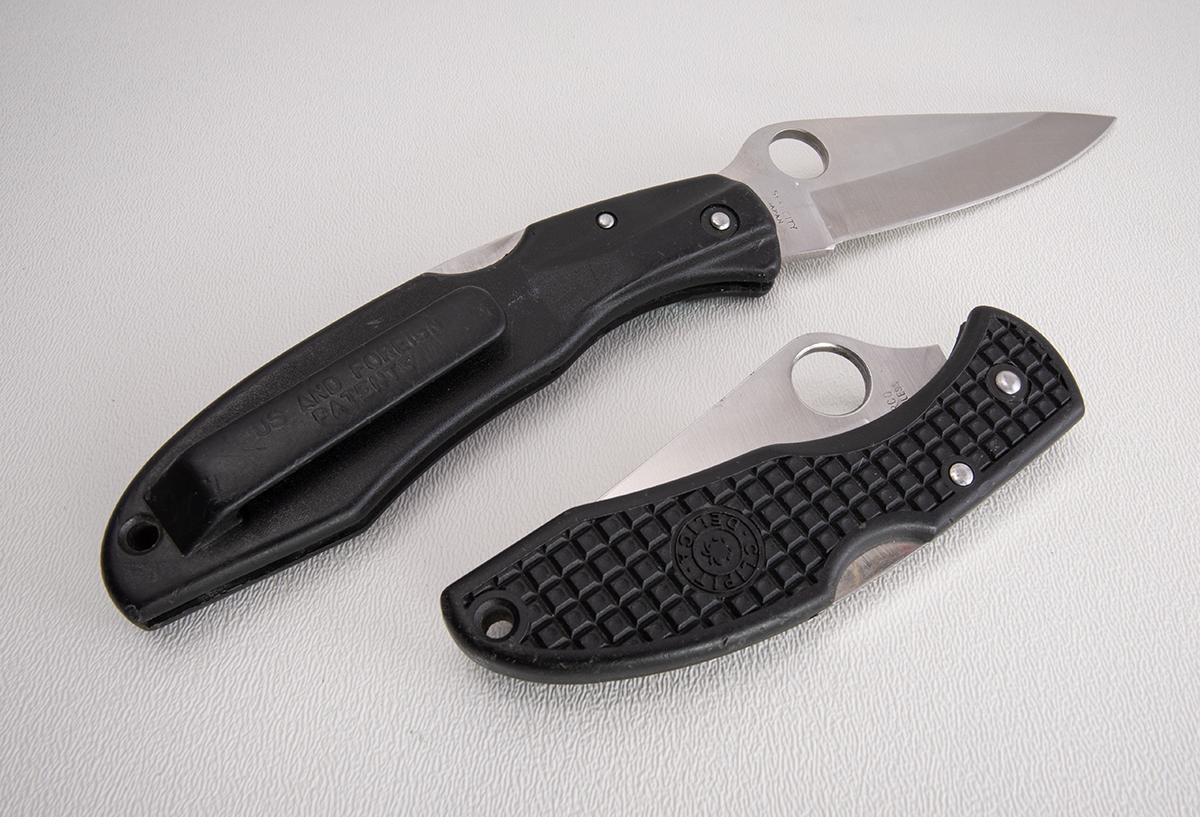

In 1990, when Sal created the first-generation Endura® and Delica® Lightweights, he once again defined the state of the art in folding knives by combining lightweight, injection-molded handle construction with the carry convenience of an integral pocket clip. These groundbreaking designs had one-piece FRN handles that included molded clips configured for right-side, tip-up carry. The side of the handle opposite the clip featured our Volcano Grip™ texture pattern for a secure, non-slip grip. A revolutionary development in folding knife engineering, the original integral-clip patterns occasionally return in the form of Sprint Run® limited editions, like the Catcherman™.

Despite their revolutionary impact on the knife industry, lightweight handles with integral clips had several disadvantages. They offered only a single carry position and could only have a molded texture on one side. These factors, along with the limited strength of molded clips, prompted Spyderco to revise the design of its injection-molded handles in 1998.
The second-generation lightweight handles still featured one-piece construction, but instead of an integral clip, they featured a metal one. Commonly known as a “barrel-bolt” clip because of its attachment hardware, this style of clip attached to the butt end of the handle and was reversible for left or right-side tip-up carry. Its base nested into a molded recess in the handle and was secured by threaded “barrel-bolt” hardware that could be tightened with a coin and had a hollow center that served as a lanyard hole.
In addition to the strength and versatility of its steel clip, this style of handle also allowed the Volcano Grip texture pattern to be molded into both sides. This greatly enhanced the user’s grip on the handle and made the knife’s design completely symmetrical and ambidextrous. This style of handle can still be found on a few current Spyderco designs, like the Atlantic Salt™ and Rescue 79mm™. Variations of this one-piece style of molded handle can also be seen in the Dragonfly™ 2 and in the clipless Ladybug® and Manbug®.
