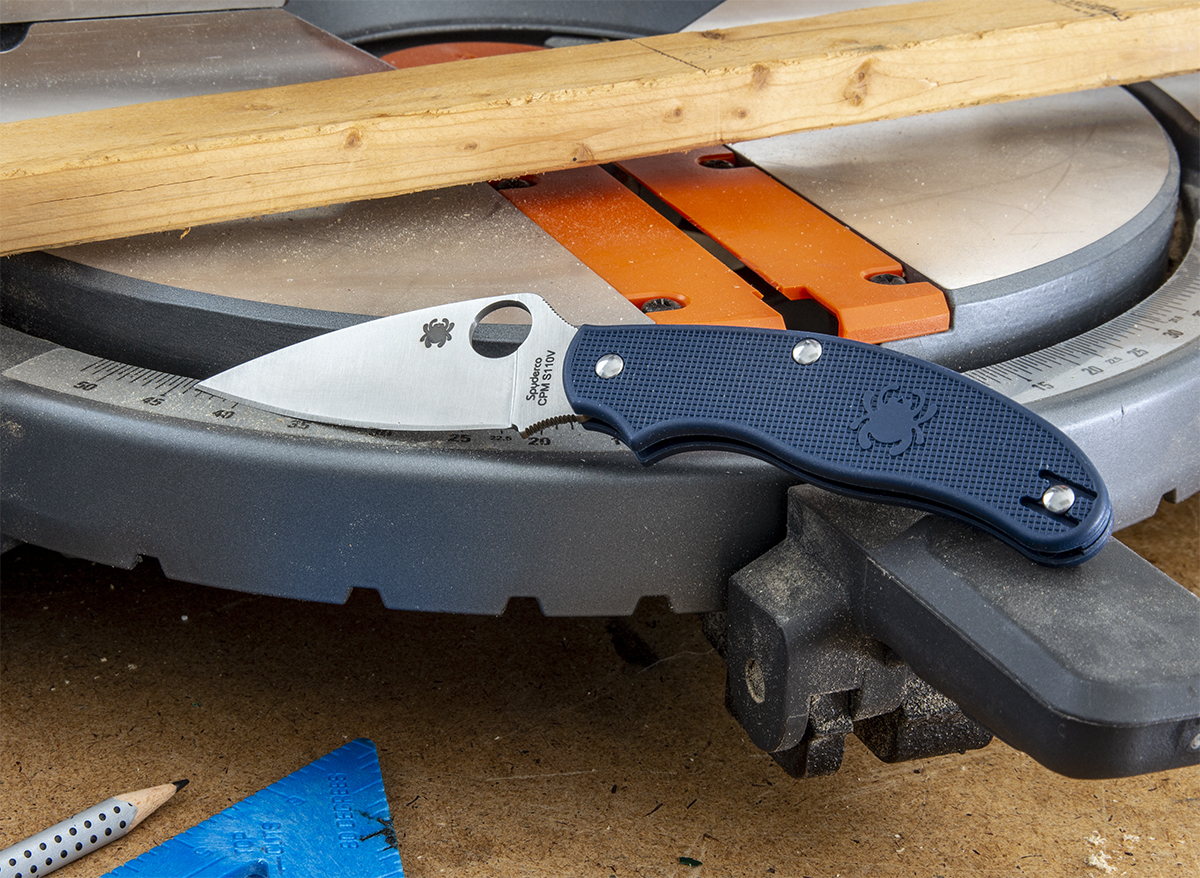

Led by the pioneering UK Penknife, Spyderco’s distinctive SLIPIT breed of knives revolutionized the concept of non-locking folders by incorporating a pocket clip for convenient carry and one-handed operation via our Trademark Round Hole. These features allow SLIPITs to be much more accessible and convenient than classic pocketknives and spare users the frustration (and broken fingernails) of traditional nail nicks.

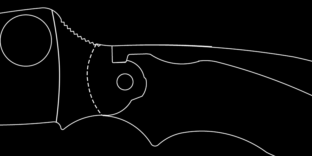

SLIPITS are also unique in that they feature “notched-joint” mechanism and a forefinger choil. Unlike the flat contact surfaces of the spring and tang of a slipjoint, the blade of a SLIPIT features a shallow notch and the backspring an extended lug. Although they resemble the lock interface of a back lock mechanism, the rear corner of the notch is purposely radiused. This clever design provides greater tension on the blade than conventional slipjoint mechanisms but does not mechanically lock the blade open.
The forefinger choil at the juncture of the handle and blade provides a comfortable purchase for the index finger during use. This forward grip provides enhanced control and allows the finger to serve as a natural “stop,” helping to prevent accidental closure of the blade during use.

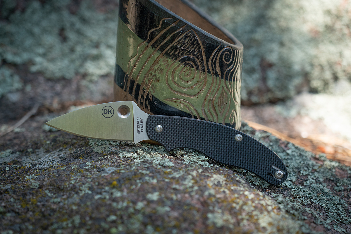

Although specifically created to comply with UK knife laws, the UK Penknife also gained favor in many other European countries. As the laws of those countries changed to become increasingly restrictive, Spyderco pivoted to keep pace. When Denmark prohibited one-hand-opening non-locking knives, we created the Spy-DK™—a variation of the UK Penknife with a much smaller Trademark Round Hole. The smaller hole still served as a proud symbol of our trademark and, when pinched between the thumb and index finger of the opposite hand, allowed easier blade opening than a nail nick. It was not large enough, however, to provide a purchase for one-handed opening. This hybrid, non-locking, clip-carry folder was known as a “ClipJoint™”—a term that never enjoyed broad usage but is an undeniable part of Spyderco history.

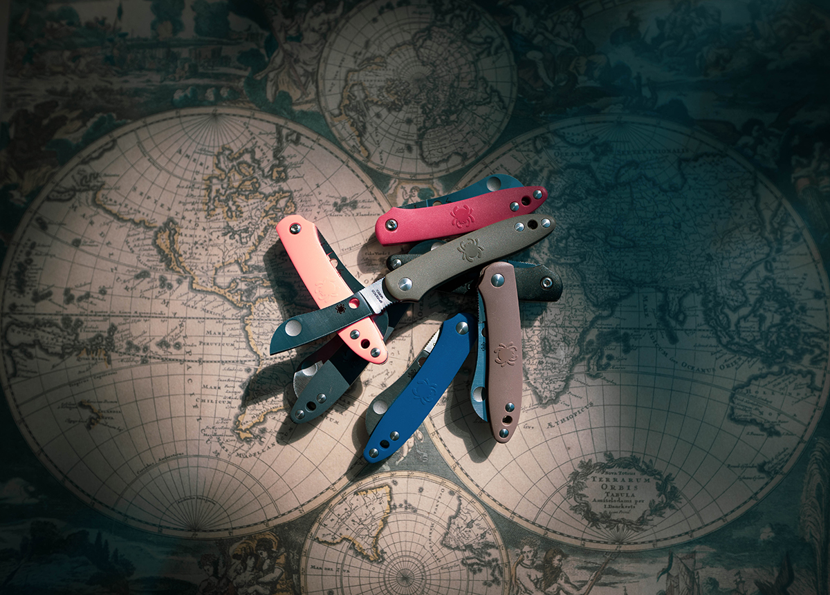

Finally, our popular Roadie™ series of knives combines Spyderco’s improved notch-joint mechanism with a bilateral “double dent” purchase in the blade to create a clipless modernized expression of the classic penknife.
