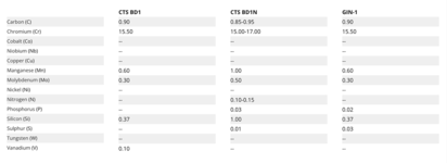

Two other notable examples of this approach—both conceived and driven by Spyderco—are Carpenter’s CTS® BD1/CTS BD1N and our own proprietary CPM SPY27®. CTS BD1 began with Sal Glesser’s vision for a particle metallurgy version of the steel used in the very first Spyderco knives: Japan’s Gingami-1. A true workhorse steel with a good balance of edge retention, toughness, and corrosion resistance, the properties of GIN-1’s alloy composition were significantly enhanced by the powder metallurgy process to create CTS BD1. Later, Carpenter added nitrogen to the steel (the “N” in “BD1N”), improving its qualities even further and making it ideal for use in knives with acute, high-performance edges—like the Murray Carter® Collection Wakiita™ Series and Minarai™ Series.

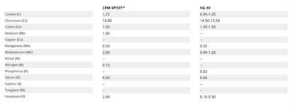

Similarly, CPM SPY27 was the result of close cooperation between Spyderco and Crucible Industries to create a particle metallurgy expression of another tried-and-true Japanese steel: VG-10. Although SPY27’s alloy mix is slightly enhanced with the addition of niobium and more molybdenum, it is otherwise very comparable to VG-10. Its performance, however, is significantly better in all categories, thanks to the benefits of Crucible’s CPM process.
