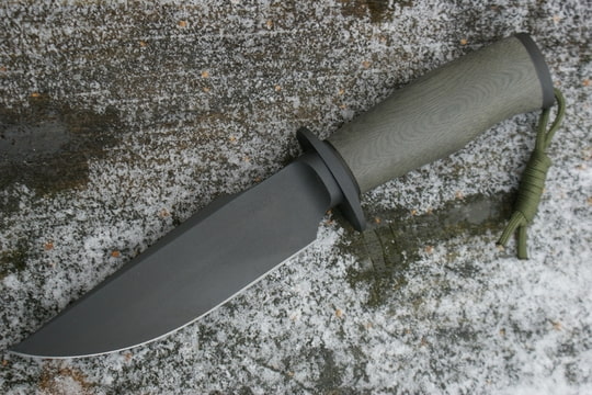

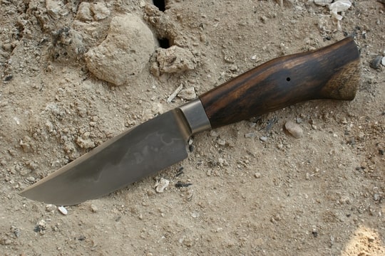

Hi all,
This is something different from me.

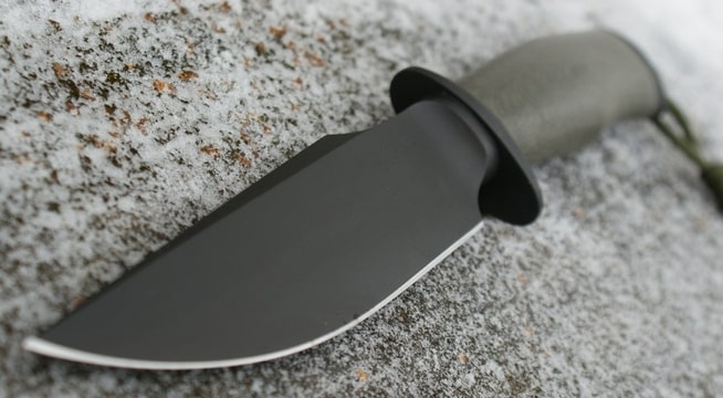

Blade guard and pommel made of O1.
Guard and pommel also hardened.
Black Gunkote coating ( thanks Toni!).
OD green Micarta handle.
Bladelength 15 cm.
Overall length 27,8 cm.
This knife will get a sheath made by Martin Swinkels.
Ther will be 12 cm, 10 cm and damascus versions of this knife in the near future.
Thanks for looking!

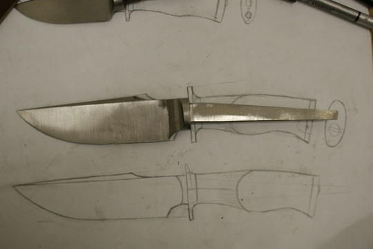

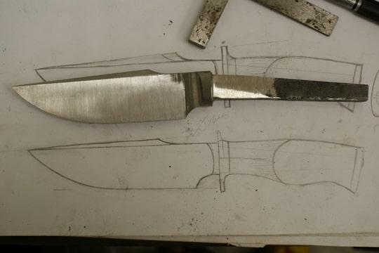

The Taurus is not a full integral, I usually make them like this:
The Taurus has the about the same bolster as the knife above but with a separate guard added behind that. Wich leaves much more room for a tang that is much stronger than possible on a conventional knife.
This is the tang before tapering the tang, the size of the tang is 12 mm thick by 18,5 mm high. ( see below )
This is a topvieuw of the tang before tapering. ( see below )
This is the tang after tapering the tang and flattening the back side of the bolster, the size of the tang is still 12 mm x 18,5 mm measured against the bolster. ( see below )

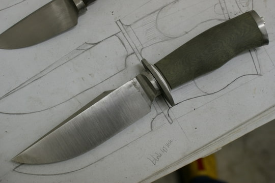

Guard, handle and pommel fitted. ( see below )

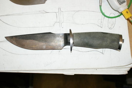

Hardened and partially finished all steel parts. The blade is differentially hardened. ( see below )

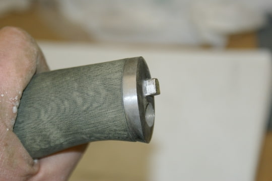

Testfitted before final finishing, etching my logo, beadblasting and coating. The end of the tang is still 7,5 mm x 9,5 mm where it goes through the pommel. ( see below )

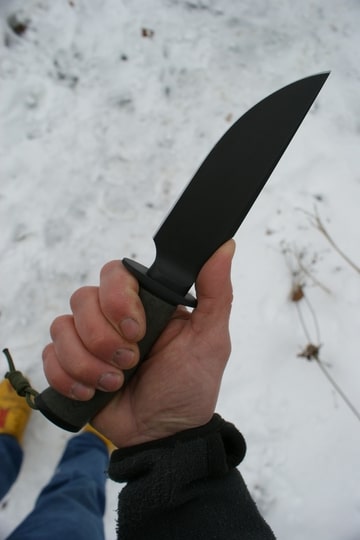

Knife finished and assembled, tang peened. The peening is the strongest way of fixing a handle, it has been done for over a thousand years so it must be good.
Knife finished. 8)
I hope this gives you more insight on the construction of this knife. It is not the easy way but it leaves much more room to make the strongest construction possible.
