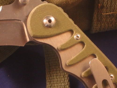

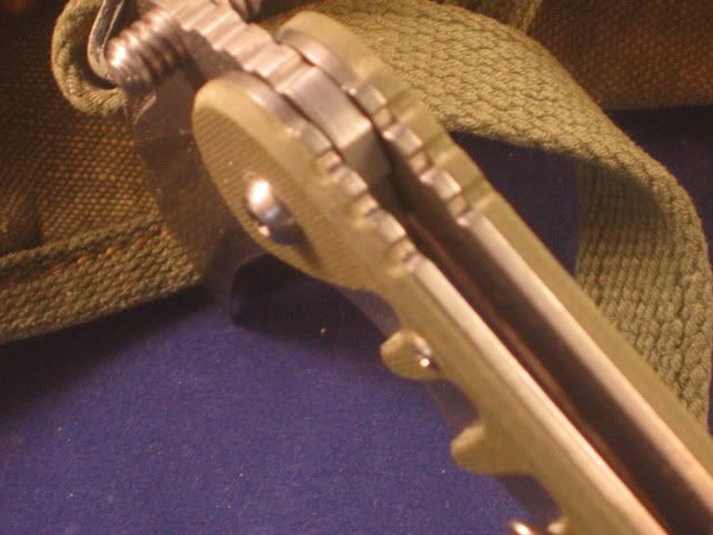

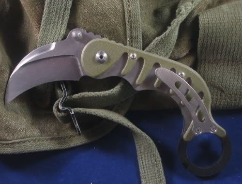

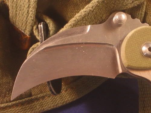

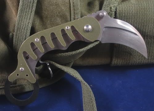

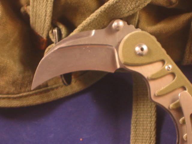

The Tiger Attack Karambit got a slight redesign since playing around with CAD the last 4 months.This design was to use the tiger element,Stripes.
The original design I textured the scales,This is the new scales.Liking this version mo better.Also this design I wanted to incorporate intergral backspacer & finger ring.I made this one with black G-10,Since I didn't have any thick stuff to use. This was designed more SD,It has ambidextrious clip locations.This happened to get reverse grip carry.
2.25" carved CPM S-30V blade
Ti liners
Ranger green G-10 scales
Carved Ti clip
G-10 Backspacer & finger ring (1")
6.25" OAL
5.0" closed
It don't reminds me of a tiger, I think it looks like a fishbone with a parrots head - but it's cool though. I would like it even more with closed scales and a kind of wharnie-blade (easier to resharpen), even when it would be no "real" karambit any more...
mfg, stubenhocker
mfg, stubenhocker
Thank you,Guys.
Fishbone with a parrot's head!LOL!Come to think of it,You're right!
