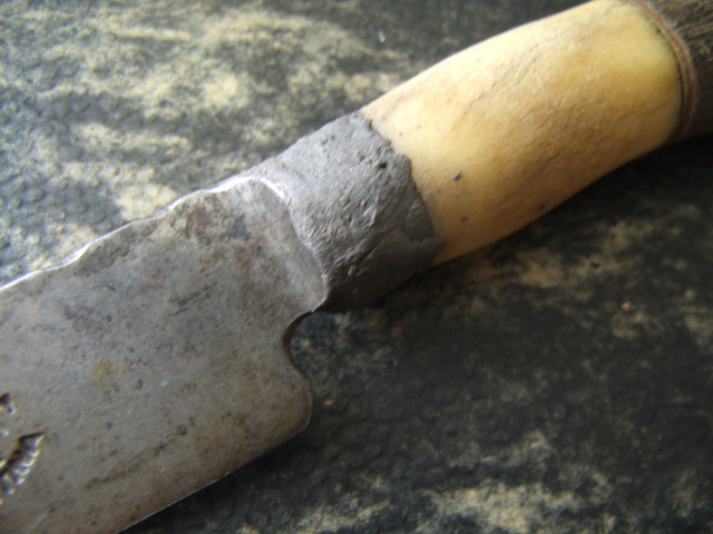

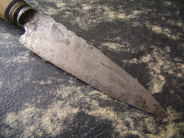

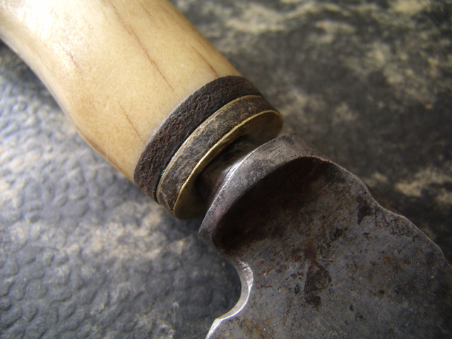

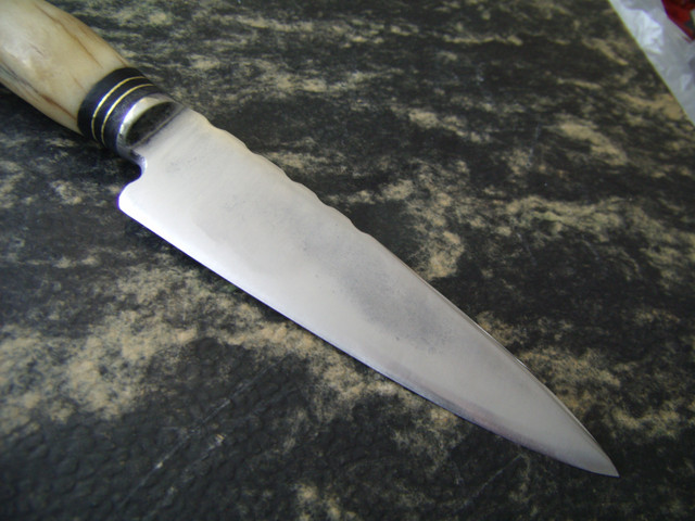

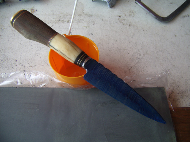

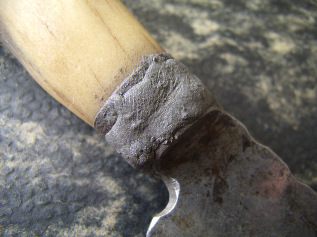

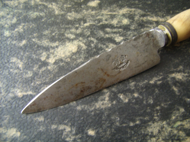

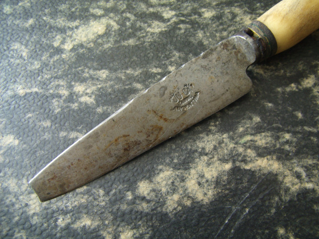

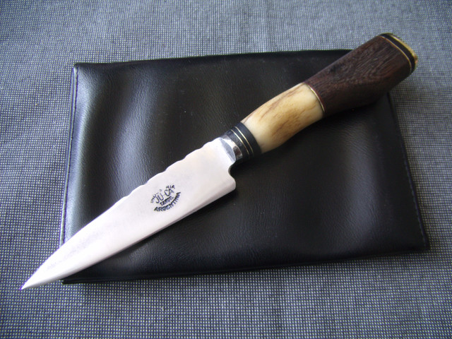

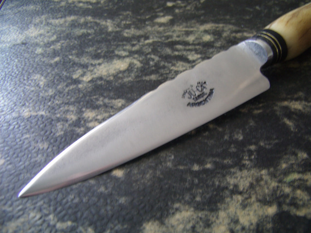

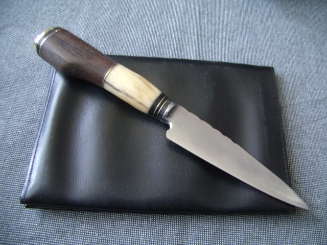

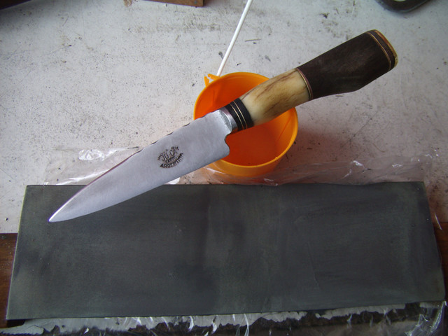

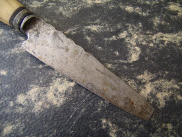

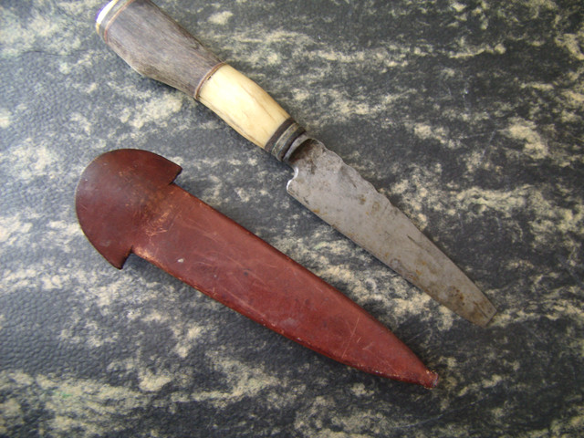

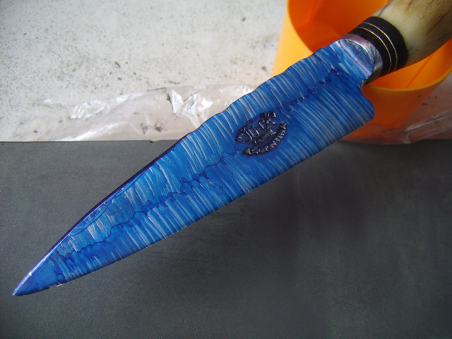

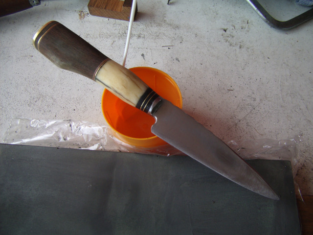

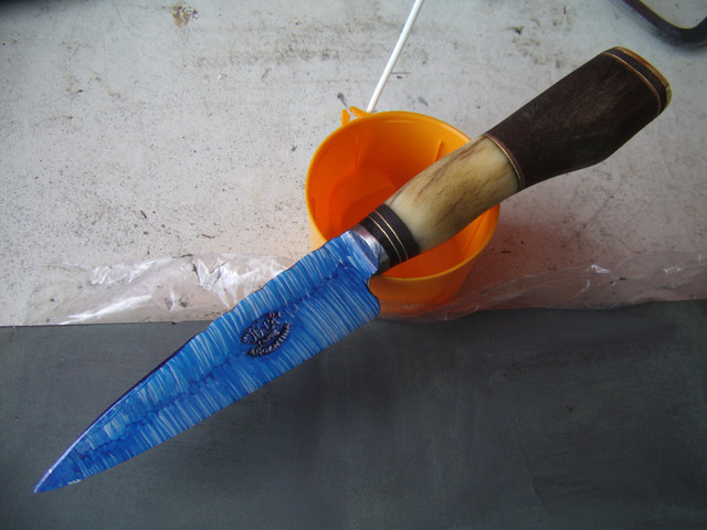

Argentinian Ju-Ca small fixed blade regrind & TLC

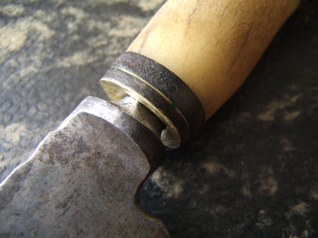

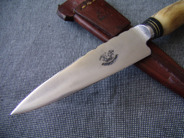

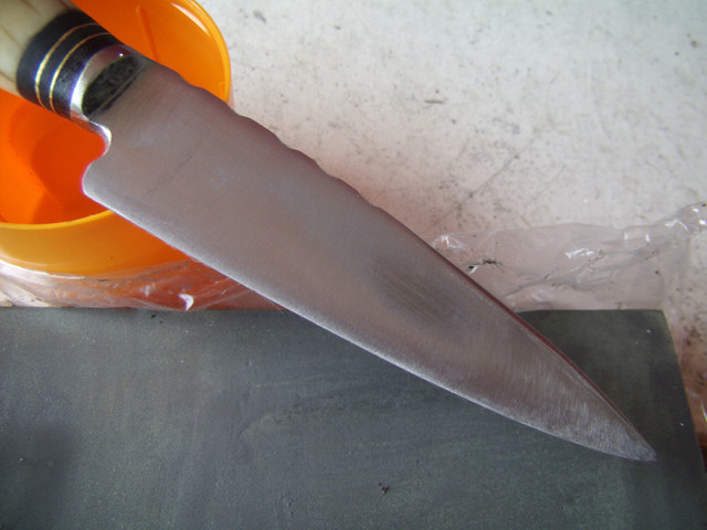

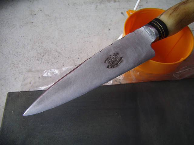

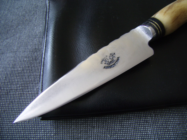

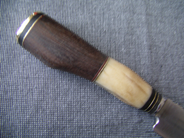

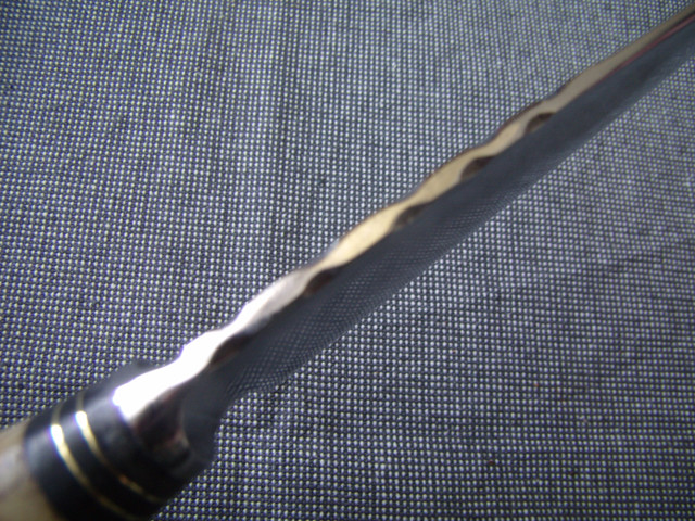

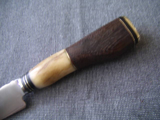

Handle parts & washers fine sanded, polished and waxed, filework & swedge also polished a bit & the blade stropped on hard cardboard with 1.0 micron diamond compound to remove the burr.

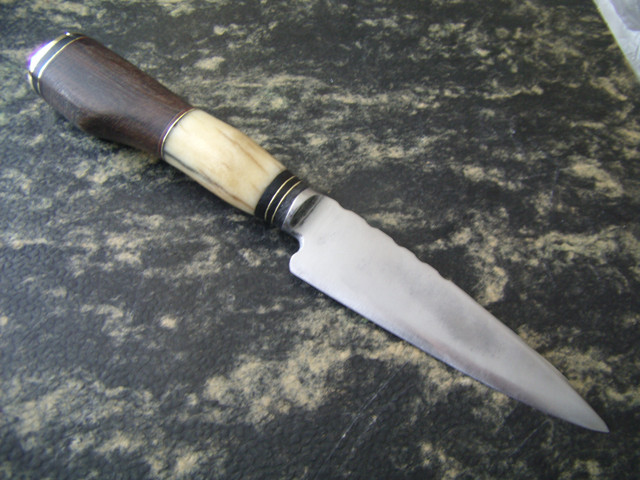

Specs:
Overall length: 20,9 cm (8.23 inches)
Blade length after the regrind: 10,0 cm (3.94 inches)
Max blade thickness: 3,1 mm
Brale grind: full convex zero edge
Blade steel: forged 1045 carbon steel
Handle materials: 1 x JB-Weld/Leather/Brass washers, cowbone, Argentinan hardwood, brass pommel

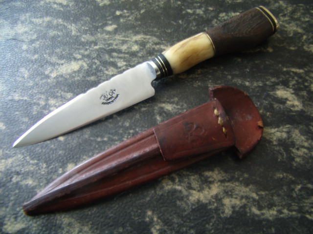

Sheath: brown leather (left-hand model)
Weight (knife only): 98 grams
Weight (knife + sheath): 120 grams
What an amazing work and result. You turned scrap into an edged jewel! Congrats.
