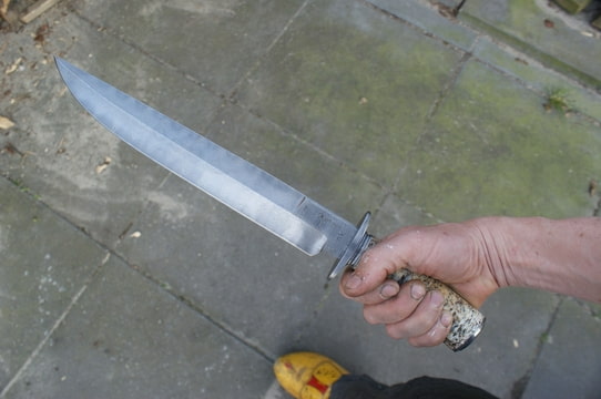

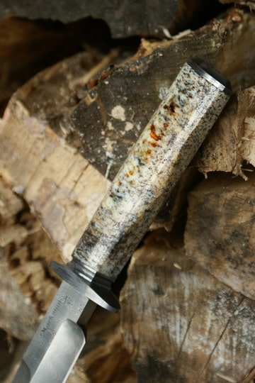

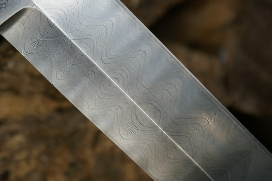

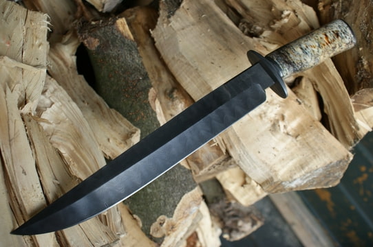

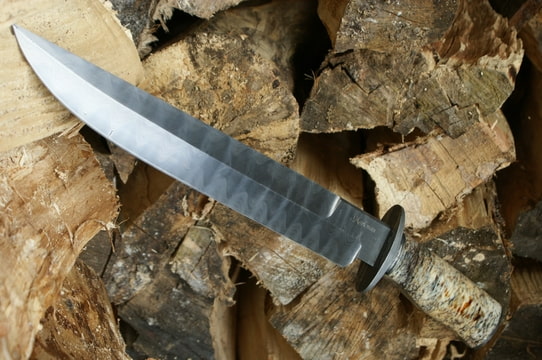

Big damascus fighter with Oosic handle.
Damascus for the blade is made of O2 and 60ni20.
Damascus for the guard ferrule and of O2, 75ni8 and 60ni20.
Handle is fossil Oosic.
Bladelength 30 cm.
Total length 44 cm.
The blade is hollowground on four sides.
I will make a nice sheath for this one.
