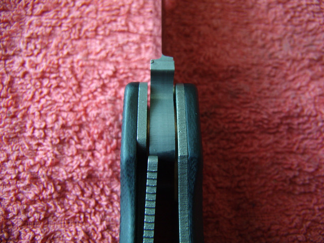

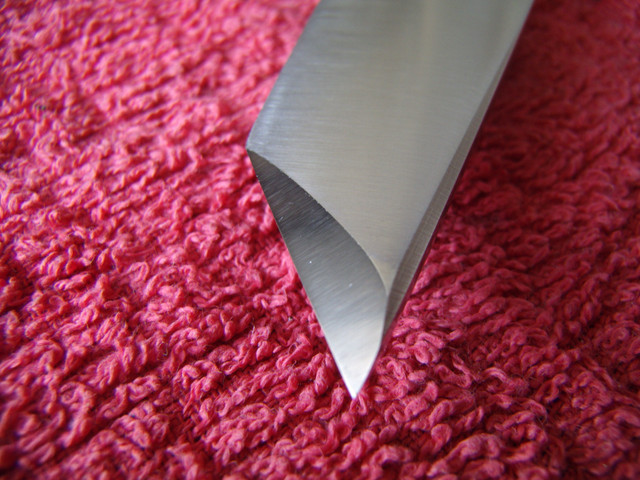

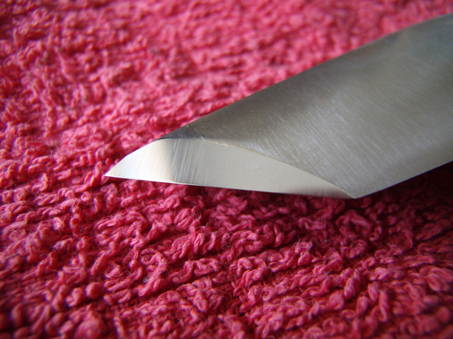

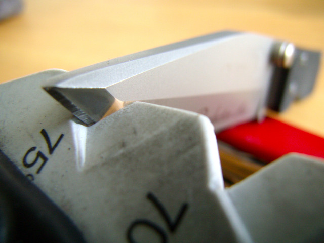

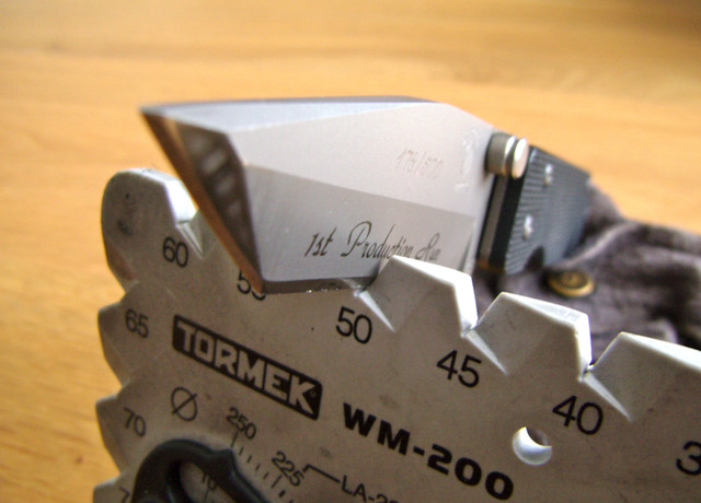

The apex on the now full convex blade measures somewhere between 22.5 and 25 degrees inclusive, and i'm first going to do some test cutting to find out if i can safely lower it a bit more.

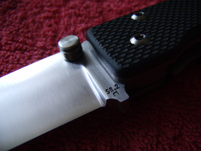

Also rounded the overly sharp G10 grip plates a bit and sanded the screw heads.

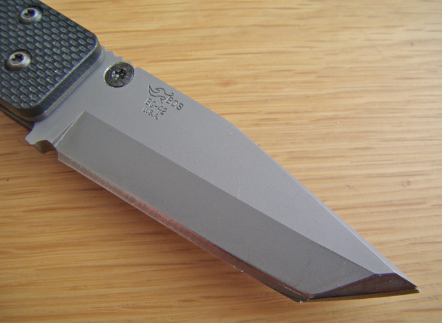

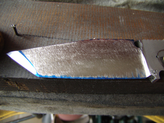

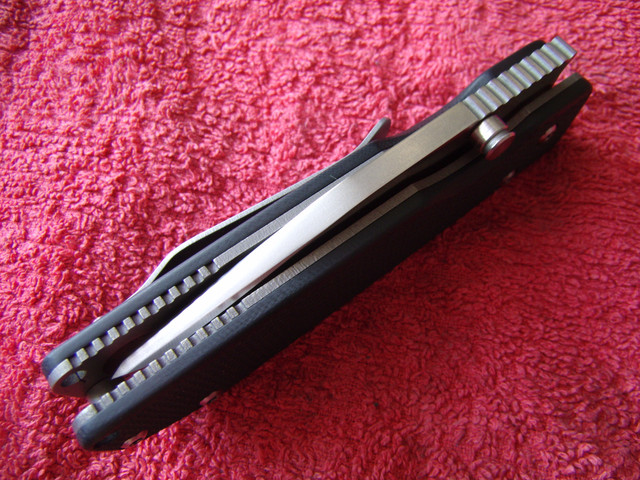

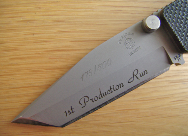

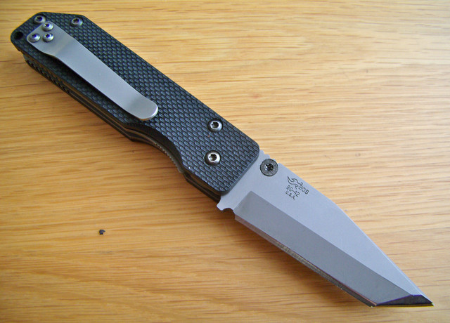

Before:

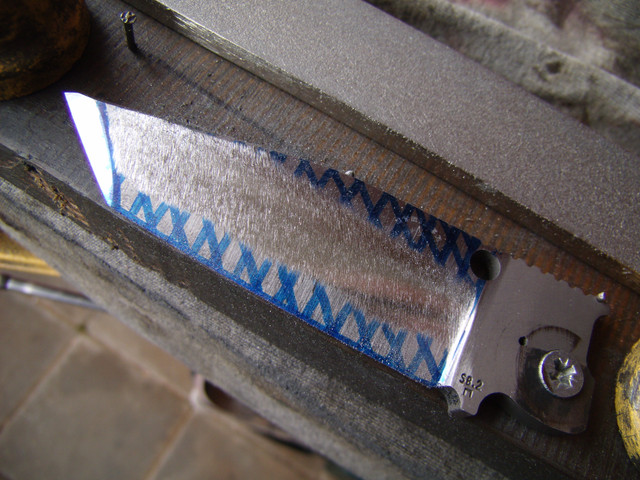

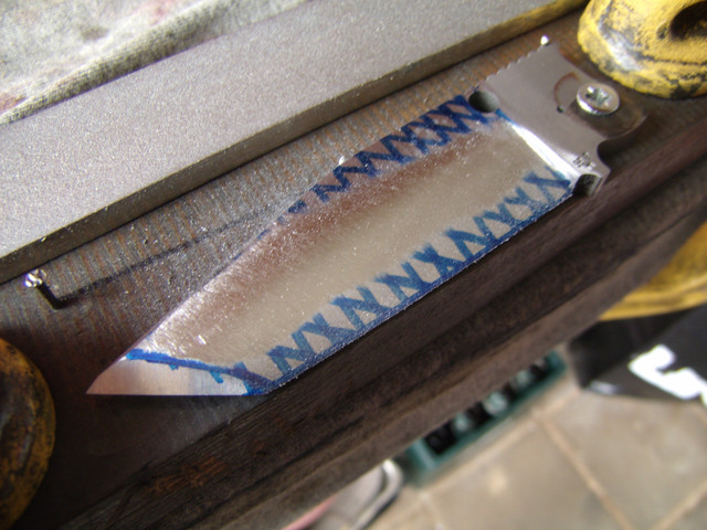

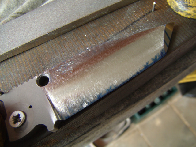

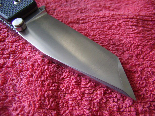

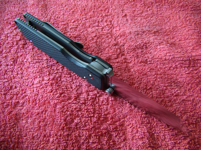

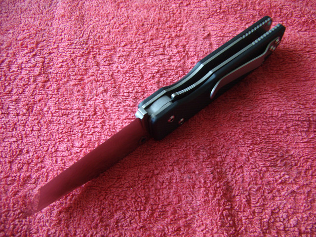

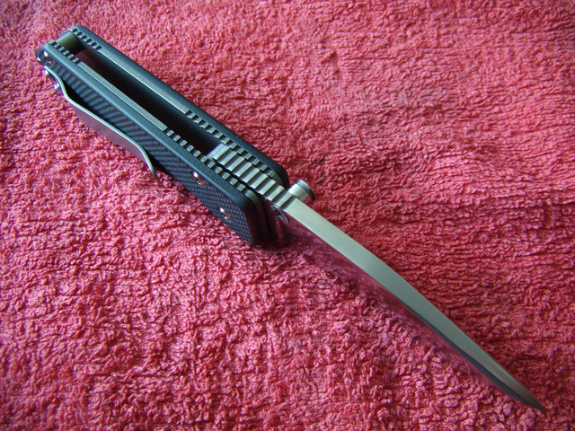

While grinding the blade with the diamond file:

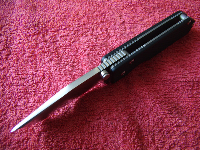

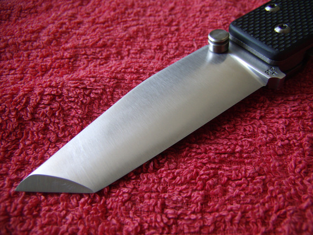

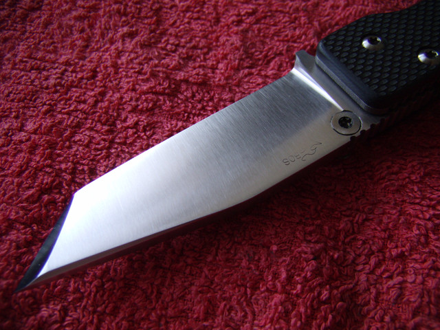

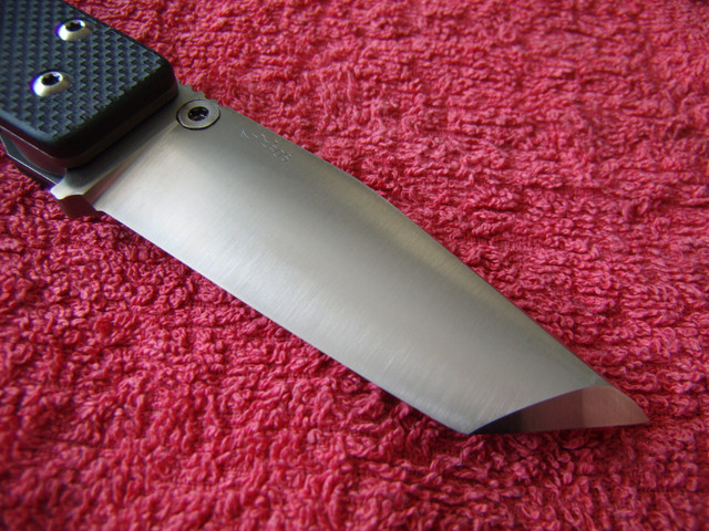

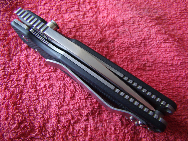

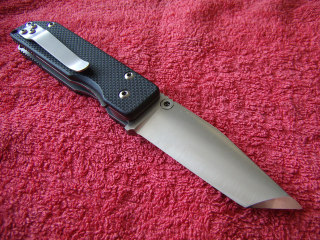

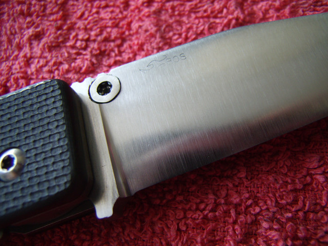

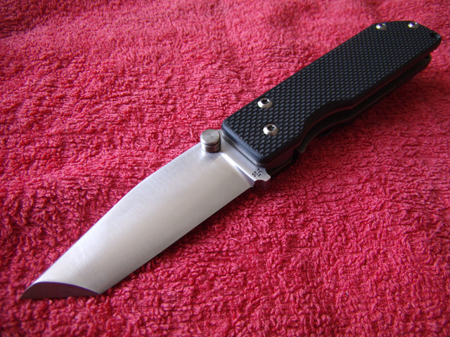

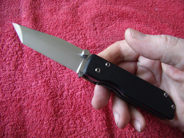

After the 400 grit SiC paper and removing the tiny burr on a piece of hard cardboard with a dab of 1.0 micron diamond paste:
Considering all work was done with only one eye currently functioning at about 80 % (plus a pair of reading glasses) i'm quite pleased with the result,

Before:
