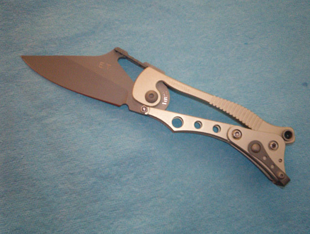

Grant and Gavin HAWK - E.T.

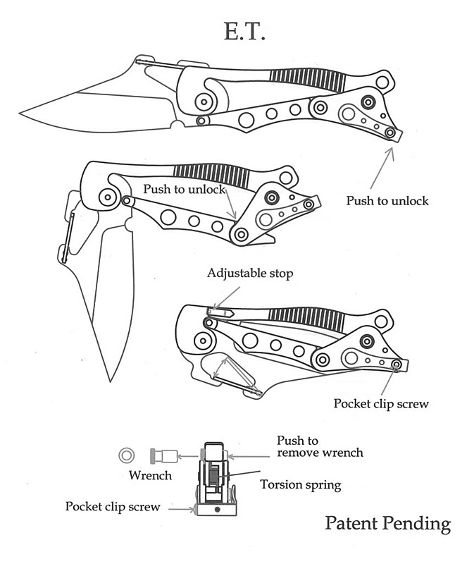

E.T. is an acronym for External Toggle, and external toggle describes the locking mechanism of this very unique folding knife. The toggle lock linkage is used in a wide variety of industrial grade equipment wherever long travel, a magnification of force and a positive lock are required in a single mechanism. The most common example may be that of the vise grip style locking pliers, which apply far more force than needed for a knife, but works on the same principle.
A review of the drawings shows how the linkage moves during the transition from open to closed and illustrates how the simple act of gripping the handle insures that the blade will remain locked in the open position. When the blade is open, the three pivot points of the long and short toggle come to rest slightly beyond a straight line, drawn through their centers, thereby preventing the mechanism from feeding backwards. A light torsion spring is positioned around the axis of the rear toggle in such a way as to constantly urge the toggle links into a straight line. The effect of this spring is to propel the blade toward open when opening and to propel the blade toward closed when closing. This same spring also serves to hold the blade closed until needed.
The blade stop is adjustable to insure that blade lock up is not so loose as to allow movement or so tight as to generate excessive force in locking. The drawings show the location of the threaded stop, which is specially treated to prevent unintended movement. A 1/16 allen key can be inserted from the front, when the blade is closed, to fine tune this adjustment. The locking nuts securing the long toggle to both the blade tang and short toggle are also adjustable for correct clearance.
A socket wrench for this purpose is provided on board the handle frame, in the form of a lanyard hole liner, inserted into the lanyard hole from the left side as shown. The wrench is held in place by the free end of the rear torsion spring. To remove the wrench simply press on the small end protruding from the right side which displaces the retaining spring and allows the wrench to be pulled free from the left side as shown. The knurled portion of the wrench serves as a finger grip to turn the lock nuts to the correct setting. The adjustment is correct when the pivot points turn free without drag. Reinserting the wrench from the left side of the lanyard hole allows it to be recaptured by the spring.
The titanium pocket clip is reversible by removing the retaining screw and swinging the pocket clip 90 degrees or until it can be spread apart enough to clear the pocket clip bosses on both sides. The retaining screw is then replaced before removing the screw on the opposite side. The pocket clip can now be reinstalled by reversing the disassembly process. When the blade is closed, the karabiner is in the active mode and can be used to carry the knife by capturing a ring or chord. When the blade is open, the karabiner comes to rest on the floor of a notch cut in the handle frame providing a reliable thumb support while using the knife. The karabiner also serves as a thumb stub when opening the blade either left or right handed.
To unlock the blade for closing it�s only necessary to push on the extreme end of the short toggle to collapse the linkage or to push out on the long toggle/short toggle knee joint (see drawing). If anyone ever thought they would like to own a truly unique folding knife with a very strong lock and a yet unknown number of techniques to open and close the blade, they will not be disappointed with the E.T.

2) Der Kniegelenkverschluß der Pistole 08 besteht aus drei Teilen,
der wichstigste, der linear gleitet, fehlt hier.
(Als Beispiel: Ober- und Unterschenkel falten mit dem Knie als Gelenk,
der Fuß aber gleitet gerade vor und zurück. )
Da denk ich kommt das TOAD näher dran. ?
3) Bin gespannt wann die eine Variante mit obenliegendem (P08)
Kniegelenkverschluß machen, die könnten das und es wäre evtl ein Renner. :D :D

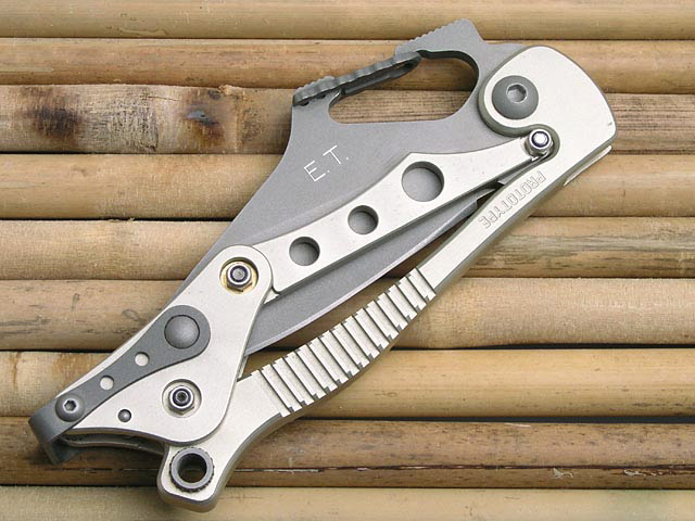

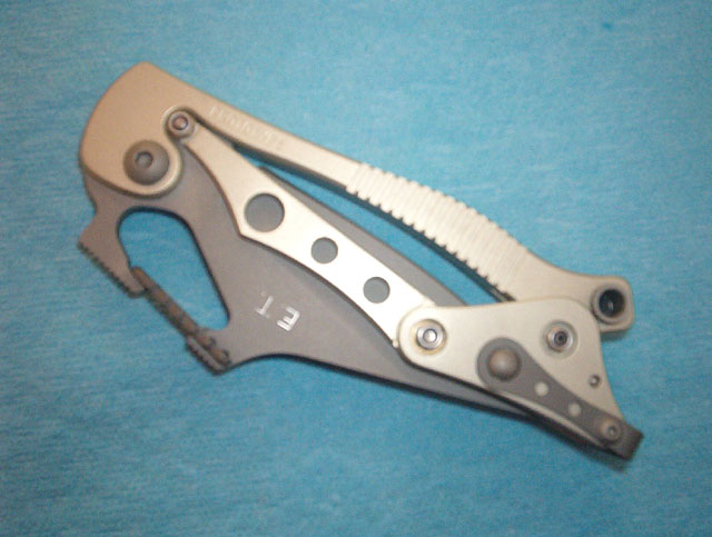

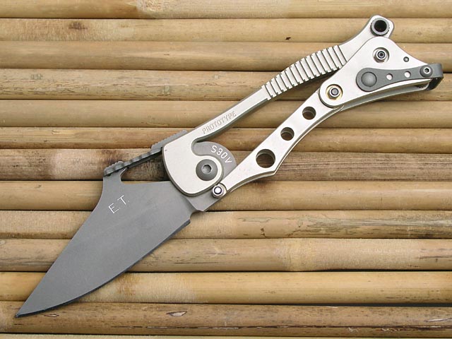

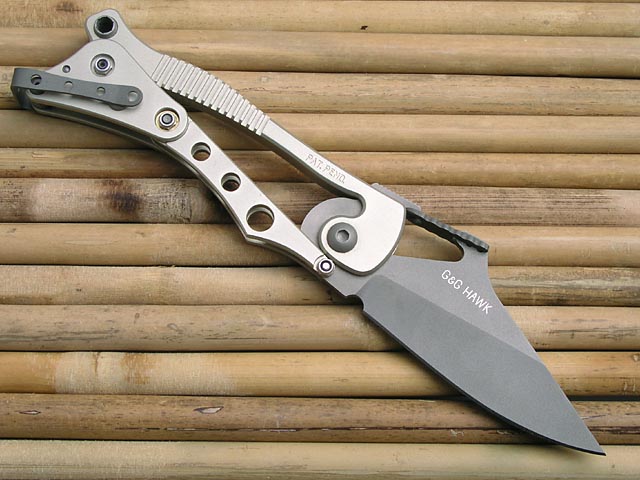

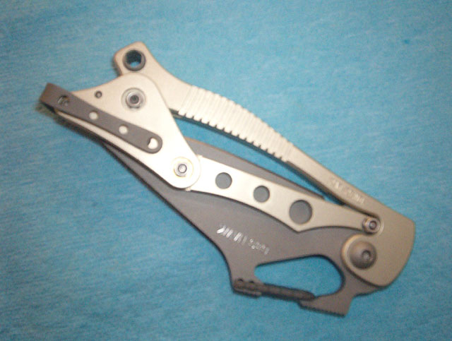

So, das Dingens ist hier und ich konnte damit spielen.
Spielen - das ist der Punkt. Was bitte schreibt man bei so einem Messer in einen Bericht? Handlage, Rutschsicherheit der Klinge, Spine Whack, Preis-Leistung :irre: ?
Ok, erst mal zu den einfachen Sachen.
1. Das Ding funktioniert. Schon mal was :D Die Klinge verriegelt durch das überstreckte Gelenk sicher. Da dazu die Hand den Griff umschliesst, kann das Ding unmöglich unbeabsichtigt aufgehen.
2. Handlage. Tja, man glaubt es kaum, das Teil liegt gut in der Hand. Alle Kanten sind gerundet, da drückt nix, da zwickt nix und man hat das Messer fest im Griff. Nicht das das was besonderes wäre, aber bei dem Design hat mich das schon etwas verwundert. Egal wie, passt.

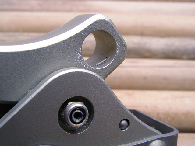

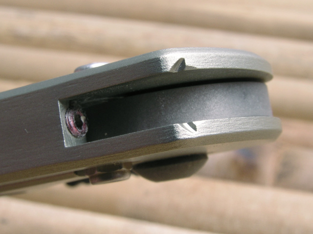

3. Verarbeitung. Das Teil hat insgesamt vier Lager. Alle mit Bronze Washern, Bushings. Klingenspiel nahe null, nicht mehr als bei anderen Linerlocks. Vertikalspiel der Lager, nahe Null. Da wackelt gar nix. Das Ding ist gebaut von Maschinenbauern für Maschinenbauer.

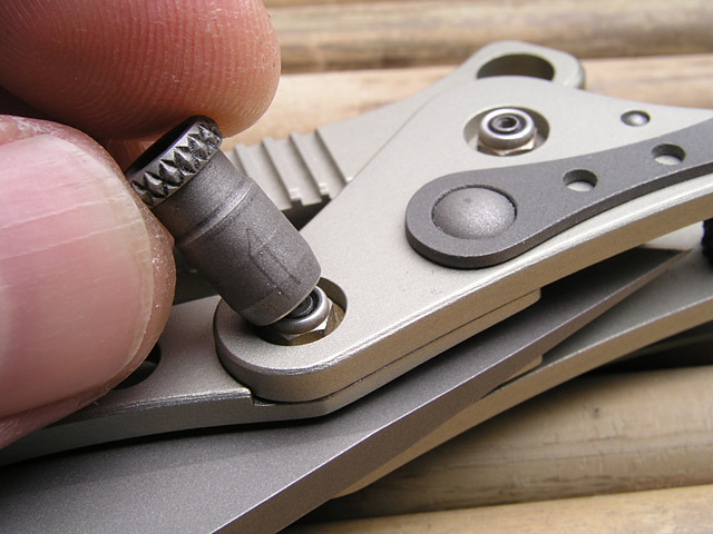

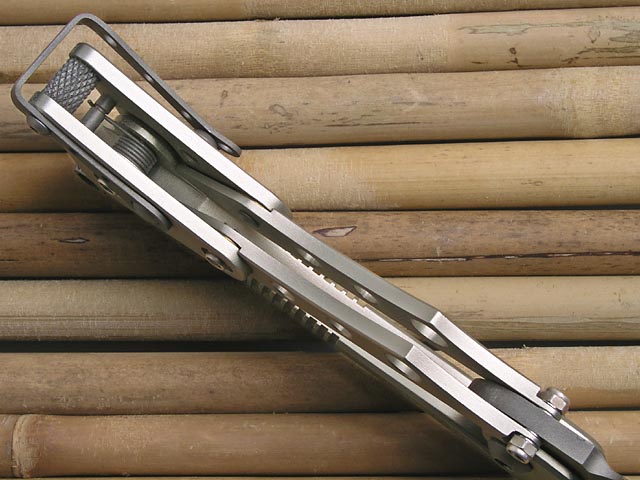

Dazu gibts eine Menge Details: Als Stoppin ist eine Schraube in den Griff eingelassen. Damit kann man erstens den Stoppunkt einstellen, zweitens ist auf Dauer Stahl gegen Alu nicht die robusteste Kontruktion. Die Schraube dagegen liesse sich wechseln.
Daumenauflage: ist federnd gelagert, ähnlich einem Karabiner. Damit kann man das Messer irgendwo einhängen. Ist die Klinge geschlossen, lässt dich der Karabiner öffnen. Im offenen Zustand gleitet das bewegliche Ende des Karabiners in zwei Aussparungen am Griff, ist so fixiert und funktioniert als Daumenauflage.
Lager: Sind über die Schrauben einstellbar. Ein passender Schlüssel steckt im Fangriemenloch und wird darin vom freien Ende der innenliegenden Feder gehalten.
4. Bedienung/Alltagstauglichkeit. Vernünftiger Schliff, gute Handlage, Daumenrampe sitzt ideal. Das Teil ist super leicht, wen wunderts. Der Lock ist sicher, eine Feder hält die Klinge im geschlossenen Zustand ausreichend fest.
Wie man allerdings die Klinge einhändig bedient, habe ich nicht rausgefunden, wahrscheinlich gibts dazu noch nen Wochenendkurs. Auf geht das ja mit einiger Übung ja noch, aber zu? Ist aber letztlich auch egal, dieses Messer möge man bitte zweihändig und langsam öffnen. Rentiert sich :)
Ja und nu? Fakt ist, dass der Mechanismus des E.T. perfekt funktioniert und man das Messer trotz des ungewöhnlichen Designs einwandfrei verwenden kann. Unpraktisch ist, dass das Messer im geschlossenen Zustand breit baut, für die Hosentasche ist das nichts.
Braucht die Welt das E.T. ? Nö :steirer: . ein Linerlock/Integrallock hält genauso, ist leichter bedienbar und - da er aus weniger Teilen besteht, prinzipbedingt robuster. Brauche, robust, Hosentasche, egal: Das E.T. hat einen Oha-was-ist-das-Charakter von 15 auf einer Skala von 1 bis 10. Und den Gadget Faktor definiert es neu :D .
Ich hab mal versucht, in den Bildern alle Details zu zeigen, das Ding muss man aber in der Hand haben, um wirklich einen Eindruck zu bekommen. Wenns Fragen gibt, nur her damit.
