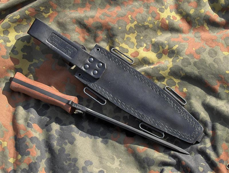

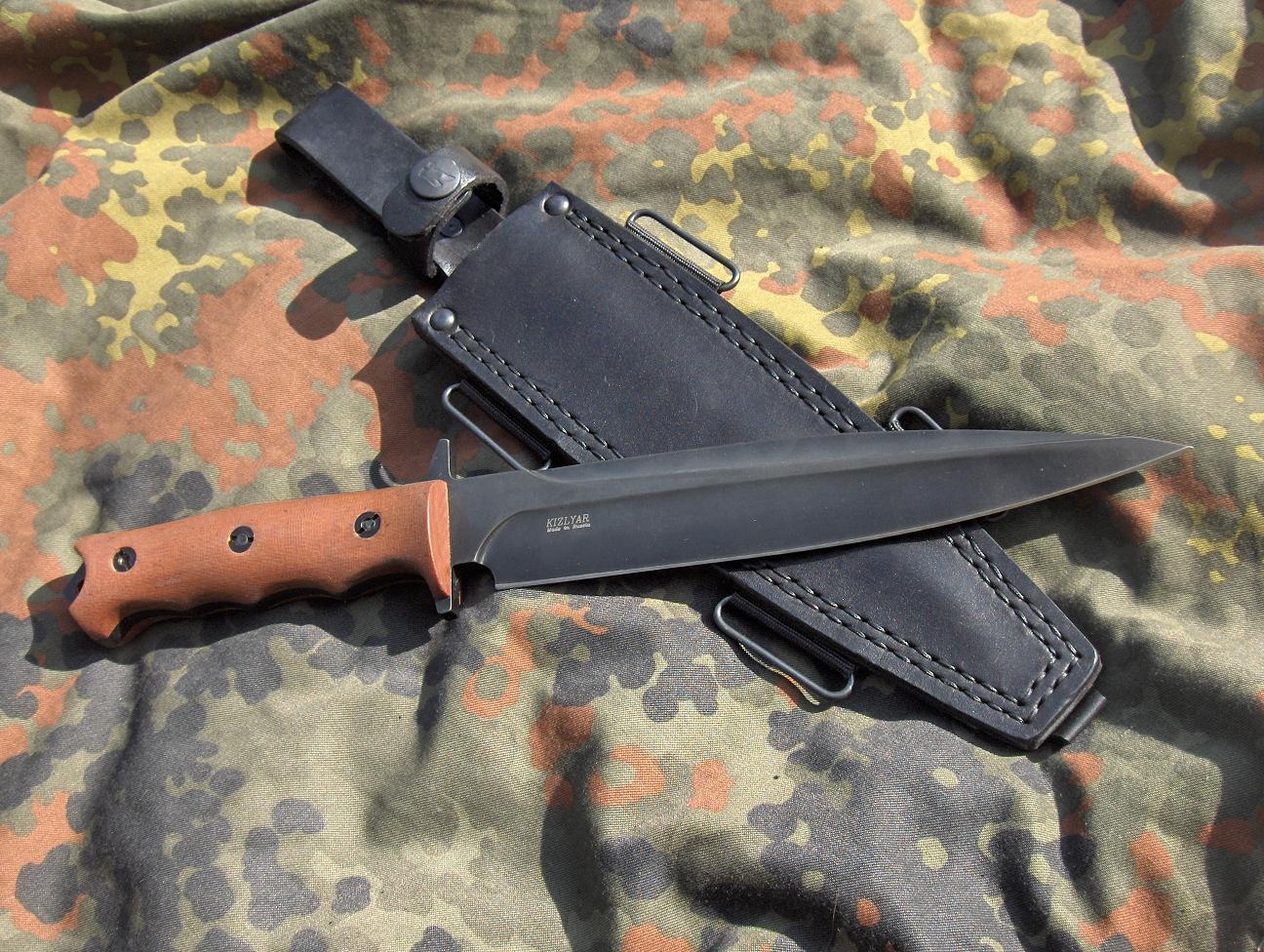

Here are some of the nex pheonix in carbon steel, ,
jenni has now a carton of these.
the handles are of textolite, the blades are u8a steel , this is a carbon tool steel.
they are zone tempered, the blade being 57-59 rockwell the back of the blade being 50 rockwell and the grip being 45 rockwell, the pommel spike is left harder, around 55-59 ,
(it is hard to control the hardness of such a small area)
the blade is now 7mm thick.
the grips are bolted on and can be reomved, the screws and nuts for this are brass and stainless steel. under the grip the tang has litening holes cut into it,

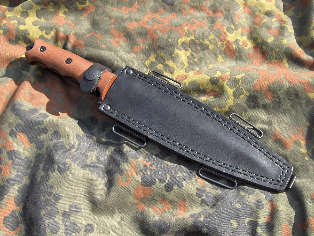

the sheath is heavy black leather, 4-5mm thick,
it is hand stitched with a double row of heavy nylon thread,
there is 4 large metal loops for leg straps and one smaller leather loop as at the end of the sheath for a tie down cord,
the belt loop is riveted on with 4 rivets for a good deal of security,

AW: neues "military" Pheonix!
Hi, Julius!
Fine to hear from You again - and amazing to see Your knives become better and better. This one could feel good in company with my other ones, except for the handle's colour :) .
It makes me very curious for the new DV. If that also gains as much as the Phoenix, it will be hard to withstand....
Regards!
Micha M.

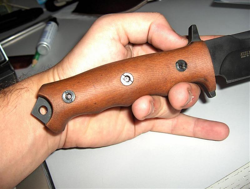

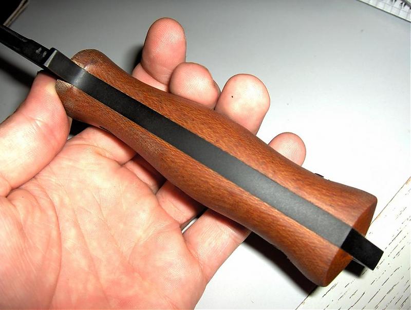

ok, here is the handle, the pictures are alittle crude, but you can see it clearly :)
handle is fitted to each knife before the blackening is done so the fit is perfect.

Das neue Phoenix I hat eine Gesamtlänge von: 340 mm, Klingenlänge: 210 mm, Klingenstärke: 7 mm, Klingenstahl:russischer U8a Kohlenstoffstahl, Schliff: Hohlschliff, Griffmaterial: Texolite, Scheide: handgenähte Lederscheide, das Gewicht beträgt ungefähr 380 gr.

Die Lederscheide ist zweireihig handgenäht und zusätzlich mit 2 Nieten versehen um ein Auftrennen der Naht beim Einführen des Messers zu verhindern.Der Hänger der Scheide ist mit 4 Nieten befestigt. Zusätzlich ermöglichen die 4 Ösen an der Scheide verschiedene Tragweisen.

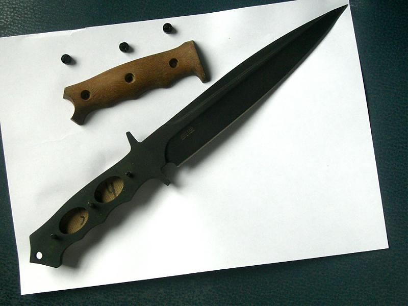

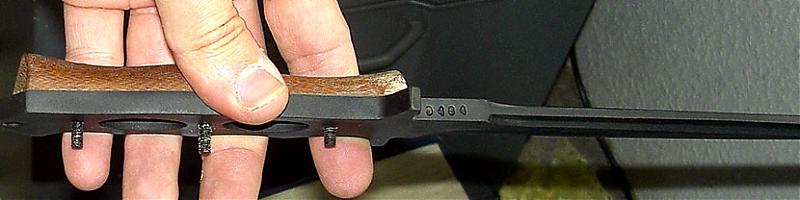

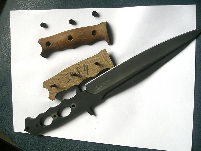

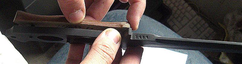

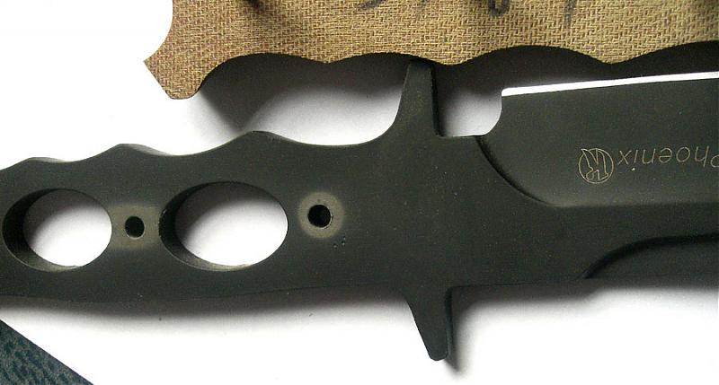

here is the knfie with the handle removed, you can see in one picture the hardness ses for the handle.
the holes are to reduce weight of the knife.
they are not to large as to make the handle to weak.
it is easy to remove, although one should use a special screwdriver they can be removed with a normal one, just cearfully.
the knife still feels decent in the hand with the handle removes, i think becuase of the thick blade,,
if one was inclined they could also remove the handle scales and put a "para cord" handle on it,,, although im no lover of paracord :teuflisch
