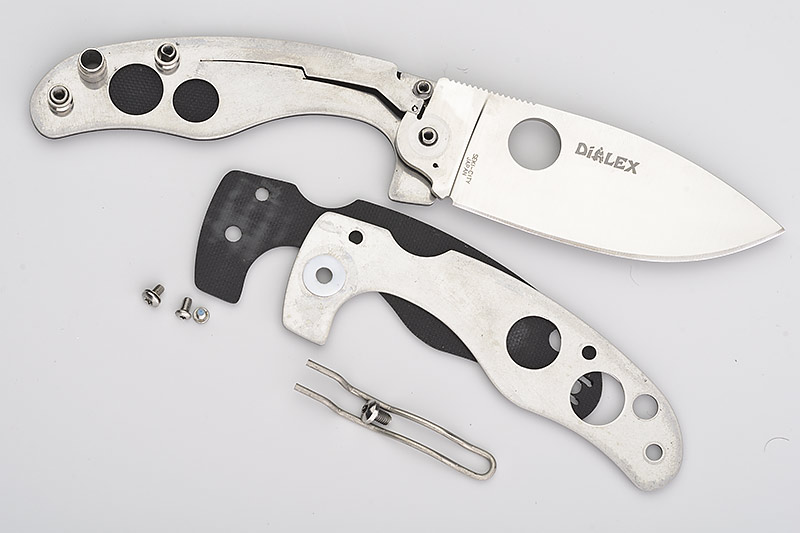

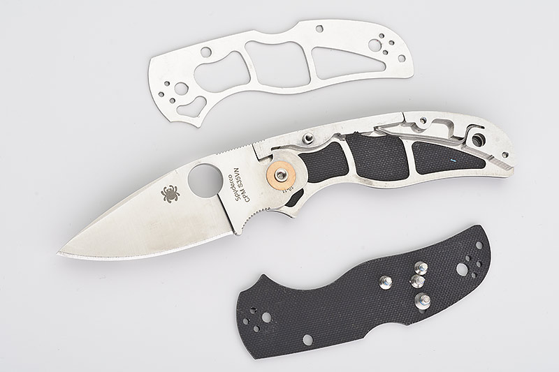

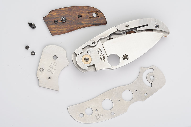

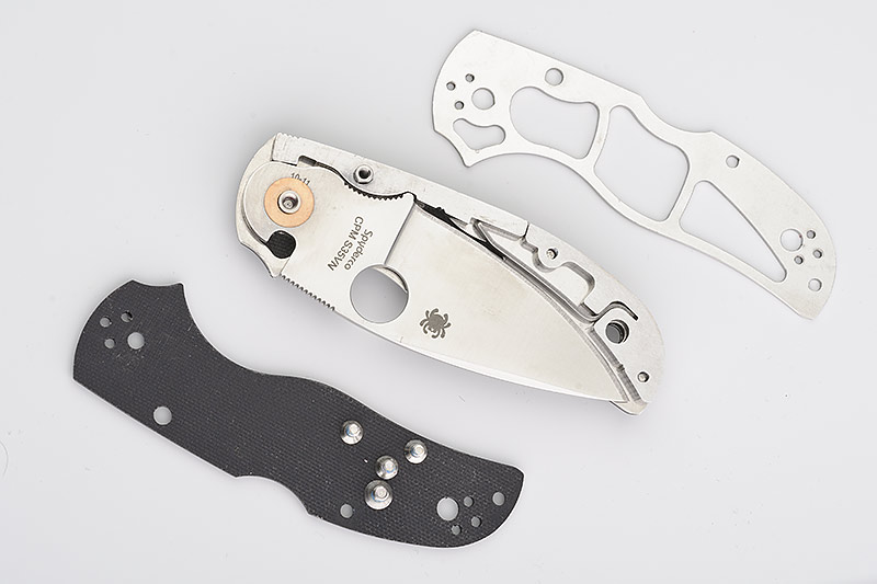

Mal wieder Bilder vom Aufschraubär
Der Verschluss beim Sage ist schon interessant - Backlock mit integriertem Anschlag.
Eric meint dazu:
"On the typical back lock the lock bar acts as both the stop in the open position and closed position, as well as hooks the blade to lock the blade open.
By adding the pin in the blade, it can act as both the stop in the open position, as well as a stop for the closed position. This means the lock bar primarily just hooks the blade to lock it open. We do this for a more consistent lock as well as solid lock-up."
