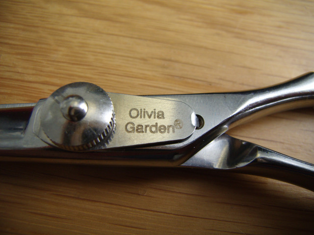

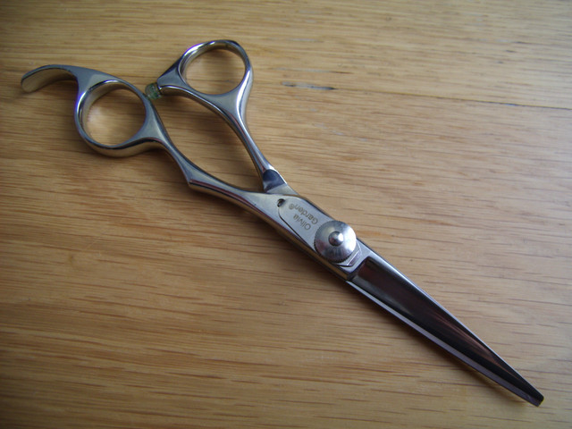

My nephews girlfriend is a hairdresser, and she asked me if i would try to sharpen her oldest pair of shears.
Years ago she had gotten it as a gift from her teacher, all this time had never been sharpened, and as a result it was so blunt that she didn't use it anymore.
Through Google i found that for 120 US dollars these shears seem to have a good price to quality ratio, so i thought that an attempt at sharpening might be worth it.
The edges were really quite bad, and as i had never done convex shears before i first had to think up a sharpening/polishing protocol that might work.
In the end i settled on 1000 grit SiC paper used with WD40 oil on glass, 15 micron diamond paste on the back of a narrow strip of SiC paper on glass, followed by 6 micron and 1 micron used the same way.
The hone line was repolished using only 1.0 micron diamond paste.
Just reassembled the shears again and the edges seem to work as they should, effortlessly cutting hair all the way to the point, but the real proof of the pudding is of course what the owner will think of it.
Will report back if i know more...

I did not completely understand how you worked on those convex sides. Forgive me, it might be just my lack of language proficiency.
You guys can write in much better English than i can write in German, aber Ich werde es mal auf Deutsch versuchen, :)
Die halb-convex geschliffene Scherenseiten habe Ich einfach erneut angeschliffen auf wasserfestes Silizium Karbid schleifpapier Kornung 1000 mit WD40 Öl als schmiermittel/SiC kornungschutz, geklemmt auf eine Glasplatte, so auf dieselbe Weise wie Ich das auch tue mit manche völlig convexe Messerklingen.
Das Unterschied war nur das Ich nicht nur am Ende, aber nach jeder Schleifvorgang (so nach Kornung 1000 Silizium Karbid, nach 15 micron Diamant, nach 6 micron Diamant, und nach 1.0 micron Diamant) ein Paar mal die "hone line" (die platt liegende hinterseite des Scherenblattes) über 1.0 micron Diamantpaste gezogen habe.
Das Ziel dabei war ein gleichzeitiges erschwächen von dem "burr" (nur am Ende verschwindet diese natürlich ganz) und jedes mal ein bisschen weiter polieren des "hone line".
Ich hoffe das erklärt was Ich getan hab etwas besser, aber wenn nicht einfach fragen.
Es ist schon mehr als 40 Jahre her das Ich ein bisschen von die schöne Deutsche Sprache in die Schule gelernt habe.
Und Ich verstehe was Du schreibst: nur die Friseurin kann beurteilen ob Ich es gut genug gemacht hab oder nicht, und Ich werde Ihr Urteil hier sicher mitteilen.

Got word from the owner, and she said that the shears are very sharp and they perform very well.
So far so good, now we wait and see how long these new edges will last in her use.
Last week the owner of the scissors (17-years old) dropped by my house with my nephew for a cup of tea, and informed me that she is still using them every working day.
According to her they're still very sharp and perfectly usable.
This seems to imply that my sharpening/polishing method is working, both for initial keenness and edge longevity.
Next i need to improve a bit in the speed department, while trying to maintain edge quality.
