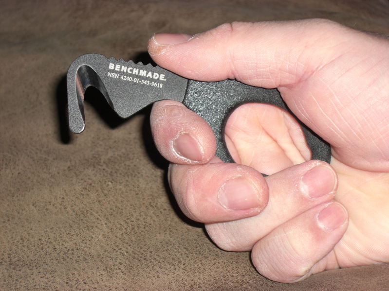

First of all I want to say thank you to Benchmade for supporting this passaround and giving us the chance to test the 7HOOK in practical use.
First impression:
The first time I saw the 7HOOK on the BM homepage I was not really thrilled. I am a fan of knives and so I never thought about a hook. But then I had the chance to lay my fingers on a 7HOOK (at the OutDoor 2008) and I was very impressed about the performance! And if you consider the new situation regarding the weapons law in Germany I thought such a hook may could a knife in some situations. Thats one of the reason I statred this passaround.

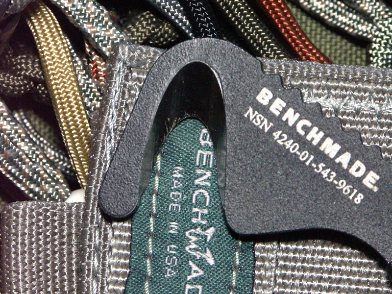

The processing of both the hook and the soft sheath is perfect ot of box. The sharpness was excellent - I tried to check the sharpness right out of box at the tip of my thumb and what shoud I say. There was no blood but I removed the top skin layer. I think this is very very sharp!!
Points: 10 of 10
Working experience:
I used the hook for cutting materials like polymer films (thikness 50µm - 250µm), cardboard box, leafes and branches of indoor plants. No really hard use but I used it very often what the coating on the backside doesn't like very much! I carried the hook at my belt what works very well in both directions horizontal and vertical carrying. Sometimes the seam of the sheath scratches the skin if you have direct contact so I had to make sure that the shirt is between the skin and the sheath.
The shape allows a perfect an precise handling of the hook. Due to the handle shape and the riffles on the top the hook allows a reliable grip. The only negative point I found was the thikness of the hook at the rounded tip. It was not possible to get in deeper layers of a furled polymer film. It would be better if the tip would be more narrow to get in between close layers.
Points: 7 of 10
Summary:
17 of 20 points is really a very good result. Nevertheless it is not a kife. The 7HOOK is a very good tool with high quality but it is not a full substitute for a blade. I woud say it is a very useful addition to a blad and as such I will use it.

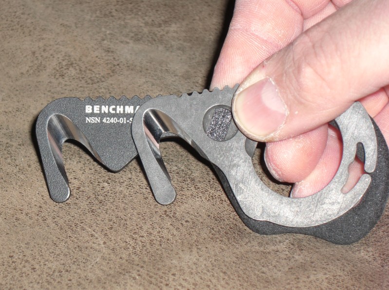

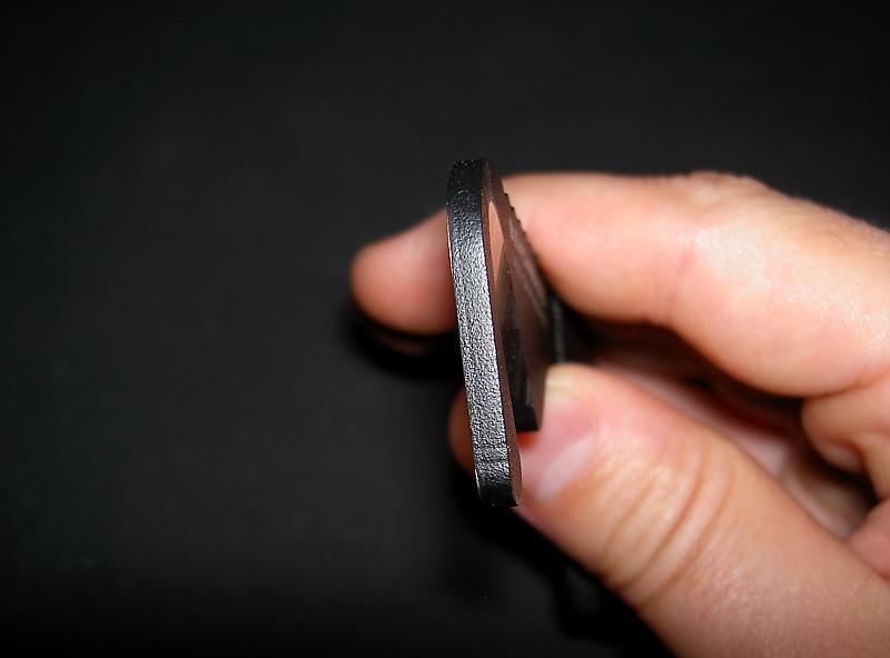

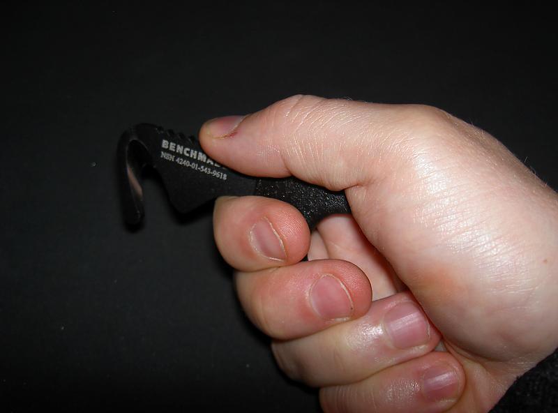

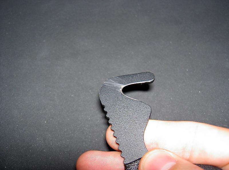

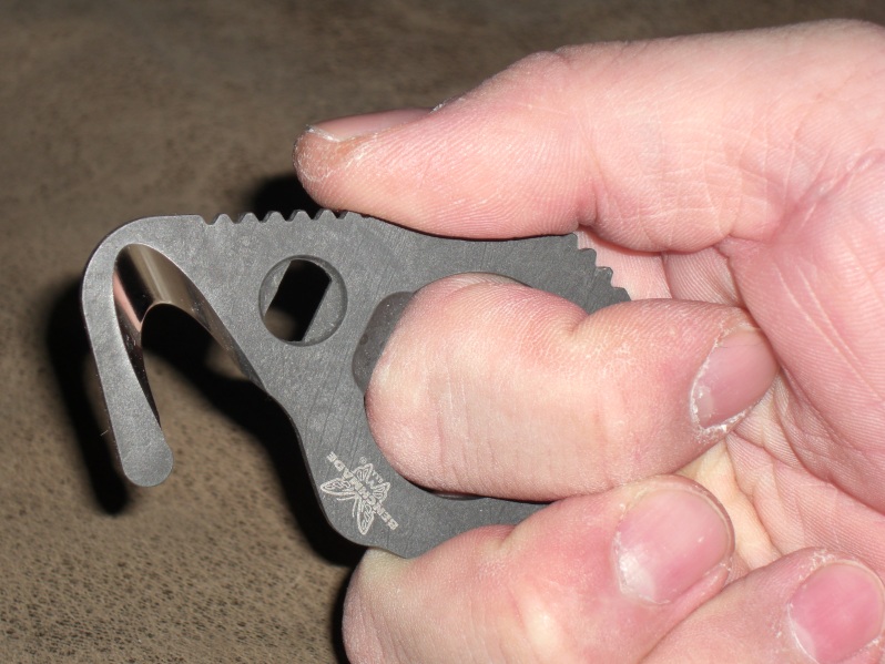

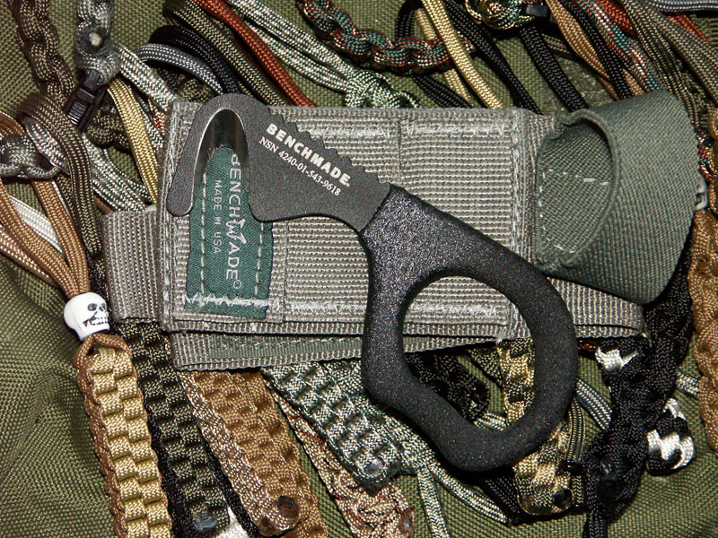

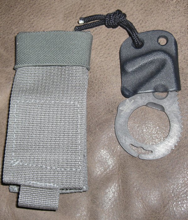

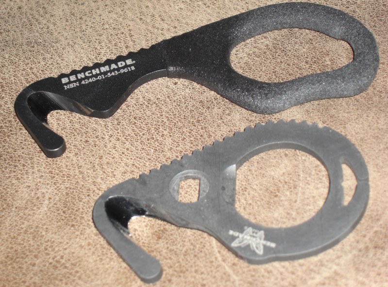

Here my little review for the BM 7Hook.

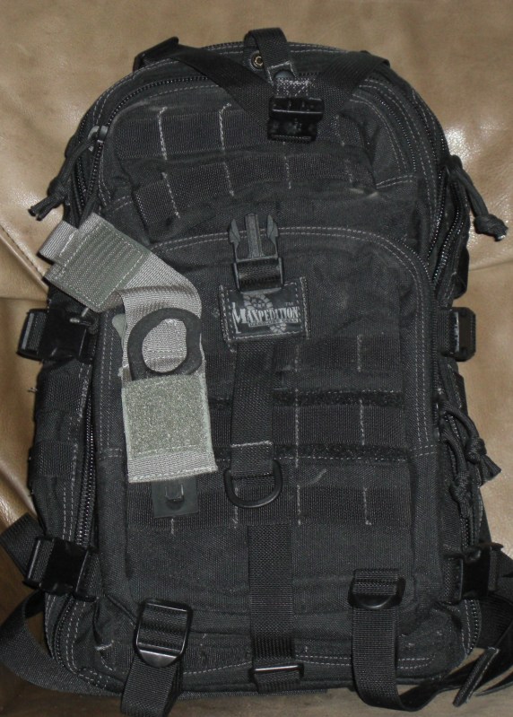

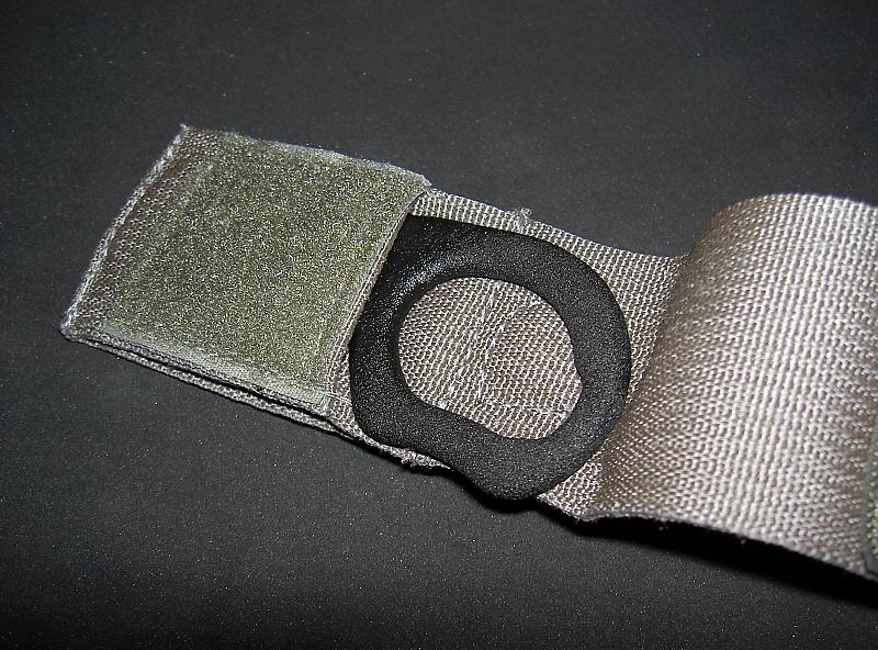

It cames in a softsheath with molle webbing on the back. the Sheath is well done. It keeps the 7Hook right in place.
The sheath is hold closed by velcro.
I would prefer a Kydex for carry the hook, on the backpack or in my car, for a quicker and secure release.

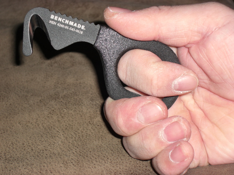

Now the 7Hook, it is an well made simple tool. It's only funktion is cutting: ropes, clothes, seatbelts...
It has a rounded tip, so you can't seriously hurt someone.
The grip is good but not realy comfortable (without gloves). The hole is to small for two of my fingers, and to wide for one. Only the grip without using the hole is ok. The neoprene-like cover feel warm and not slippy.
The coating of the hook is thick, but not tough as the black oxide coat like the BM5 rescuehook. But, it is a tool, so it doesn't have to win a beautycontest ;-)
The cutting skills are good, even some old jeans, cardboard or 10mm cord, no problem.
As box-opener it is a bit difficulty because the rounded tip is a disadvantage to get unter the tape.
For me, i'm no professional, I like the BM5 rescuehook more, because the size and the bottle-opener, I can take it as edc/edu.
As professional or for attachment in my car, I think I would prefer the 7hook with a kydex-sheath because it's better grip (with gloves).
Thank you Benchmade for the hook and Tobby for organizing the passaround.

Und heute morgen fiel mir gleich negativ auf das die rückseitigen Gürtelschlaufen zu schmal für nen Standardgürtel sind. Die sind wohl eher für Molleschlaufen oder ähnliches gedacht.
Hosentechnisch ist der Hook dann wohl nur hochkant zu tragen.

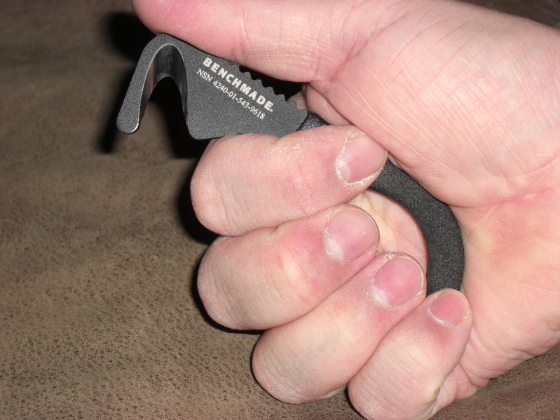

Zum Hook selbst:
Der Griff ist mit einem sehr griffigen Gummiüberzug versehn und damit äusserst rutschsicher.
Zur Handlage werd ich mit dem Ding nicht richtig warm, vielleicht hab ich auch zu kleine Hände. Am Besten greift es sich für mich wenn ich die Finger aus dem Griffloch draussen lasse.

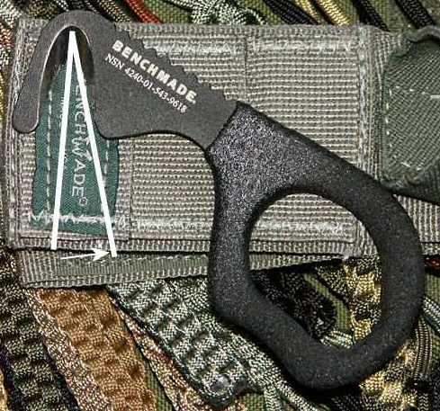

Hallo, ich bin mein Review noch schuldig:
Das Konzept dieser Rettungshaken hat mich interessiert, deshalb habe ich am Passaround teilgenommen.
Der RescueHook7 ist wie die Scheide gut verarbeitet, nur die Riffelung am Rücken war mir etwas zu grob. Die Kanten hätten runder sein können.
Geschnitten habe ich mit dem Haken Papier, Seil, Sicherheitsgurt, Jeans und ein Paket habe ich auch geöffnet. Funktioniert hat der Haken dabei akzeptabel, mit einem Messer oder einer Schere geht es einfach besser. Gut, das soll keine Kritik sein, es ist ja ein Werkzeug für den Notfall. Dafür ist eine weitere Gefährdung zB. eines Verletzten durch den Haken nahezu ausgeschlossen.
Die Handlage ist gut, solange man den Griff komplett umfaßt. Der Winkel der Schneide zum Griff könnte allerdings etwas flacher sein. (Siehe Bild, das hab ich bei kanji geborgt, da ich selbst leider keine machen konnte)
Das würde meiner Meinung nach das Führen beim Schneiden etwas erleichtern.
Das Loch im Griff würde ich nur dann benutzen, wenn die Gefahr des Verlusts besteht, also im wirklichen Notfall, da wenn der Haken so gegriffen wird (Zeigefinger durchs Loch, für mehrere Finger ist das Loch zu klein) das Schneiden mit dem Haken recht kompliziert wird. Wenn das Loch etwas größer wäre, könnte man mit zwei Fingern durchgefaßt besser schneiden.
Fazit: Wenn ein kleines Schneidwerkzeug benötigt wird, das man für den Notfall am Mann oder zB. im Auto leicht zugänglich anbringen kann, ist so ein Haken nicht schlecht. Man sollte bei diesem Modell vorher allerdings etwas üben.
MFG Martin

I have a BM Hook 5 and I carry it every day at work. For this hook I`ve got a kydex with a tek lok. So I can carry him at my belt and my harness.
The hook 7 has only a nylon-sheet and it doesn`t fit with my dutybelt or my harness.
The next point is the handling. The grip at the part with the rubber is very good, especially with gloves. But for my Opinion the hook is a little bit to large. The size of the BM5 is better. I have small hands (size 7-8) and so the handling with the BM5 is better than the handling with the BM7.
The sharpness was not so good, but it was easy to cut a safetybelt from a car. To cut a climbingrope (10mm) was much harder, but it works.
I think the BM7 is a good tool to carry it in a car. The smaller BM5 is better as an EDC.
