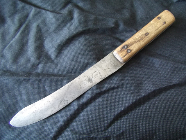

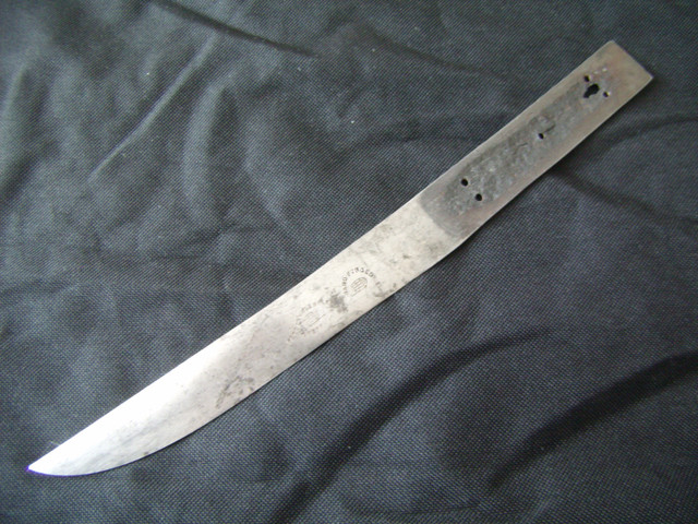

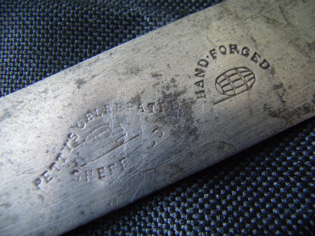

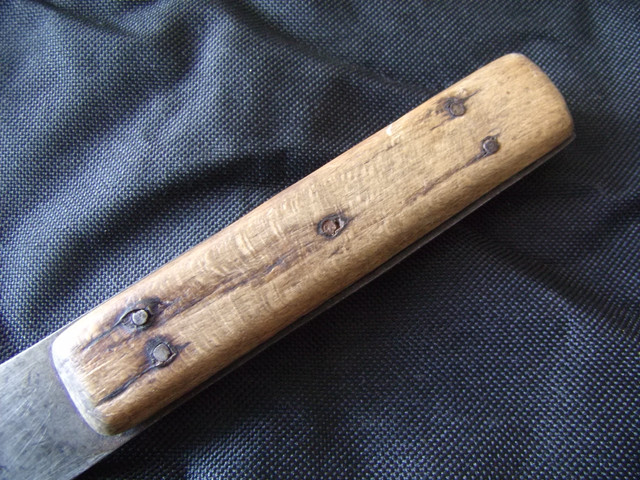

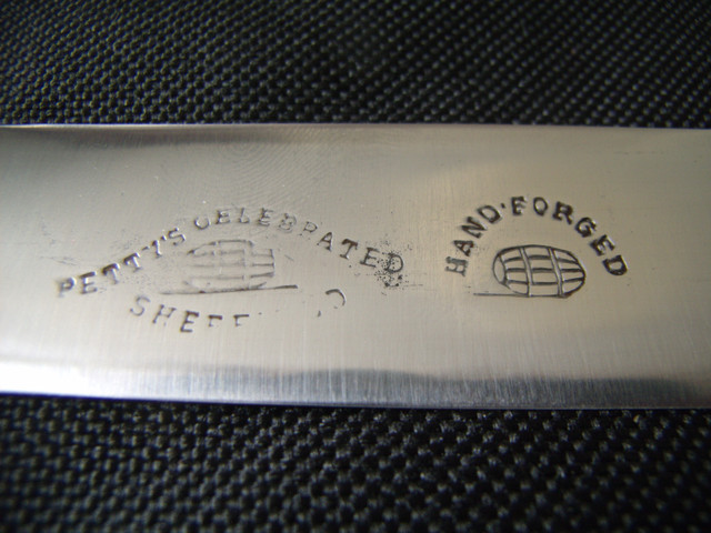

Another thrift shop find is this old butcher's knife, made by John Petty & Sons Ltd in Sheffield.

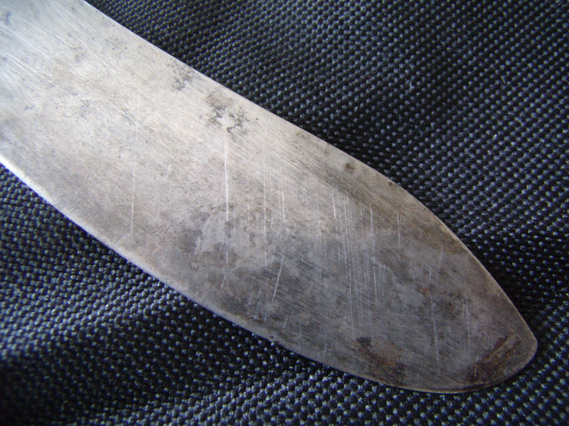

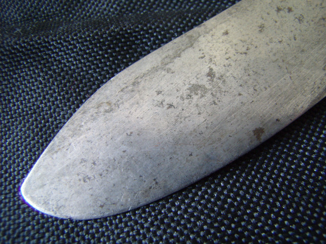

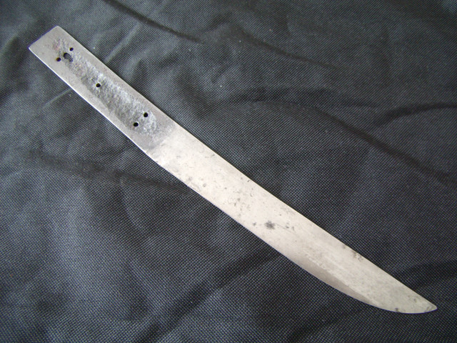

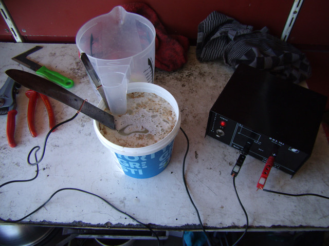

The blade is most likely shear steel, and the plan is to make the knife at least functional again.

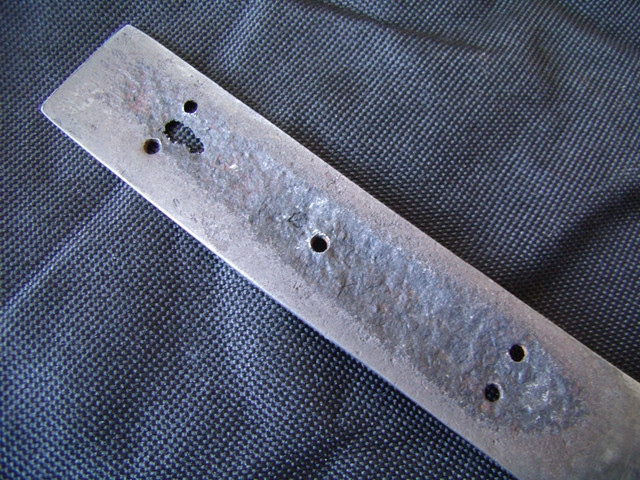

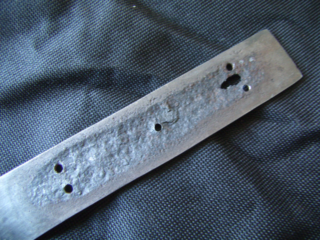

I think you're very lucky that the rust below the handles still left some metal, and didn't leave just a big hole.

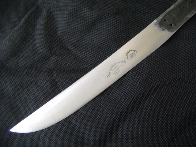

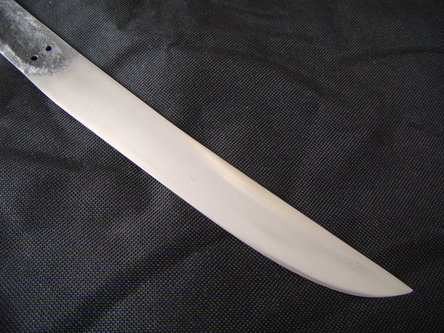

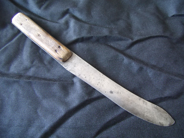

This is how the blade looks now, as for me this is a more useful blade shape.
I'm also starting to think the metal isn't shear steel but instead double shear steel.

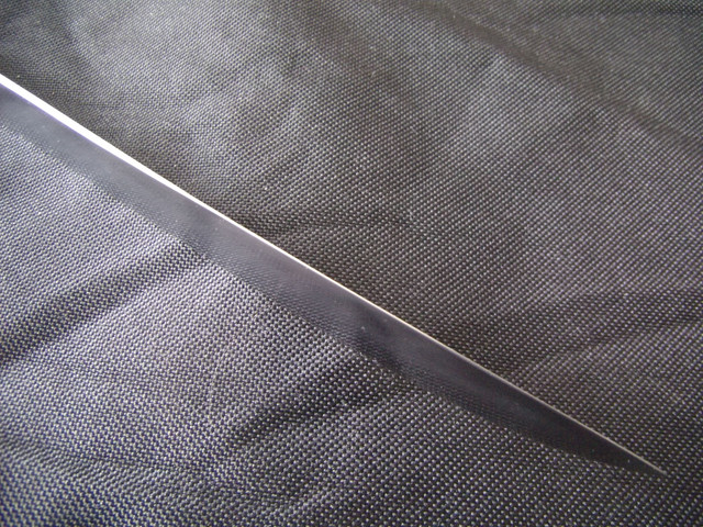

After hand regrinding up to 400 grit wet & dry. (burr is still attached)
To optimize cutting performance the blade now has a full convex shape with long swedge & an edge angle at ~20 degrees inclusive.

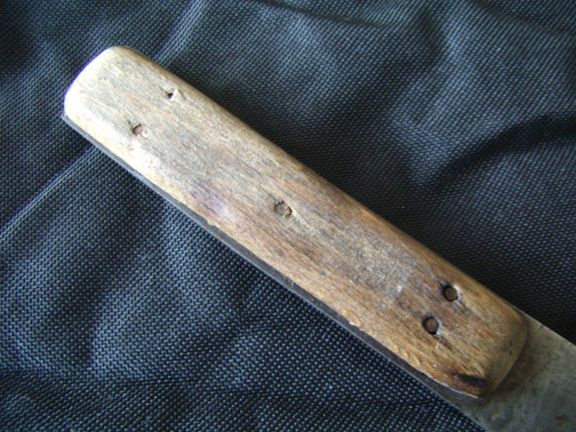

I still have to make a new handle for it, but at the moment i'm unable to do that.
A few years ago i won the jackpot regarding eye problems, and as a result my sight has deteriorated quite a bit.
