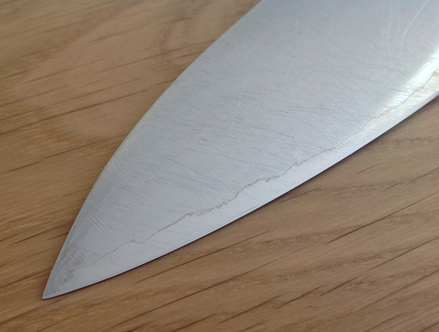

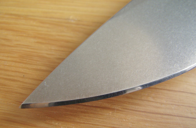

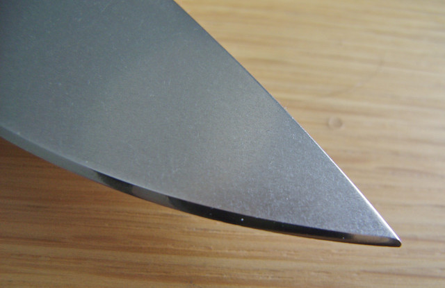

This special version of the Spyderco Paramilitary 2 in CPM-M4 steel & carbon fiber is in use with a Dutch knife forum member.
A small fraction of the tip had broken off and the apex sustained some damage (see pic 3)
This is how the knife looked before sharpening.
You can click 2 X on each pic for more detail.

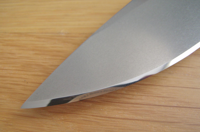

After sharpening.
First i ground the old apex flat on the Tormek Blackstone until all damage in the apex was gone & there was a new point.
Then i made a new edge with 15 micron diamond compound on a Paper Wheel, which was then refined with 6, 3, and 1 micron diamond compound on dedicated Paper Wheels to a full mirror.
The new edge measures 30 degrees inclusive and is hairwhittling sharp.

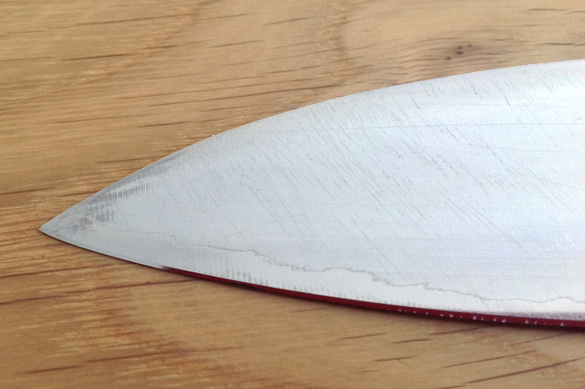

The owner of this Maxamet PM2 had given his knife a forced patina treatment, and besides coming out a bit uneven the acid had also completely eaten away the factory apex as well as the very tip of the blade.
To say that the knife was completely blunt would have been an understatement.
The request was to give the knife a new toothy edge with a lot of bite while making it as sharp as possible.
(You can click each pic 2 X for a bit more detail)
Before sharpening:
After sharpening

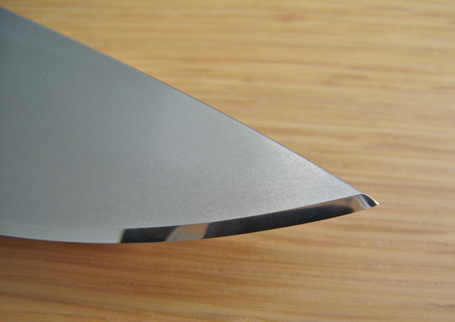

Flattened the acid damaged "apex" some more on a 3000 grit diamond plate so i could start with fresh steel, then made a new edge on a Rubber Wheel coated with +/- 230 grit diamond powder & wax, then deburred on a Paper Wheel with 1.0 micron diamond paste & oil.
The new edge is ever so slightly convex, the new apex fits almost exactly in the 30 degree inclusive slot of my Tormek WM200 Angle Master, plus it can whittle one of my chest hairs at about 5.5 centimeters from the point of holding. (i don't own a BESS tester)
The somewhat "fuzzy" shoulders of the new edge show how deep the acid has eaten away into the sides of the blade in some area's.

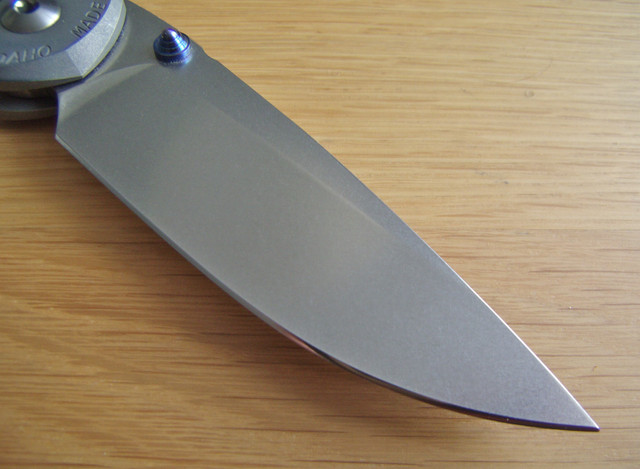

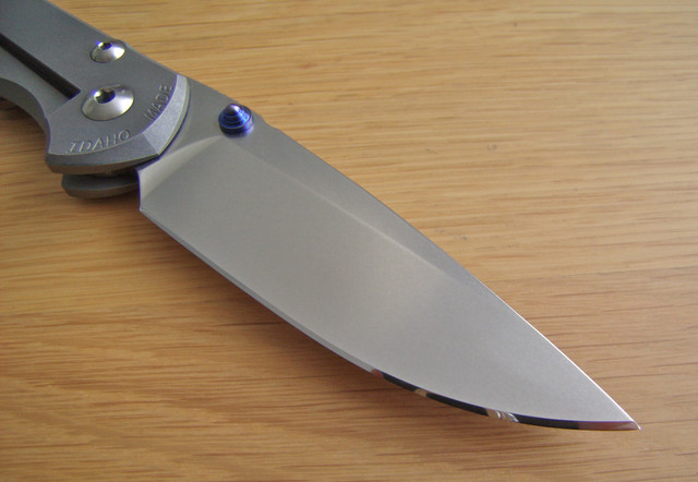

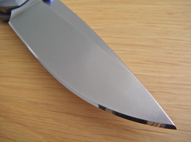

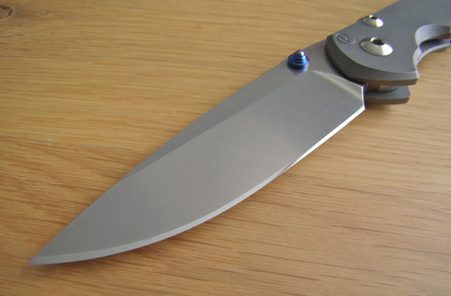

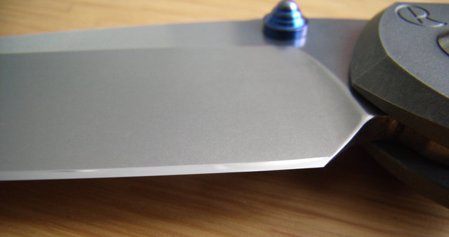

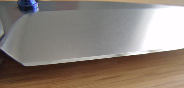

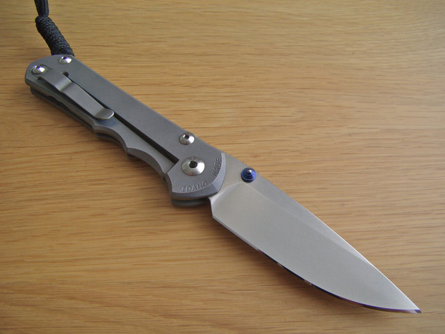

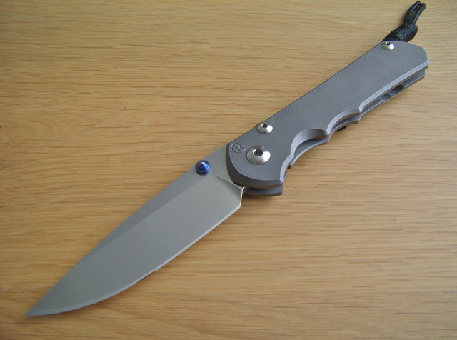

The owner of this Sebenza 25 bought the knife brand new from a dealer in the Netherlands, but although he was and is still very pleased with the knife itself, he soon found that the factory edge didn't cut too well.
He tried to improve things with the help of a Spyderco Sharpmaker and a leather strop loaded with some green compound, but to no avail.
So he sent the knife to me, and the first thing i did was to measure the edge angle with my Tormek WM200 Angle Master.
According to this device the edge measured 50 degrees inclusive on the straight part of the edge, going up to 55 degrees inclusive from the belly to the point.(!)
This is how the knife looked before sharpening:
First i removed the apex of the old edge by cutting a few times lightly at a 90 degrees angle into an old silicon carbide stone, after which i reprofiled the edge freehand on my Tormek SB-250 Blackstone to an even 30 degrees inclusive.
This was followed by a Paper Wheel with 220 grit SiC to smoothen the grindlines made by the Tormek, then refined with a second Paper Wheel coated with 15 micron diamond compound, and finally removed the burr with a third Paper Wheel coated with 0.25 diamond compound. (this leaves the 15 micron scratch pattern intact as much as possible to preserve bite)
The resulting edge treetops the hair on the back of my hand, can slice single-ply toilet paper, and survives a few cuts into my laminated testblock without any visible damage (checked under bright light with the loupe in my Victorinox SwissChamp)
This is how the knife looks after sharpening:

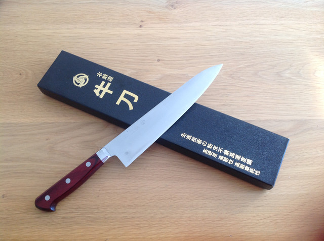

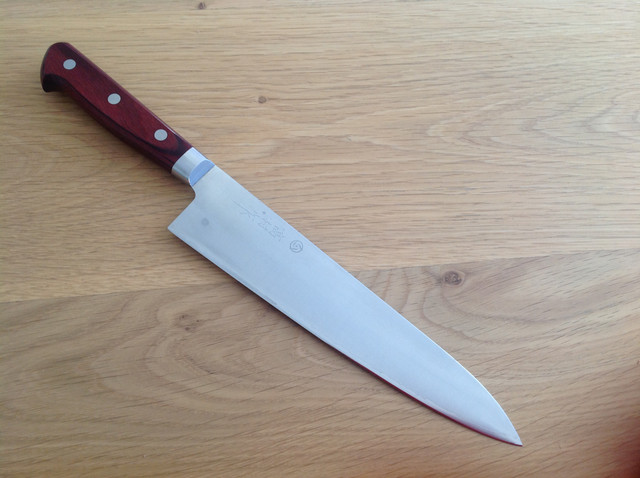

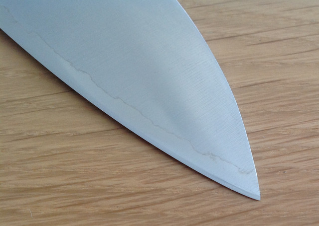

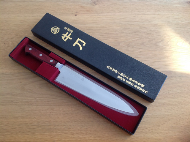

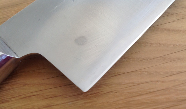

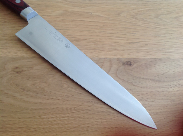

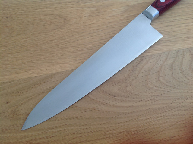

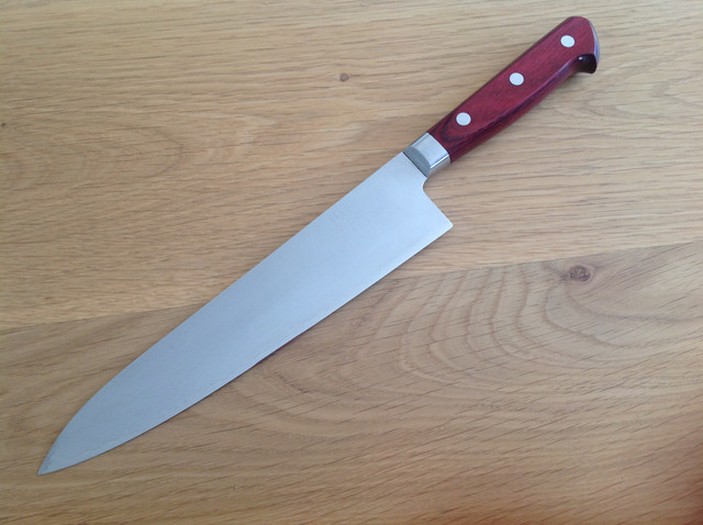

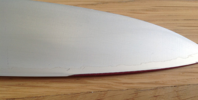

Right hand Takamura R2 Gyuto 210 mm from a local Chef, who got it as a birthday present from his wife.
The knife has already been used for two months in the commercial kitchen and it was time for it's first resharpening, which i did yesterday on a Paper Wheel with 15 micron diamond compound and then deburred on a second Paper Wheel with 0.25 micron diamond compound.
The idea was to make an edge that would do both slicing & pushcutting well, and also to remove as little steel as possible from the fine and thin R2/SG2 blade @ 63-64 HRC.

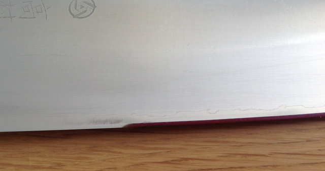

The new edge measures +/- 20 degrees inclusive and can whittle a chest hair from root-to-tip at about 4 centimeters from the point of holding, and after a few test cuts into a old piece of beechwood cutting board.
I took these pics with an old Ipad and actually wanted to erase them again as being not good enough until i enlarged the last picture twice.
At first i thought i saw small dirt spots on the new bevel, but those tiny white specks were actually the sliced off peaks of the micro-dot structure on the inside of the flimsy plastic blade protector sleeve.

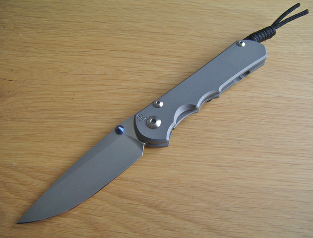

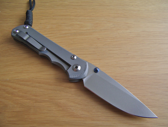

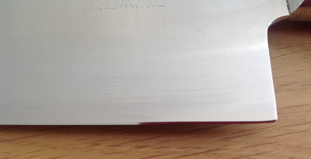

Some time ago one of the Chefs i sharpen kitchen knives for decided to treat himself to a brand new Sebenza 25 from a well known Dutch knife shop.
As many here know the Sebenza is a beautifully designed & manufactured knife, and the model 25 is no exception.
Sadly the factory edge on the first example the Chef got to handle was just plain blunt, and upon inspection it turned out that the other 4 or 5 Sebenza's 25 that the shop had in stock suffered from a comparable bluntness.
To cut a long story short: in the end the Chef liked the knife so much that he just bought the least blunt one, while the shop assistant promised to contact CRK to see if the other knives could be sent back.
The day after buying the knife the Chef visited me to ask if i could do something about the edge.
The first thing i noticed about the blade on his model 25 is that it seemed to be ground a hair thinner behind the edge compared to previous Sebenza's 25 that i've handled and sharpened, and that as a result the edge bevels were quite narrow, even with a measured inclusive edge angle of 35 degrees.
The second thing i noticed (with my Victorinox loupe) was that the edge reflected light almost along it's entire length, and i couldn't even cut a piece of copy paper with it.
I think that the edge wasn't completely apexed, but with only my loupe to judge by i'm not 100 % sure.
In a conversation with the owner and also because the knife was brand new we came to the conclusion to give it a new edge that would resemble the factory edge as much as possible, and to make it seem as best as i could that nothing was done to the knife.
First i removed the blunt apex of the factory edge by cutting several times into a silicon carbide stone, after which i gave it a completely new edge with an experimental Rubber Wheel coated with 230 grit diamond powder & wax, after which i removed the tiny burr with a Paper Wheel with 1 micron diamond compound.
The new edge again measured 35 degrees inclusive from heel to tip, survived a few cuts into my laminated test block without visible damage to the apex, which could then still easily treetop the hair on the back of my hand.
And most importantly, the Chef was happy with how his new knife turned out,
Before sharpening:
After sharpening:

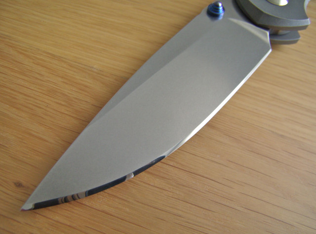

A Strider SMF with S110V blade from a Dutch forum member.
According to my Tormek angle gauge the old edge measured +/- 40 degrees inclusive from the heel to half an inch before the tip where it changed into 45 degrees inclusive.
The owner uses this knife mostly to cut various kinds of green wood & twigs in horticulture, and had already tried his hand at reprofiling the edge himself with a DMT Diafold.
Together we came to the conclusion that the edge could do with a full reprofiling, as well as with a finer edge finish to better suit his specific purposes.
BTW: the owner also contacted Duane Dwyer by mail, among other things to ask him about the hardness of this S110V blade, and according to Duane it measures 61 HRC.
This was the knife before sharpening:
After reprofiling & sharpening.
The new edge angle came out at +/- 32 degrees inclusive along the entire edge, and it can treetop armhair and slice single ply toilet paper.
Probably due to having the flu at the moment my hands didn't do exactly what i wanted them to do, and as a result i didn't manage to get both bevels completely symmetrical.
Grit progression: a Paper Wheel with 220 grit SiC for reprofiling, a second Paper Wheel with 15 micron diamond compound for refining, and a third Paper Wheel with 0.25 micron diamond compound for removing the tiny burr.
