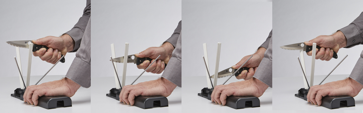

With regard to the sharpening of serrations, Sal specifically designed the Tri-Angle Sharpmaker® to sharpen PlainEdge, partially serrated CombinationEdge™, and fully serrated SpyderEdge™ blades with equal ease. In the process, he also created one of the very few sharpeners on the market that also puts an edge on hawkbills, recurves, tantos, Reverse “S” blades, and virtually any other edge profile with no significant change to your technique. By doing the same basic thing, you get an amazingly sharp edge, no matter what the blade shape.
To sharpen a serrated edge on the Sharpmaker, the secret is to use a slightly looser grip and to go slowly. This allows the edge to remain in contact with the rounded corners of the stones along its entire length, flowing in and out of every serration scallop instead of “chattering” across the ridges of the teeth. To maintain the integrity of the beveled side of the serration, it works best to use a ratio of three strokes on the bevel side to a single stroke on the unbeveled side, which removes the burr at the edge.

Serrations are made by grinding the edge of the blade with a formed wheel. The wheel is formed in the shape of the serrations. Each time a blade is serrated, there is a little wear on the wheel. After 40-50 blades, the wheel must be re-formed as its shape changes, so no two serrations are exactly the same. Each maker has their own ideas of how to make the serrations even though we show them what we would like. By making the serrations more pointed, the wheel can be re-formed less often. However, in my opinion, if the serrations are "too pointy,” they tend to snag. When I get a new serrated knife, I sharpen the serrations on the Sharpmaker. I use 30 degrees and 3/1 ratio with the non-ground side almost flat to the stone.
In my opinion, the best serrations are the result of proper sharpening on the Sharpmaker using the methods that I show on the Sharpmaker video. Using the Sharpmaker as I instruct, the tips become slightly rounded, the inside of the serrations are sharp, micro-beveled, and the cutting performance is more effective. I should mention that others have other opinions on the way serrations should be and how to sharpen them.
