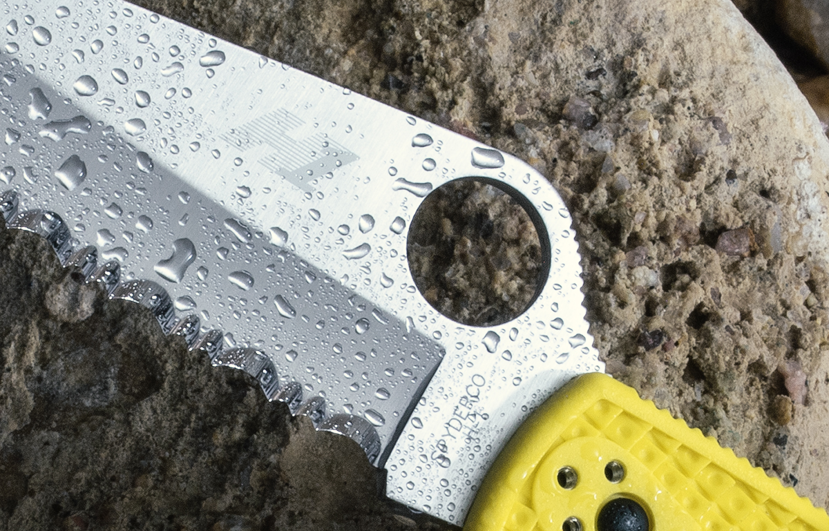

H-1:​
The original Salt Series steel, H-1, was developed by Myodo Corporation in Japan. H-1 is an austenitic steel, which means it does not go through the traditional hardening and tempering processes of martensitic steels. Its unique alloy composition includes chromium, manganese, molybdenum, nickel, nitrogen, phosphorus, and only minimal amounts of carbon. This combination of elements allows it to be precipitation hardened during production. Also called age hardening, this process uses controlled heat to increase the tensile and yield strength of the material.
The real secret to H-1’s hardness, however, is the transformation of its retained austenite to hard martensite through the rolling of the steel. It begins as a 7mm-thick sheet and is progressively rolled down to the required finished thickness—typically 3.0mm or 2.5mm, depending upon the Spyderco model. The extreme compressive forces of this rolling process transform some of the steel’s austenite to hard martensite, increasing the overall hardness of the material without sacrificing its toughness or corrosion resistance. The result is a blade that holds an edge reasonably well, is incredibly strong and flexible, and offers extreme resistance to corrosion.
The disadvantage of H-1 is that it does not achieve the same degree of hardness as martensitic blade steels, so it offers less edge retention—especially in a PlainEdge configuration. For this reason, H-1 performs best in fully serrated SpyderEdge blades. Its unique properties also require H-1 blades to be hollow ground during production.
Currently, the only knives still in production using H-1 are Spyderco’s original Autonomy™ automatics. Once the steel for these knives is exhausted, they, like other H-1 models, will be transitioned to H-2.
