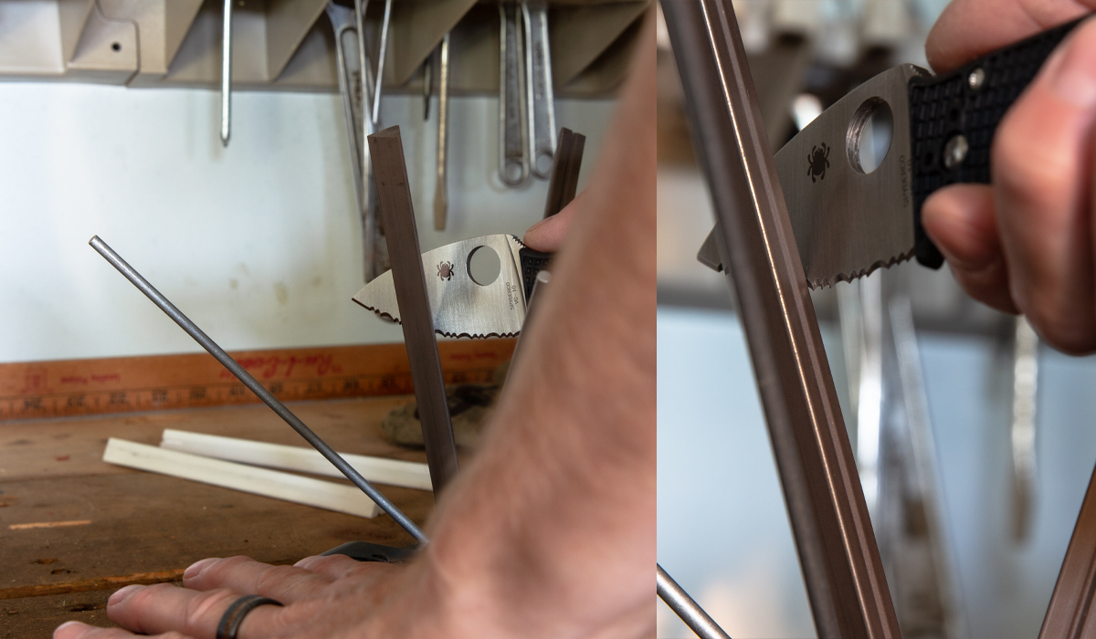

Serrated Sharpening Technique​
Before you begin sharpening a serrated knife, examine the edge closely. Most likely, you’ll find the terminal edge bevel (the bevel that creates the actual cutting edge) is only ground on one side of the blade. This is the “bevel side” of the edge. For most Spyderco knives, this is typically on the “obverse” side of the blade, or the left side when looking at the knife held edge down, point away from you.
To set up your Spyderco sharpener, insert the abrasive rods into the holes in the base so one of their edges faces inward toward the center of the “V.” Place the sharpener on a sturdy table or countertop at about waist level and stand squarely in front of it. With your non-dominant hand, apply firm downward pressure to hold the sharpener in place (or, with the Galley-V, ensure that it is securely clamped or mounted to the surface). Grip the knife in your dominant hand with your thumb on the top of the handle or the spine of the blade and the plane of the blade vertical. Keeping the plane of the blade vertical, place the “heel” of the bevel side of the edge (the base of the edge closest to the handle) against the sharpening rod on that side of the knife. While applying constant, light pressure (about three pounds or so), draw the edge of the knife down the rod as you simultaneously pull the knife toward you. Go slowly and adjust the tension of your grip so the entire cutting edge remains in contact with the sharpening rod throughout the stroke. The goal is to allow the narrow, radiused edge of the rod to flow in and out of each serration scallop without chattering.
Repeat this process three times on the bevel side of the edge. This will reinforce the geometry of the serrations on that side and produce a slight “burr” on the opposite side of the edge. To remove that burr, move the knife to the opposite abrasive rod and make a single stroke against it. Again, keep the plane of the blade vertical, apply constant, light pressure, and draw the edge down the rod as you pull the knife toward you.
Return to the first rod and repeat the process again, alternating between the rods until you’ve completed five “sets” of three-to-one strokes. Examine your edge and if you have not yet achieved the desired degree of sharpness, repeat the process. It’s that simple.
