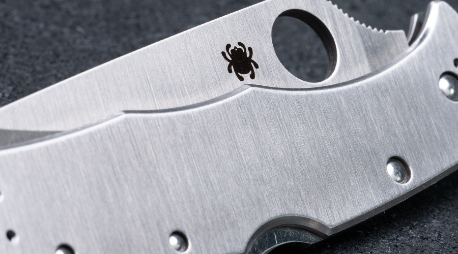

Smooth​
Spyderco’s earliest knives featured smooth, satin-finished stainless steel handles. This style of handle construction offers heft and a classic look but relies primarily on the handle’s shape to ensure a secure grip. Smooth-finished scales also offer a clean, traditional look and are often used to highlight unique handle materials, like our Chaparral models with Birdseye Maple and Raffir® Noble scales.
