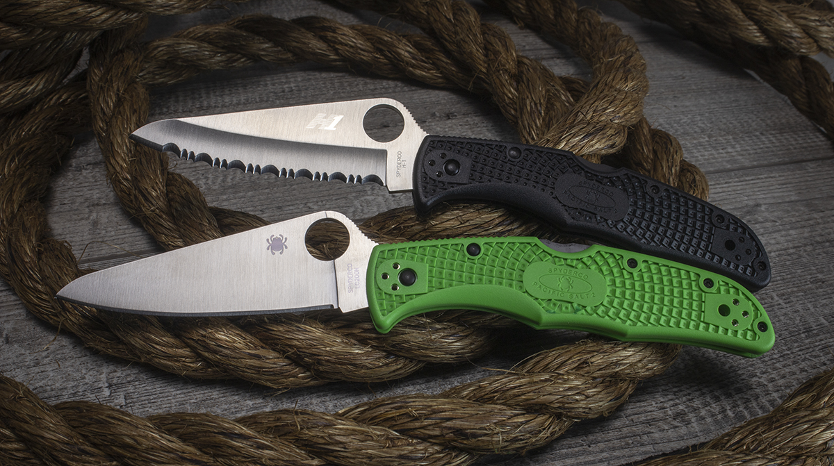

Conversely, H-1 blades with fully serrated SpyderEdge™ blades turned out to be outstanding performers. In Sal’s words, “The serrated H-1, such as the Jumpmaster™, in CATRA tests, have shown to be exceptional, with better performance than plain or serrated steels of any that we've tested. Field tests have shown this to be true as well.” This statement is also backed by more than a decade of customer feedback praising the cutting performance and edge-retention properties of our serrated H-1 blades.
LC200N​
As remarkable as H-1 is, we realized that, in the PlainEdge format, it does not offer the same edge retention as conventional martensitic steels. Although it still makes an extremely serviceable cutting tool, in that edge configuration it requires more frequent sharpening. Consistent with our obsession with Constant Quality Improvement (C.Q.I.), we therefore began exploring other exotic corrosion-resistant alloys for use in the Salt Series.
One material that showed tremendous promise was LC200N. Also known as Cronidur 30 and Z-FiNit, LC200N is a state-of-the-art, high-nitrogen alloyed tool steel specifically formulated to offer superior corrosion resistance and extreme toughness, even at high levels of hardness. The advanced processes used to produce this steel give it a fine, homogenous microstructure and allow it to be readily machined and polished. Its unique qualities make it the material of choice for applications that involve high static and dynamic loads in corrosive environments, and it is actually used by NASA for the ball bearings used in aerospace equipment.
Based on these unique qualities, LC200N was the perfect addition to the Salt Series. Since it is a martensitic steel and achieves its hardness through conventional heat treating, it can achieve a better edge hardness than H-1 in a PlainEdge format. For PlainEdge fans seeking extreme corrosion resistance and superior edge retention, it’s the perfect solution.
LC200N also offers the advantage that it can be full-flat ground in production. Because of its work-hardening properties, the process of grinding H-1 blades without warping is extremely challenging. For this reason, the blades of H-1 knives are simultaneously hollow ground from both sides to equalize the stresses in the steel. LC200N, however, doesn’t present this challenge and can be readily flat ground using standard methods. A full-flat grind creates low-friction edge geometry that further enhances cutting performance. It also reduces the overall weight of the knife and refines its balance in the hand.
