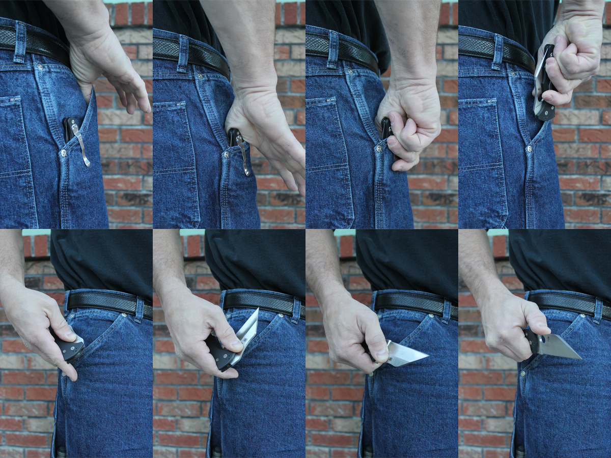

Drawing and opening a knife configured for tip-down carry generally works like this: Drive your thumb into your pocket between the knife and your body as you grip the outer surface of the clip with your index and middle fingers. Using a pinch grip, lift the knife up out of your pocket and rotate the handle into your hand. This will leave your thumb positioned very close to the blade’s Trademark Round Hole so the full extension of your thumb will open the blade fully. Using the tips of your fingers to anchor the handle to the top of your palm (at the base of your fingers), index your thumb in the blade hole and drive straight forward to open the blade.
Another reason early Spyderco knives were tip-down carry was that this carry position also facilitates an alternate opening method. Sometimes called the “Spydie Drop,” it involves pinch gripping the blade’s Round Hole, drawing the knife, pointing the handle butt upward, and then swinging the handle down to open the blade. Once open, you reposition the knife in your hand to achieve a using grip. Although shown in the classic out-of-print book The Spyderco Story and still widely used by old-school Spyderco users, this method is no longer formally recommended as it affords less positive control over the knife during the opening process. Nevertheless, the Spydie Drop also did not discriminate based on hand size.

To draw and open a knife carried in the tip-up position, first drive your thumb as deep as possible into your pocket between the knife and your body. Grip the outer surface of the clip with your index and middle fingers and apply a pinch grip on the handle using as much surface area of your thumb as possible. Maintaining this grip, lift the knife up out of your pocket. Your thumb should already be positioned very close to the blade’s Round Hole. Using the tips of your fingers to anchor the handle to the top of your palm (at the base of your fingers), index your thumb in the blade hole and drive straight forward to open the blade fully. Then assume a using grip.
