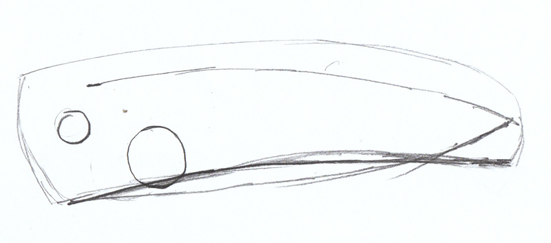

If we make the model so it cannot be opened with one hand (easily tested by the police), then it shouldn't be a problem.
I think You are right.
And I understand - we started the German Penknife Thread long time ago with these words - it needs to have a round hole in the blade. That is important for Spyderco.
My idea I supposed earlier in a sketch: Whatever the handle or blade may look like in the end, the hole may be (partially) covered by the scales. Moving the hole to the blade's front may effect the force to open the knife.
Hi Type,
It's a good idea and might work also with a small hole.
Using a large hole and submersing the hole in the handle leaves little room for a lock. It would have to be a very wide blade. Also, we have to leave enough blade exposed to be able to grab the blade with the thumb and index finger to open with two hands. I would prefer to avoid a nail nick if possible.
sal
It is possible to do such large holes with a lock (c.f. BM Ally); as I mentioned: move it to the point of the knife. Adding a nail nick to a covered hole isn't that hard, too. I wanted to show, that the hole may not be part of the opening action, but as you stated, a (trademarked) design element.
Hi Typo,
The BM is a linerlock. less space needed for the lock.
I imagine it's possible, but does weaken the blade if one uses a large hole in a narrow blade.
sal

Hi Kevin,
Yes, I did see it. but as we discussed earlier in the thread, an engraving of a circle is not really "hole", and the engraving can be buffed off.
Hi Immi,
I think it's a good idea, but again more complicated. We have a number of diffferent hole sizes, we would need a plug for each hole size. Also the plug would have to be screwed in. Part of it would stick out which could be used for leverge to open with one hand. Also the policemean could say, if you remove the plug, it's not legal.
I still think the best way to go would be to use a small chamferred hole that would be impossible to use to open the knife with one hand, but could be used to grasp the hole with a thumb and index finger to open with two hands. It would be ambidextrous as well. We would have to make the self close strong enough that inertia opening would be impossible. We would have to leave only enough blade sticking out to grasp with the finger tips, but not enough to be able to grab the hole and drop the handle.
It is a challenging problem to design such a model, but I believe it can be done to serve the German customer and still please the lawmakers and politicians.
sal

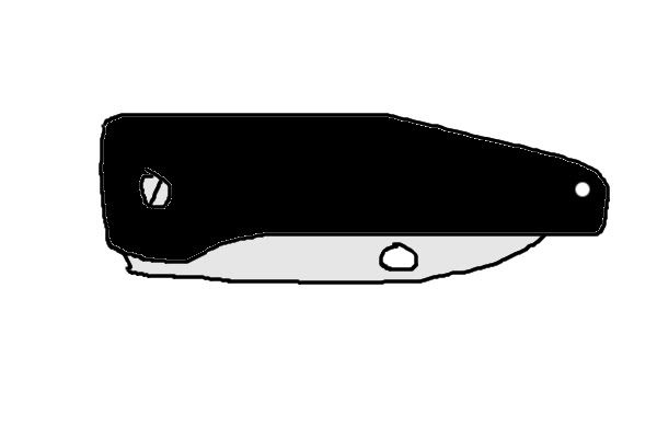

For a two-handed opening knife with a hole I would like such a design:
The hole would be at the right place to open the blade as easy as possible with two hands. To prevent dirt to be stuck in the hole, it just could be not a cut-out, but only a dent, which perhaps is etched to give an optical contrast to the rest of the blade...
mfg, stubenhocker
