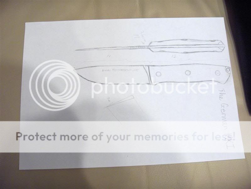

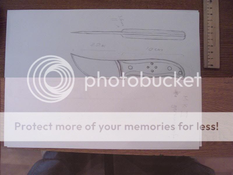

i kind of forgot about this thread,, but today i was reading it again , and trying to figure our what most of it said,, german you see is a language i cant realy speek,
so i drew two knives in the style i though you folk woudl like..
one is as the first knife that was preposed, like our gurza-2 ,, the other is like an allround knife as the germans like at the moment ,, but still i cant see anything german about them......
what do you guys think about these two??
sorry for the bad drawings and pictures, i just drew them up in about 2 minutes each......
i like your first drawing (the german mk I :lach: ) and the idea of using a simple convex ground carbon steel blade... in combination with the thin blade stock, it would make an awesome cutter ! i'd be in for some of these, if you decide on producing them.

I really like your first drawing. Carbon steel sounds very good, although I'd prefer a flat ground blade.
Nevertheless I think drawing #1 is the way to go. Maybe with some wood or micarta handles and a leather sheath.
Your first drawing looks appealing to me, too, but I would add a more substantial guard. Taking my moderate sharpening skills into acount, I'd also prefer a flat grind. Of course this is just a personal preference.

I'm more into the first drawing too. I like upswept-point-blades, but in my eyes the second knife is a little to upswept.
clean,straight lines, not a lot of spacers or different kinds of materials, I think a drop point with flat grind;certainly not the fanatasy style of Hibben nor the Tactical Strider and Company.In french I would say:bon genre, bon gout.Ein einfacher zeitloser slichten guten Geschmack.Der Othello Sting gefiel mir ganz gut,die erste Jagdmesser von Borger waren auch optische Klasse.The first knife would be OK with a simple round end of the grip but I like a guard in steel for the finishing touch.Achim Wirtz also makes "German knives": simple design, natural materials and a very high knowledge of his steel, the damascus.It's nice, its strong what do you need more.Ich meine damit: es gibt glücklich keine Einheitswurst mehr.
yeah the likele thing with eh up sweap blade was just for ELdirko...
yes the first one would actualy be the one i would take,
the lack of a large guard is bacuase of the russian law,, it isnt a weapon without a large guard,
i think most people have troublem with the convex grinds,, so id stick to a flat grind, as it sutes more folks,, maybe do the carbon ones with convex grinding and the stainless ones with flat grinding
