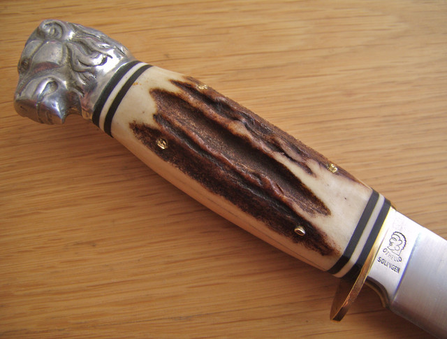

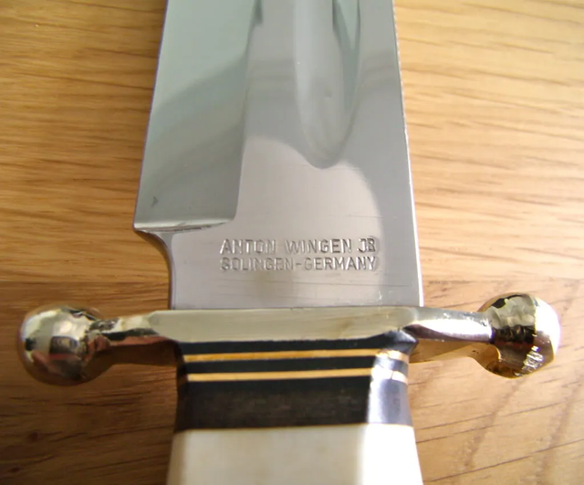

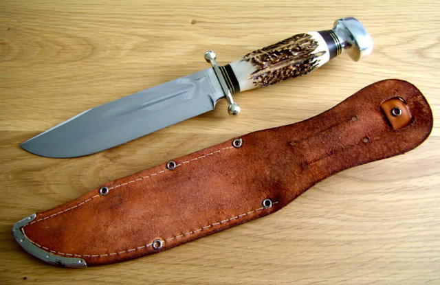

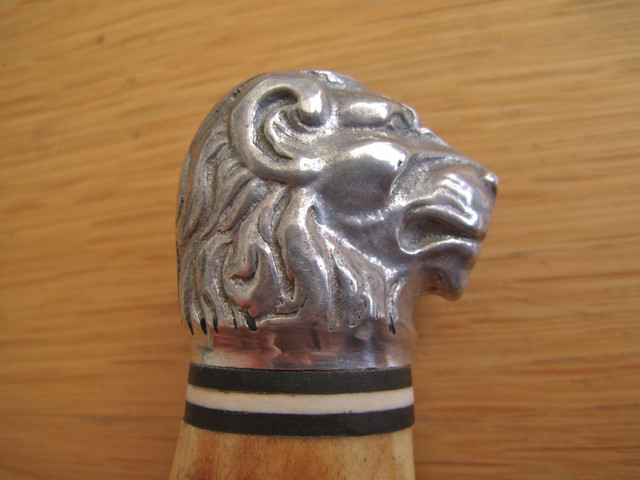

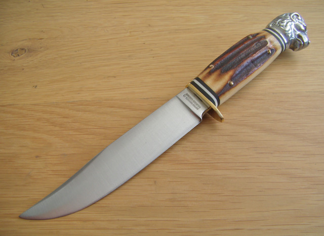

Das klassische Fahrtenmesser...

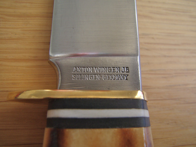

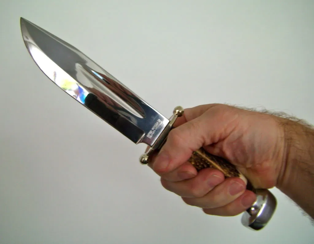

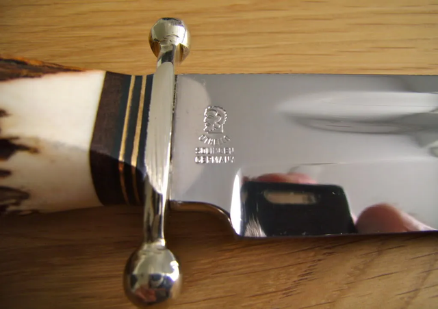

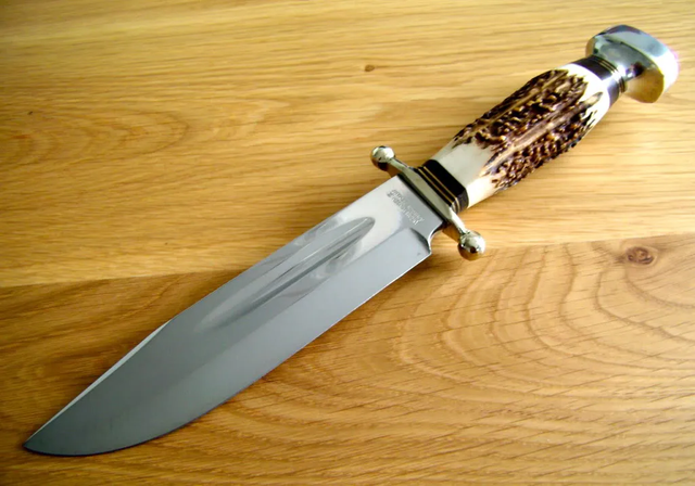

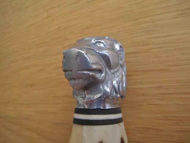

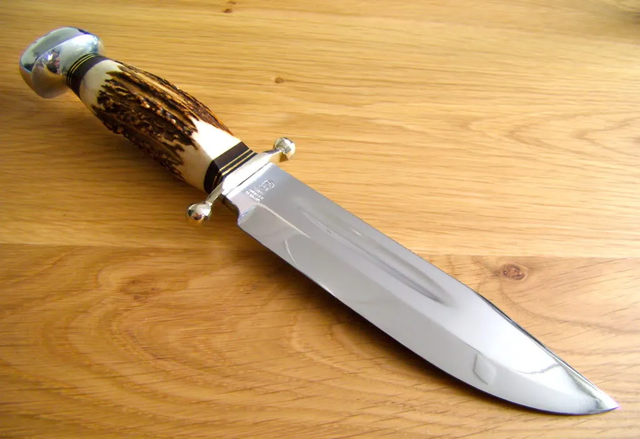

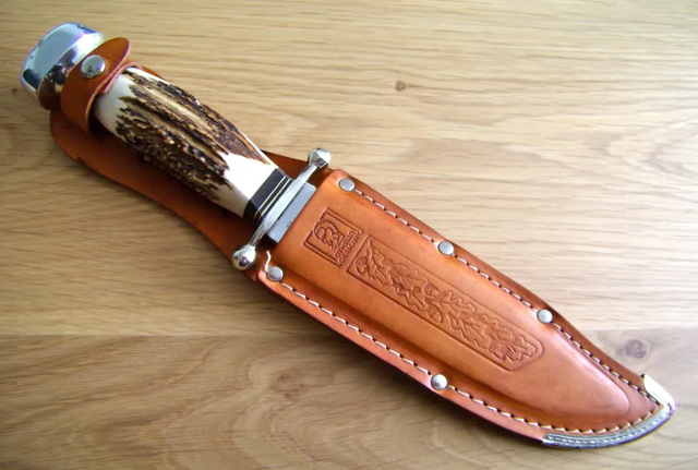

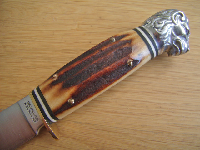

Anton Wingen / Othello Scoutknife from the late '60's early '70's, with a stag handle and a highly polished carbon steel blade.
It has a bit of light peppering near the point on one side, which doesn't show up in the pics.
The quality of these knives is imo comparable to Puma knives of the same era & style.
Specs:
Overall length: 28,0 cm
Blade length: 15,6 cm
Steel: polished carbon steel
Weight: 328 grams
Blade thickness: max 6,0 mm
Handle material: Stag with nickel silver guard and aluminium pommel
Made in Solingen, Germany

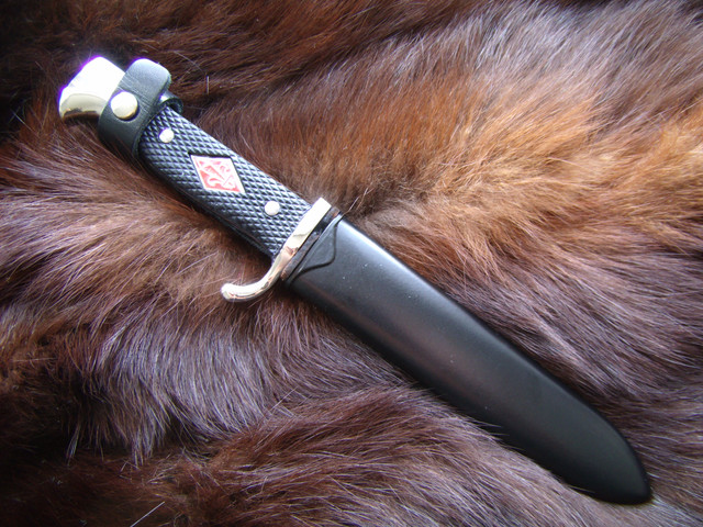

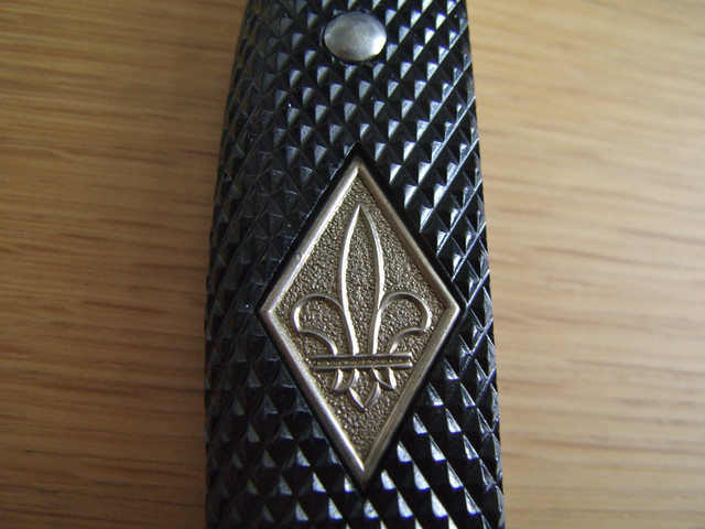

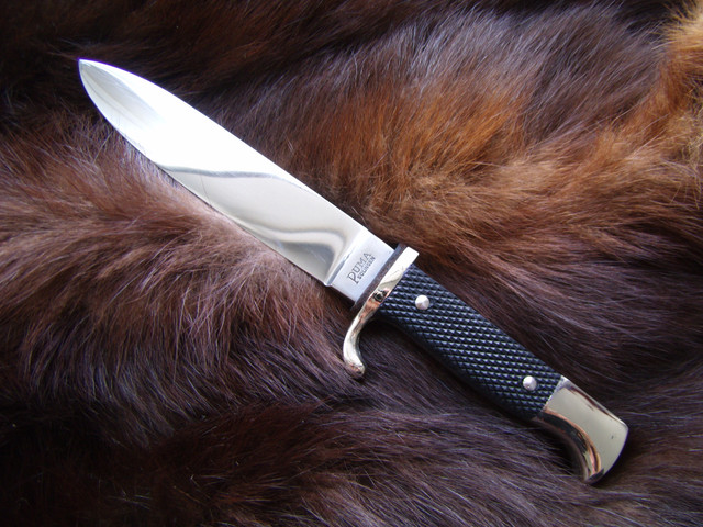

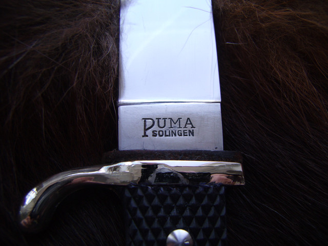

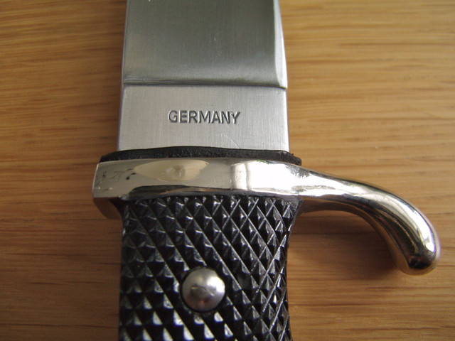

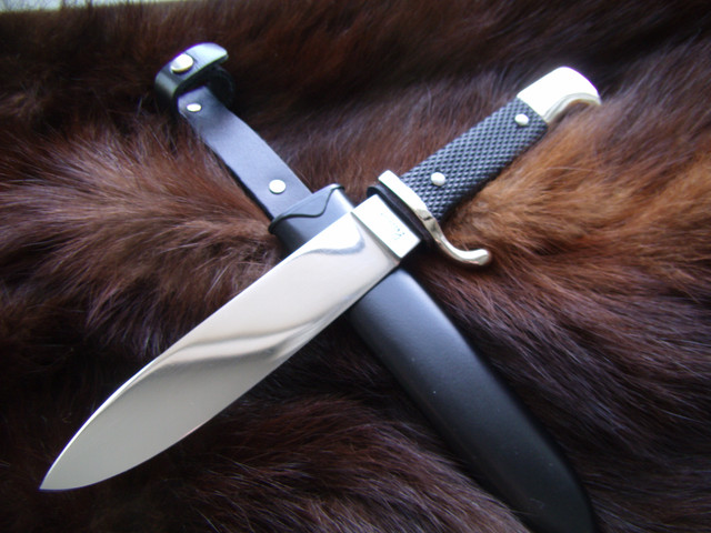

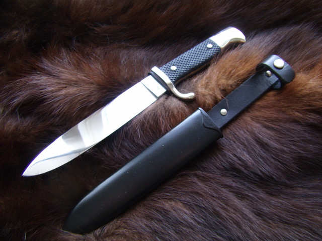

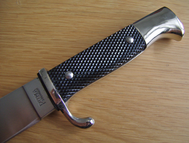

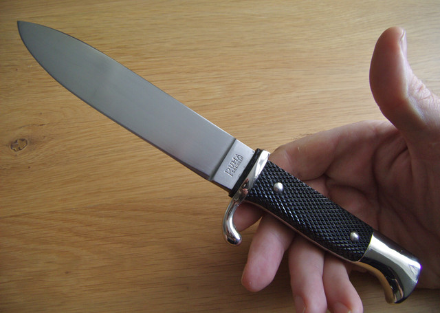

Vintage Puma Scout knife with carbon steel blade from the '50's or '60's, and apart from a few details comparable to the well known Hitler Youth knife.
Specs:
Overall length: 24,4 cm
Blade length: 13,9 cm
Blade thickness: max. 6,14 mm (ricasso)
Steel: hot drop-forged carbon steel
Hardness: 60+ HRC (estimate based on sharpening)
Handle material: Chromed metal with riveted Bakelite grips & Fleur de Lis emblem
Sheath: metal with 2 steel clamp springs inside & a leather belt loop
Weight of the knife without sheath: 213 grams
Weight of the knife with sheath: 287 grams

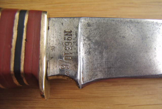

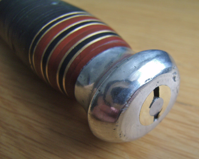

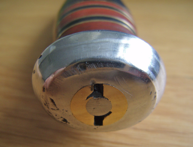

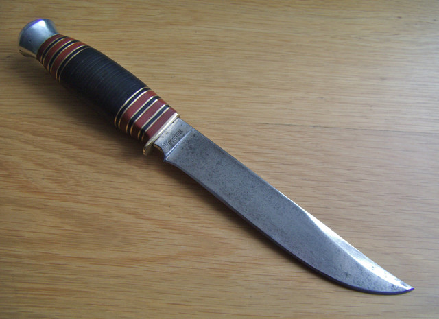

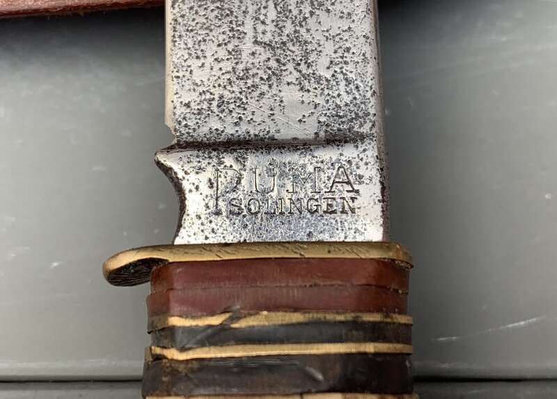

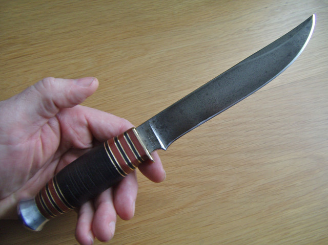

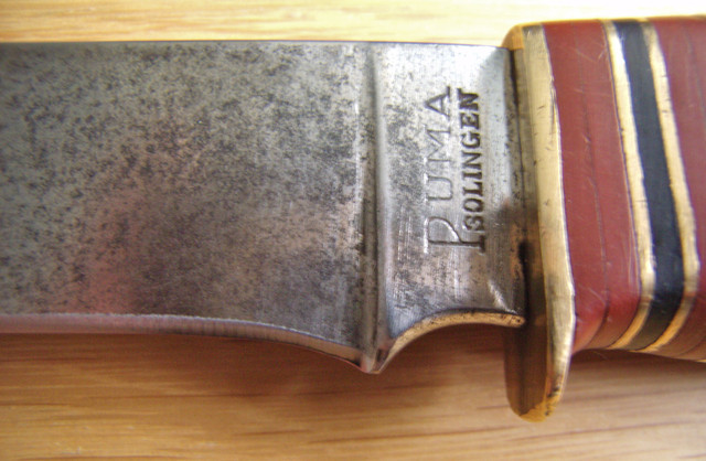

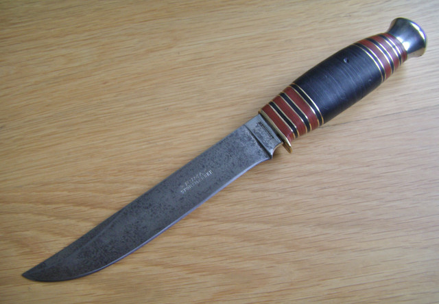

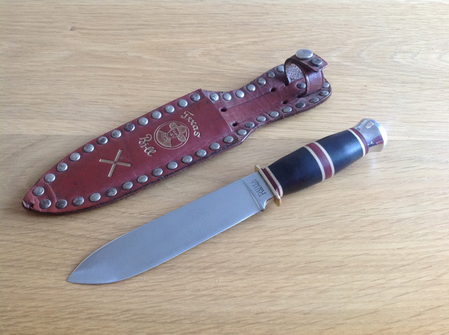

Vintage Puma 6310 Sportmesser (sporting knife) from around 1940.
Although the model number is in the 1940 Puma catalogue, it shows only the 4.5 " version, not this 6" bladed version.
Specs:
Overall length: 25,7 cm
Blade length: 15,2 cm
Max. blade thickness: 4,51 mm (ricasso)
Handle material: leather and brass washers + guard & aluminum pommel
Without a sheath.

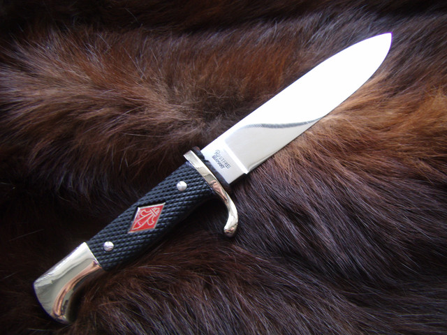

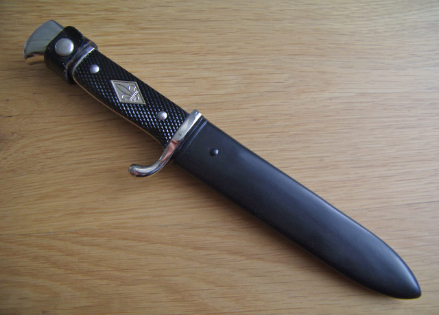

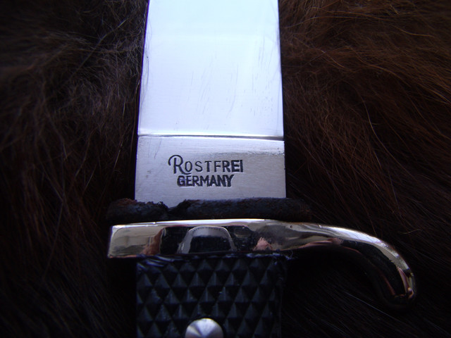

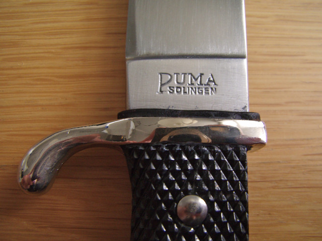

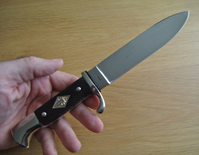

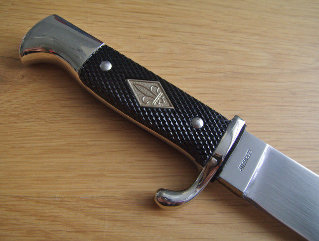

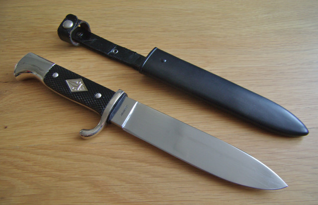

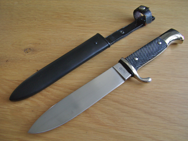

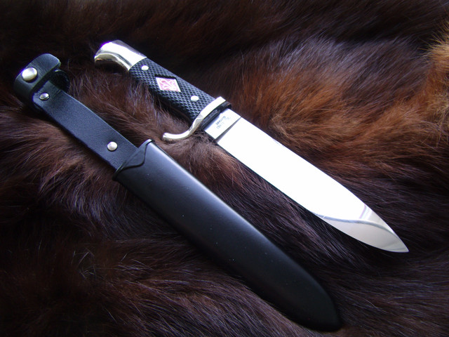

Vintage Puma Scout knife with stainless blade, probably from the '60's or '70's, and apart from a few details comparable to the well known Hitler Youth knife.
Hitler's home (scale model): Berghof Obersalzberg (https://www.berghof-obersalzberg.de/index.htm)
Specs:
Blade thickness: max. 5.97 mm (ricasso)
Steel: hot drop-forged stainless steel
Handle material: Chromed metal with riveted plastic grips & Fleur de Lis emblem
Sheath: metal with 1 steel clamp spring inside & leather belt loop
Weight of the knife without sheath: 199 grams
Weight of the knife with sheath: 280 grams

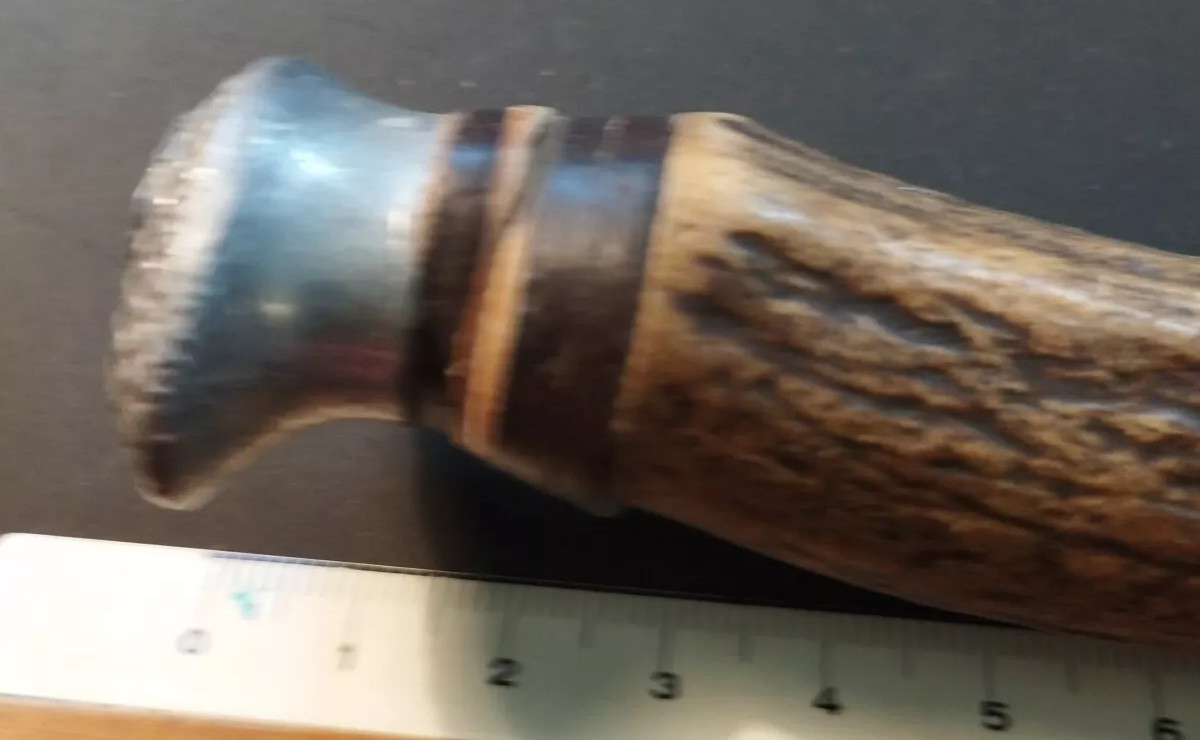

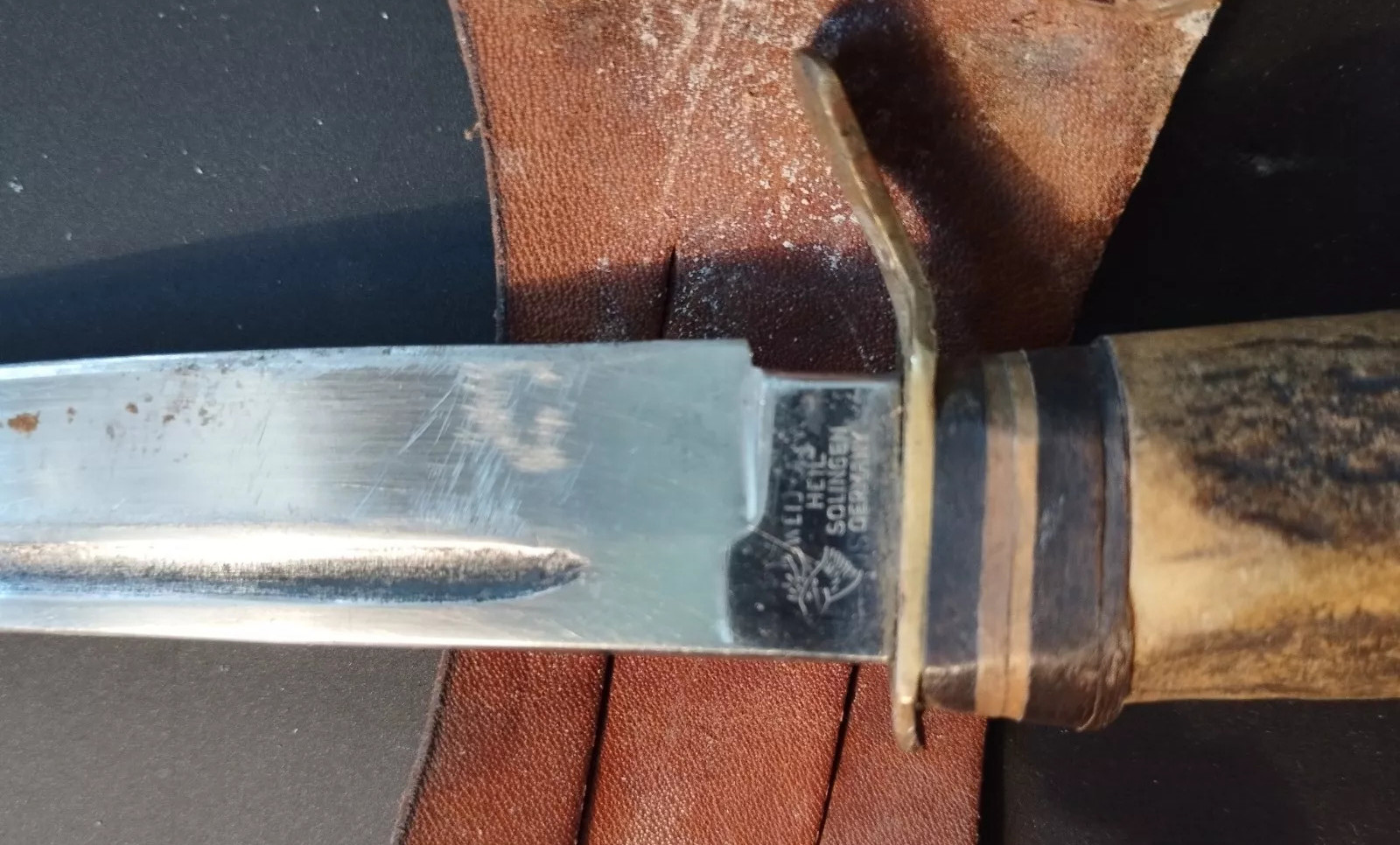

Vor kurzem konnte ich für wenig Geld dieses schöne Solinger Weidmannsheil Fahrtenmesser erstehen.
Der Ausgangzustand war leider nicht so toll.
Entschuldigt bitte die schlechten Bilder. Die sind nicht von mir.
Der Griff war nicht mehr fest, das Horn versifft, sowie die ledernen Zwischenringe spröde und hinüber.
Die Klinge war total verschliffen und zerkratzt, die Spitze stumpf. Auch die Nähte der Lederscheide waren kaputt.
Also alles mal komplett zerlegt und neu aufgebaut.
Die Klinge habe ich ausgedünnt und ein neues Finish angelegt.
Nach der Generalüberholung wird sich ein guter Freund hoffentlich über sein neues "Outdoormesser" inkl. der originalen Scheide freuen.
Vielleicht behalte ich es aber auch selbst. :love:

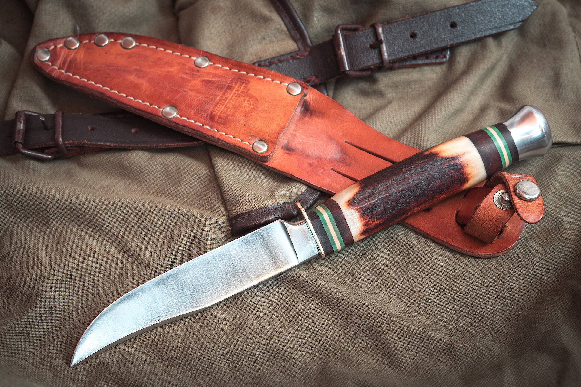

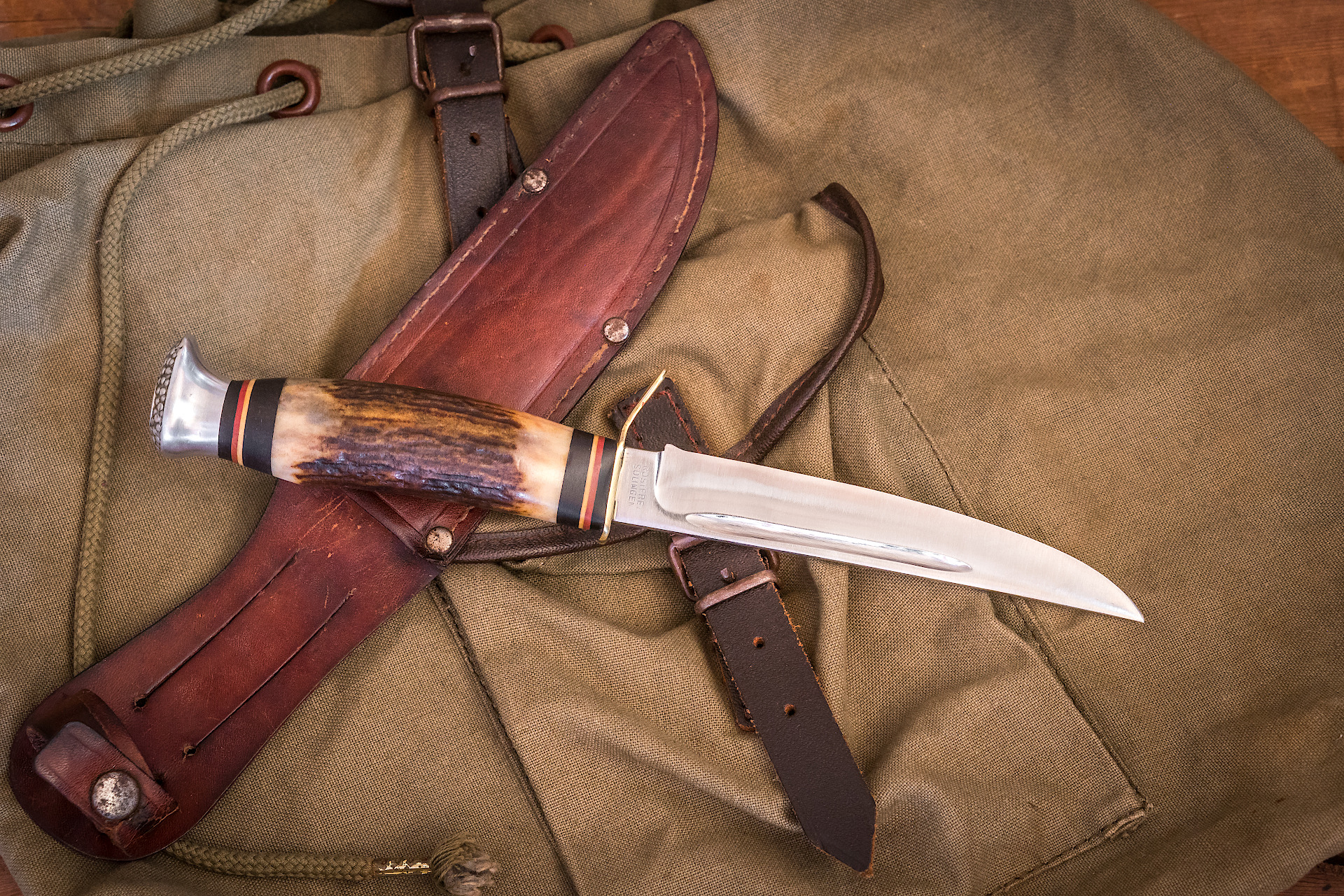

Hier mal wieder ein schönes, klassisches Fahrtenmesser aus Solinger Produktion von Hubertus.
Ich konnte es gebraucht für kleines Geld erstehen.
Der Ausgangszustand war allerdings optisch nicht so toll.
Nach der Auffrischung ist es wieder ein echter Hingucker, wie ich finde, und bereit für die nächste Runde im Wald. :love:
Da die Klinge ziemlich zerkratzt war, habe ich ein neues Finish angelegt. Natürlich musste das Messer auch wieder ordentlich scharf gemacht werden.
Glücklicherweise war die Schneide noch nicht verschliffen und ohne Materialabtrag.
Der Griff (Horn und Zwischenringe) wurde ebenfalls gereinigt geglättet und geölt.
Der Knauf und die Parierstange wurden auch wieder auf Hochglanz poliert.
Die Scheide musste lediglich etwas geölt werden und ist nun wieder super geschmeidig.

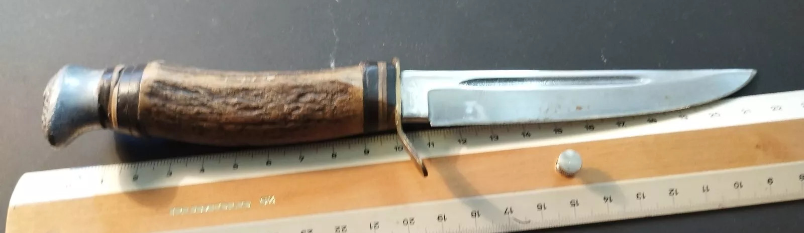

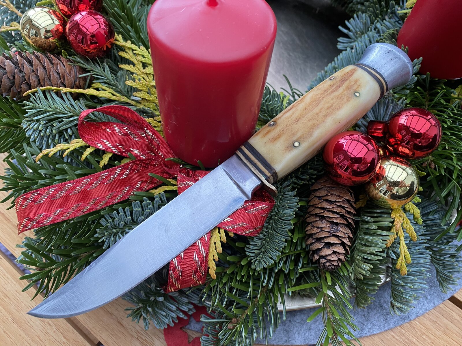

Gestern kam auch bei mir mal wieder was aus der Solinger 11cm Liga bei mir an
Ich mag diese genieteten Hirschhorngriffe. Griff musste ich auseinanderbauen und neu verschrauben.
Der Zustand der Klinge ist mäßig und total verschliffen, da musste ich echt die Wasserstein Scheppach anwerfen.
Hat aber jetzt klaglos 2000m Paracord in 10 m Stücke geschnitten😀
Ein schöner Hingucker, dein Solinger. Hast du toll wieder hinbekommen.
Und auch sehr schön fotografisch in Szene gesetzt. :love:

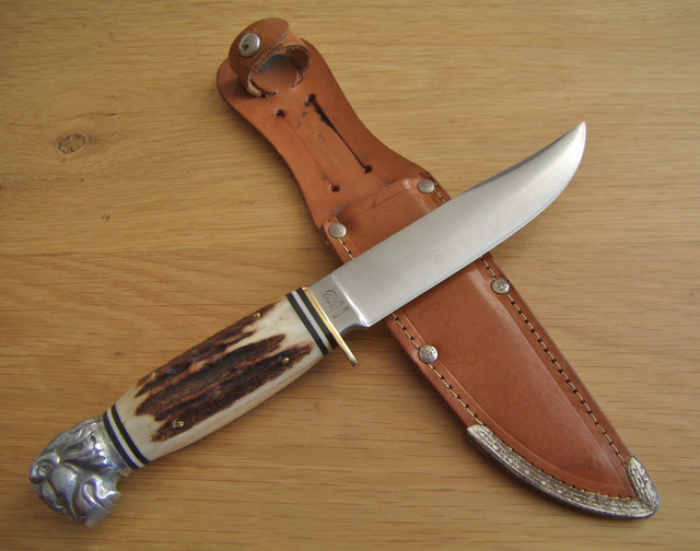

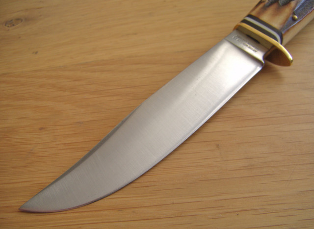

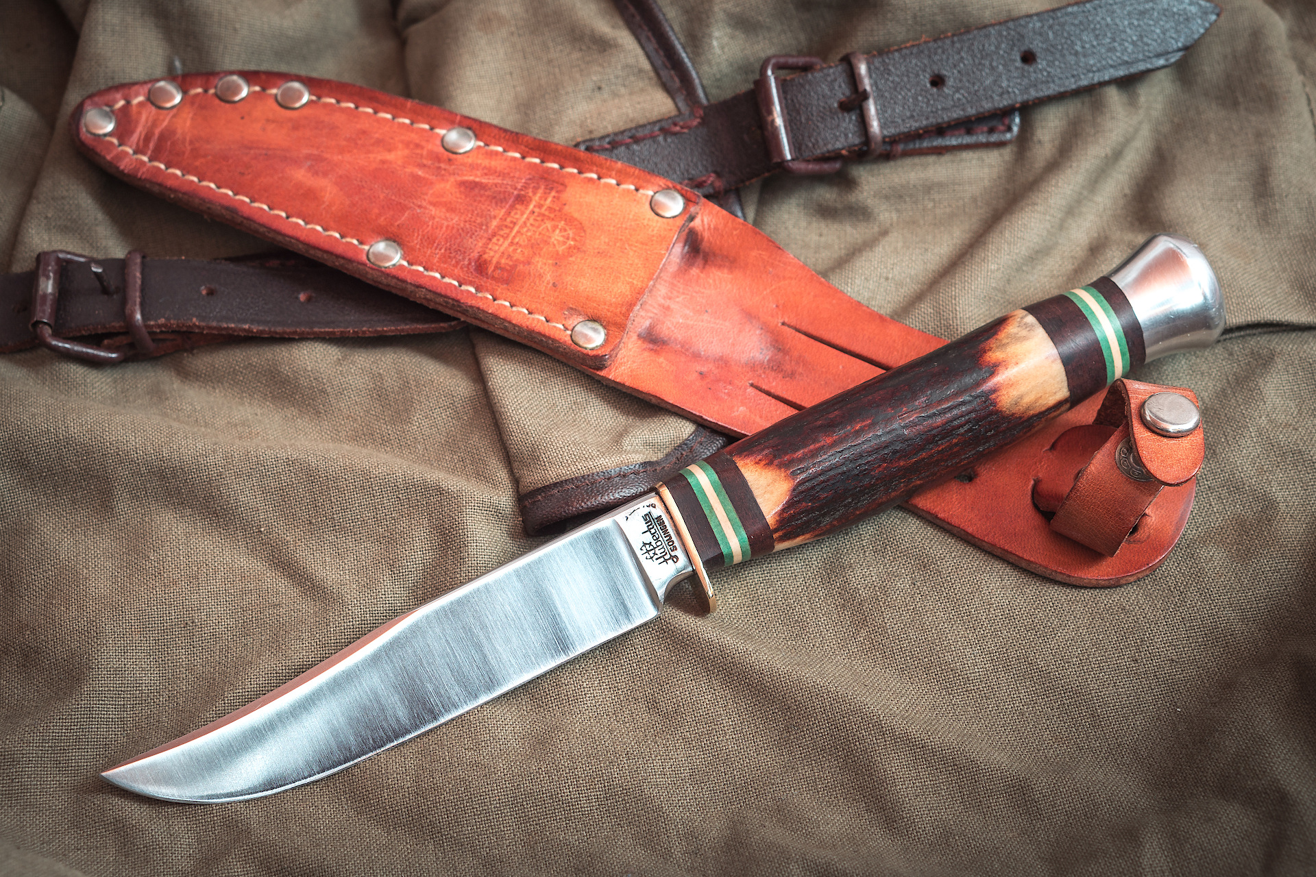

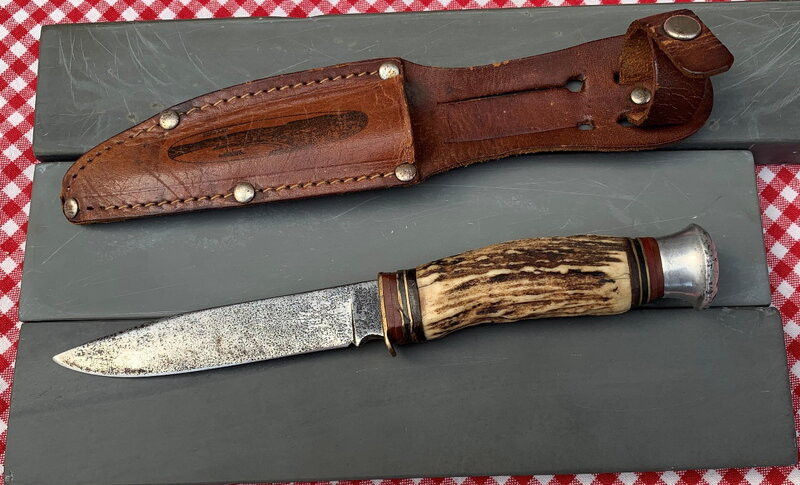

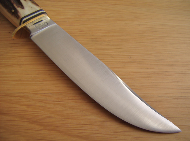

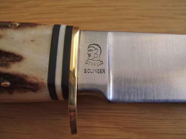

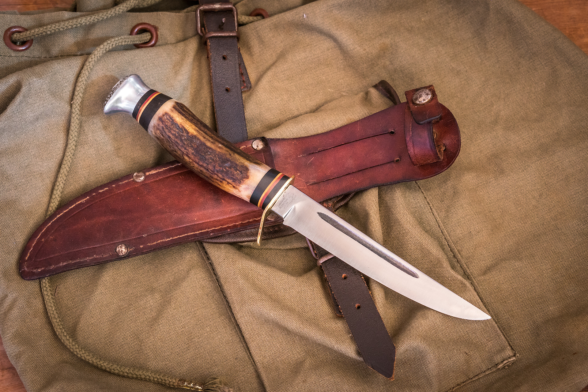

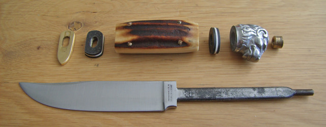

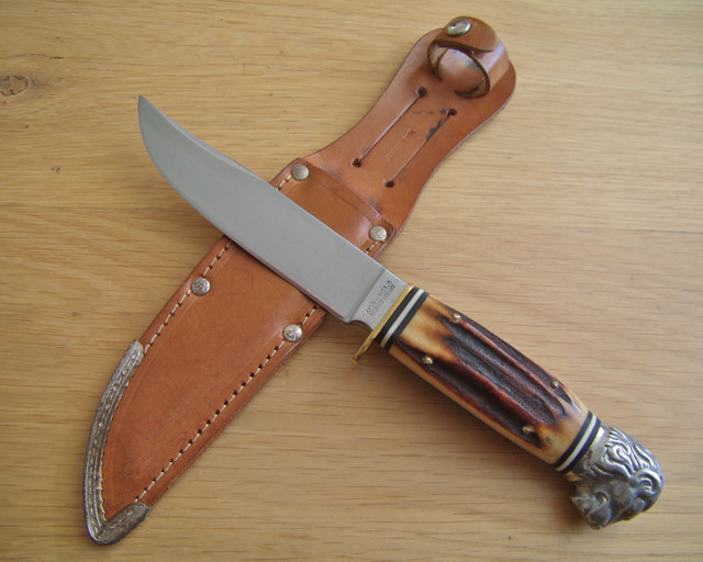

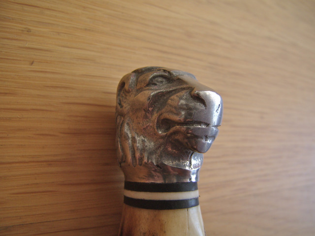

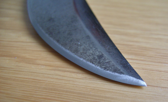

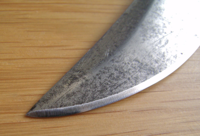

This knife was bought by a Dutch man in the late '50's or early 60's as a souvenir, and from what i learned from his daughter is that it spent the rest of it's days forgotten in a drawer inside it's sheath.
When i bought it the blade was quite pitted and almost black from all those years inside it's leather sheath, and it still had it's factory "edge" of about 60-65 degrees inclusive.
I chose to regrind the blade by hand to a very shallow full convex zero edge with an apex that fits the 25 degrees inclusive slot on my Tormek WM200 angle guide, using only a new sheet of 400 grit wet & dry and WD40 as a lubricant on a rubber backing.
This removed most of the blackened pitting & solved the edge problem in one go.
Also glued the fiber washers together and sanded them flush again (some had expanded somewhat over the years), and polished the brass guard a bit.
Specs:
Post-war model, probably made in the late 1940's or during the 1950's
Overall length: 8.54 inch (21.7 cm)
Blade length: 4.57 inch (11.6 cm)
Max. blade thickness (ricasso): 4.8 mm
Handle material: stag, fiber washers, brass guard & aluminium pommel.
Sheath: leather

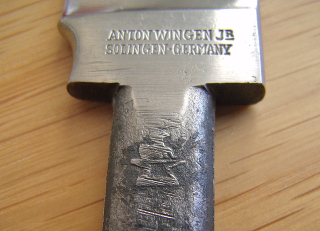

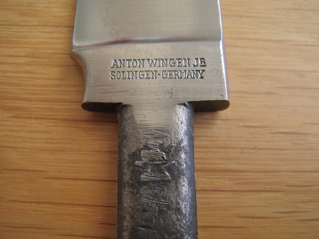

After disassembling the knife i discovered a tang stamp of an anvil with (possibly) a hand holding a hammer.
Now as you know these blades were hot drop forged, and Anton WIngen Jr. seems to have had it's own forge up until the 1980's, but maybe this one was done by drop-forging specialist Felix, also in Solingen.
Would have to contact them to find out, as they are still in business.

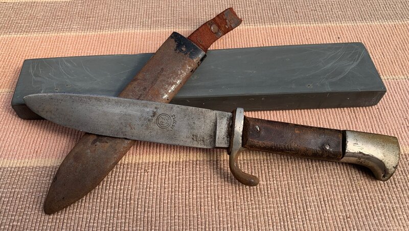

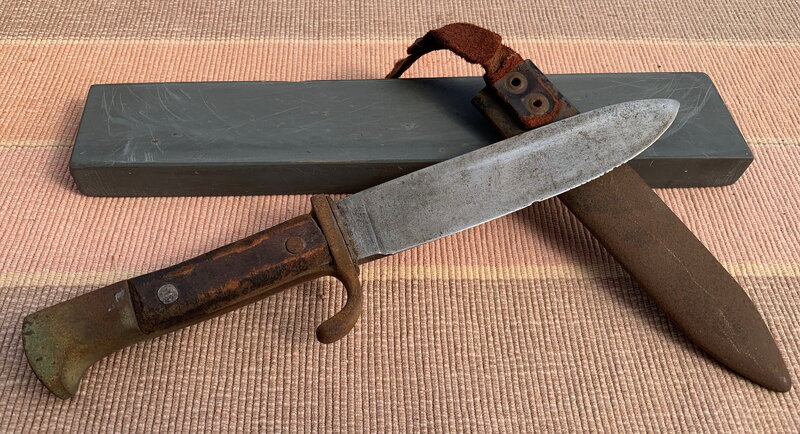

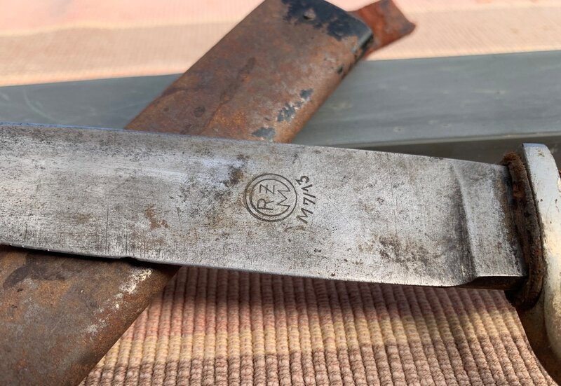

Altes klassisches Solinger Fahrtenmesser mit RZM Zeichen.
Die Orginalschalen sind gegen Lederstücke ausgetauscht worden
(hat mein Sohnemann beim Abriss eines alten Dachstuhles gefunden).
M7 = Dienstdolsch - Fahrtenmesserhersteller
13 = Artur Schüttelhöfer & Co., Solingen Wald

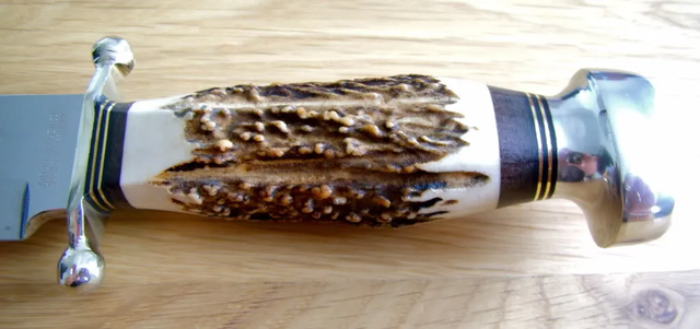

Mein kürzlich aufgearbeitetes Fahrtenmesser aus dem Omegawerk will ich euch mal schnell zeigen.
Es kam leider mit arg verunstalteter Klinge zu mir.
Diese wurde jahrelang ungleichmäßig geschliffen.
Der obere Bereich der Schneide zur Spitze hin wies einiges an Abtrag auf.
Zum Ricasso hin war aber fast nichts an Materialverlust zu verzeichnen.
Hier hat der Vorbesitzer den Ausgangszustand dokumentiert.
Die Klingengeometrie musste ich daher im Bereich der Schneide neu formen.
Das war unabdingbar, um überhaupt erst mal eine saubere und gerade Schneidphase erzeugen zu können.
Als das erledigt war, habe ich die Klinge noch ausgedünnt, da ich an der Schneide zuvor einiges an Material abgenommen hatte.
Am Griff musste ich zum Glück weniger machen, ihn lediglich reinigen und aufpolieren.
Das Hirschhorn bei diesem Messer finde ich besonders schön strukturiert.
Und das Messer liegt auch echt fein in der Hand, aufgrund des leicht bauchigen Horns.
Ein satiniertes Querfinish lässt die Klinge nun auch wieder ordentlich aussehen.
